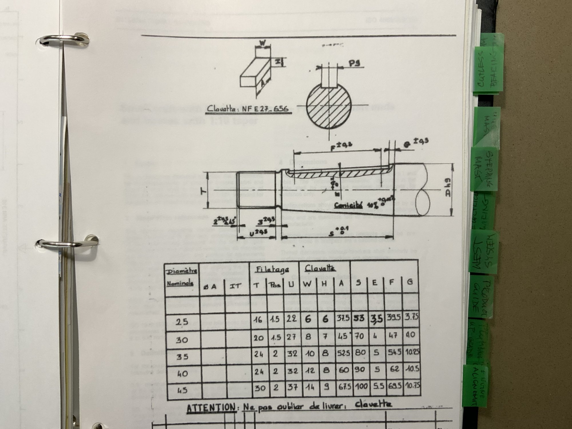

Rudi, you asked for shaft specification for Beneteau Oceanis 43. Please measure shaft diameter on your boat with a calliper. If dia is 30mm than taper of the shaft is 1:10, thread M20x1.5, keyway depth 4mm and required key 8x7mm. The key must be fitted to shaft/prop during installation (to adjust for keyway depth tolerances and keyway machining method).
I’m enclosing copy of original Beneteau drawing for the shaft taper. For 30mm shaft it shows keyway depth 4mm and length 47mm.
If your shaft diameter is 25mm, be aware that Beneteau (and some other EU boats and shaft manufacturers) are deviating from ISO standards for 25mm shaft in dimensions for keyway; they adopted 6mm keyway rather than ISO 8mm. For example, Beneteau US was selling for 25mm shaft with 6mm keyway, a fixed 3 blade propeller made by Vetus with 8mm keyway. Specially machined 8mm/6mm Width Key was required.
Good luck with a new prop.

Thanks a lot for all the details. I have got the confirmation of Autoprop that it is a 30mm ISO shaft, so a standard Prop will fit. I am already in contact with Vetus in Denmark, so delivery can be within 3-4 days :) Tomorrow the boat will be lifted.
