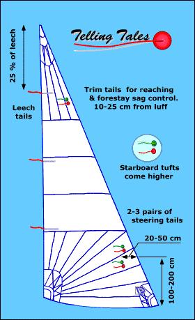

Don's Sail Trim Guide will provide the basic tell tale placement and usage. Dont leave the dock without this 'guide'. Available here at SBO: http://shop.sailboatowners.com/prod.php?51998/Sail Trim Users Guide
Once you master 'the basics' of Don's schema, here's a modernization of the usage of tell tales: http://www.arvelgentry.com/Telling_tales.htm
The section on STEERING by tell tales is on page 2 .... that 'chart' is attached below. Also shown in 'photo #2' in http://www.arvelgentry.com/magaz/Checking_Trim_on_the_Wind.pdf
To make the 'steering' tell tales more effective, apply a 'series' of short 4" long tells on each side of the jib about 4-5ft. up from the tack and all in a single horizontal row starting from the luff and running back towards the leech for about 3-4 feet. Once you get all the other tell tales to be near perfectly flowing 'straight back', then simply use the steering tell tales for precise steering.
