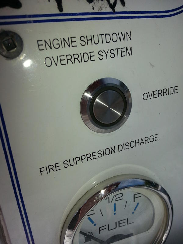

I have a 2013 Hunter e-33 with a 29hp Yanmar. The control panel buttons keep failing. I/O, start, override etc. Does anyone know where I can purchase spare buttons? Wrote hunter factory numerous times and no response. Thanks.

The panel was fabricated for Hunter by Ultra Panel Marine in Florida @ 305-888-7709 - upm01@netrox.com . It is purchased under Marlow-Hunter part number 1036516.
As you can see from the attached photo the Start and Stop button are different from the original. My dealer replaced the origianls shortly after I took delivery of the e33.
Thank you. Just for clarification is ""upm01@netrox.com"" the site for the original buttons or the ones that your dealer changed for you? If these are the original ones can you supply me with your dealers number so I can get the updated ones instead please.
