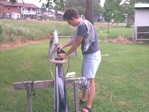

Redid this mast in 2003, using Zinc Chromate and a 2 part polyurethane paint. Still going strong
Pic is my ex buffing it out
