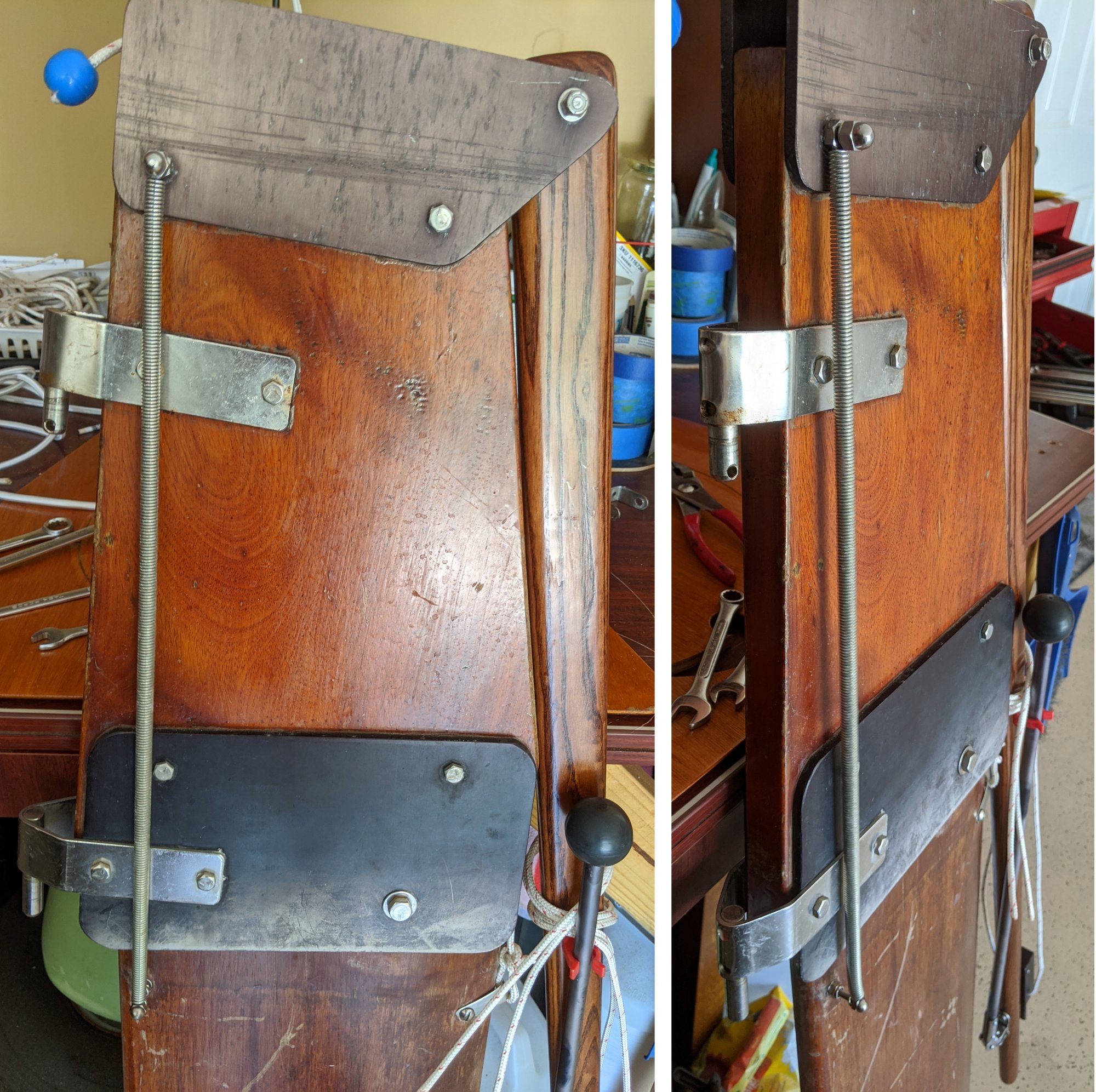

Vandestadt & McGruer Ltd. Siren 17 Choctawhatchee Bay
I didn't like the uphaul/downhaul line on my Siren 17 rudder, so I modified it with a spring. I got the idea from a catamaran. Now the rudder stays down, but can easily give way if it hits anything.
