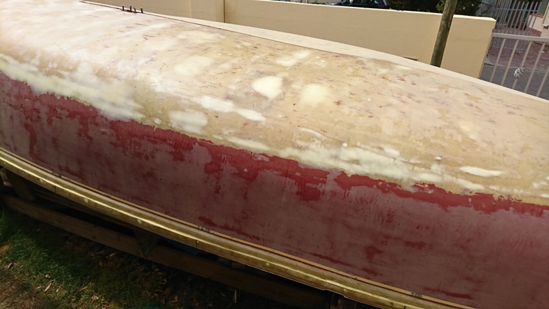

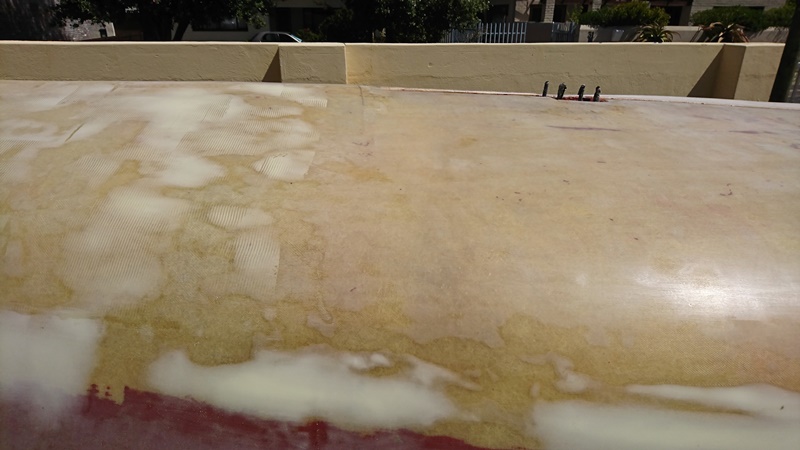

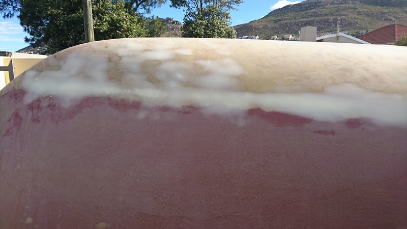

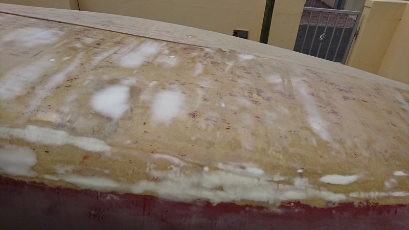

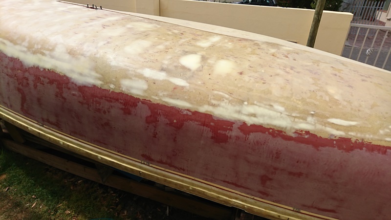

This was round two on the water line as well as trying to tackle the troughs in the below waterline area at the bow. Will slowly make my way aft filling the voids as best i can. The boat will never be as new shape from the mould unfortunately.

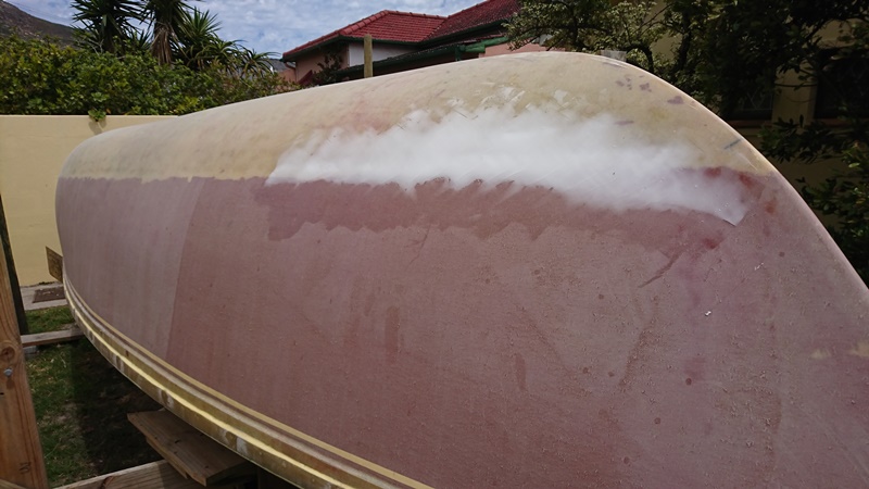

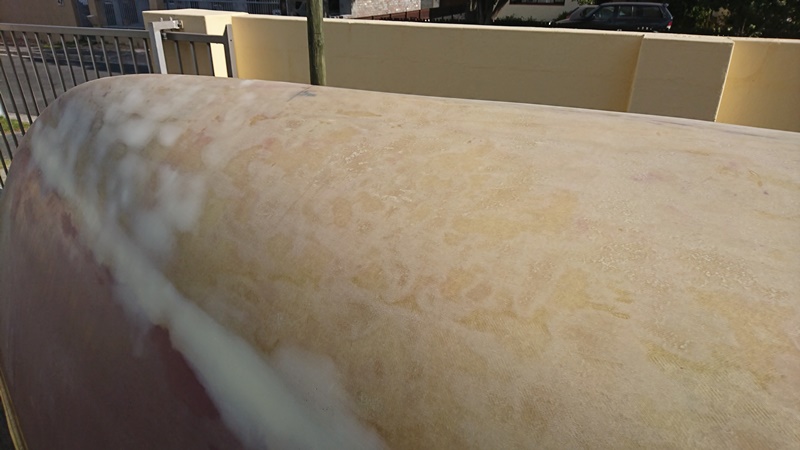

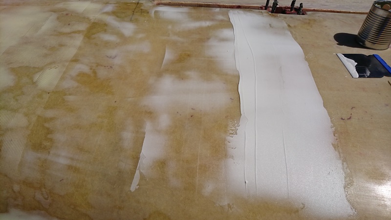

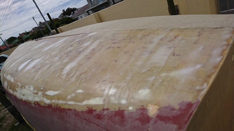

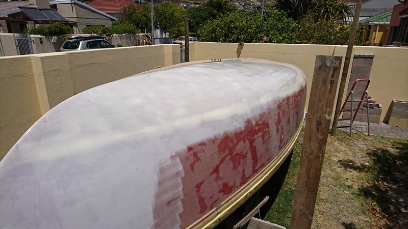

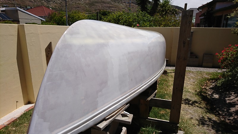

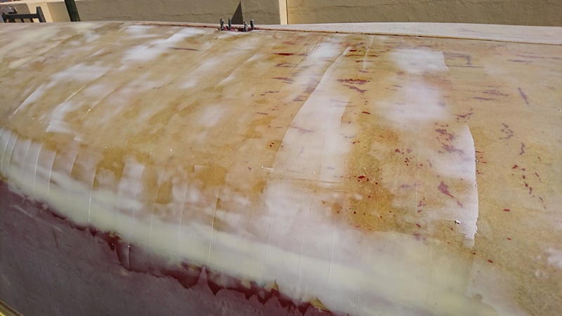

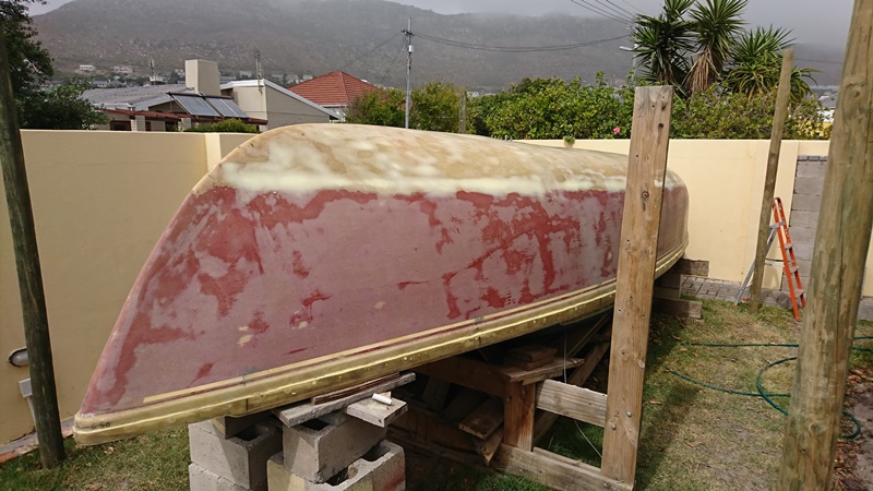

Ok... so finally the wind calmed down enough to make a start using the new plan. Using 80 grit I long board sanded the entire starboard side of the hull from the waterline to the keel line following only the length of the boat. Then washed it all down. This took a couple of hours after work yesterday evening. In the pictures you can see clearly the valleys and the hills.
The valleys are the darker mottled areas while the hills are the lighter areas. The much whiter areas forward and along the waterline are whats been faired already and in my opinion completed! Time to move on...

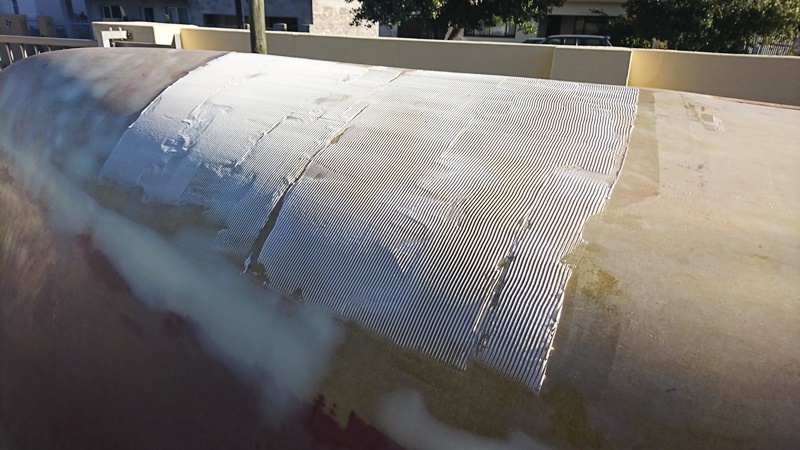

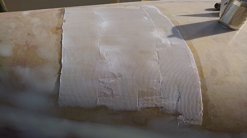

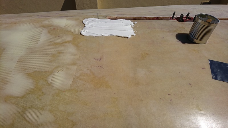

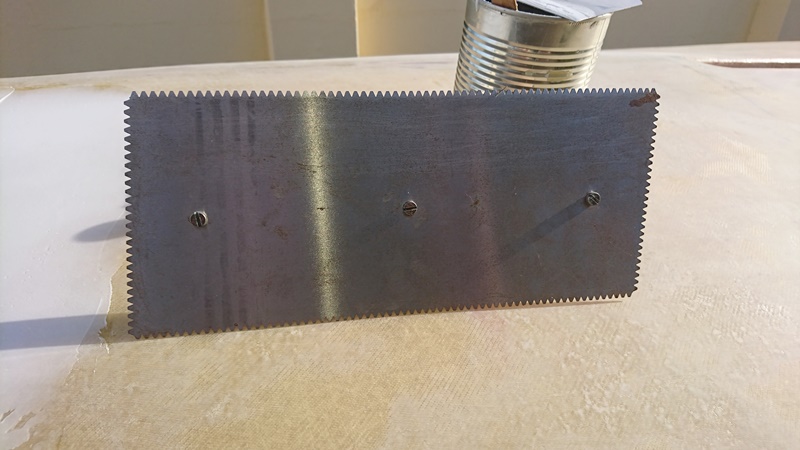

This is the glue spreading trowel used for laying down carpet or vinyl flooring. Never used it before!
The idea is to lay down a thin smooth layer and then scrape it down with this trowel leaving behind ridges to sand off.

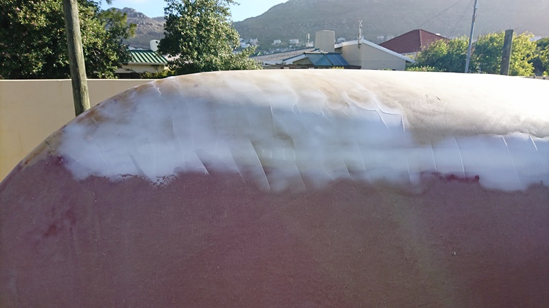

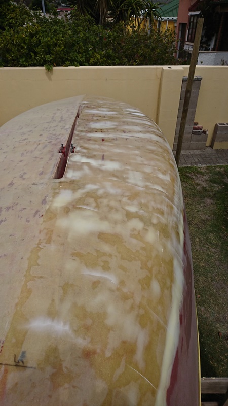

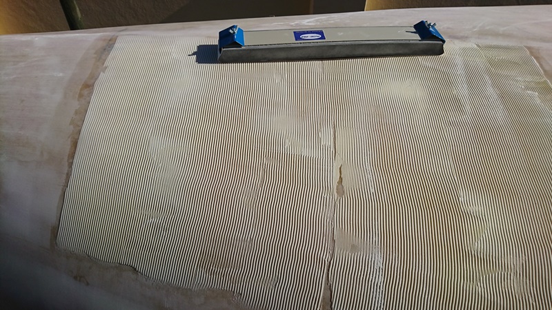

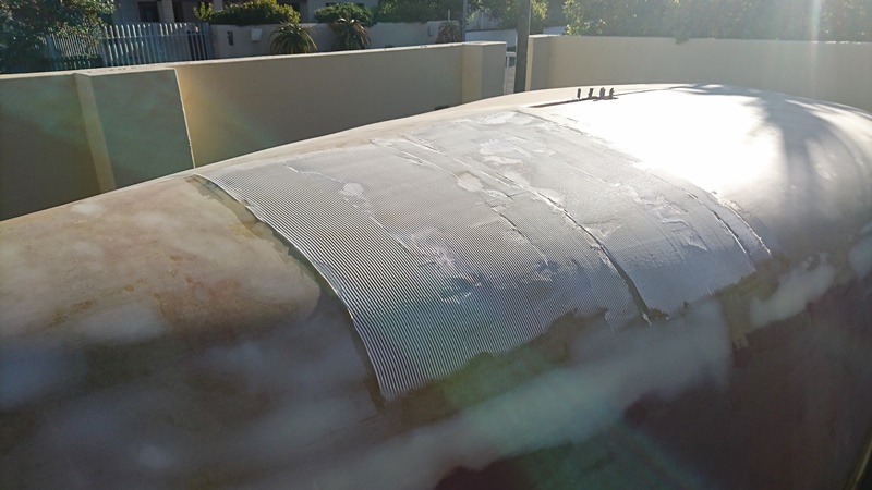

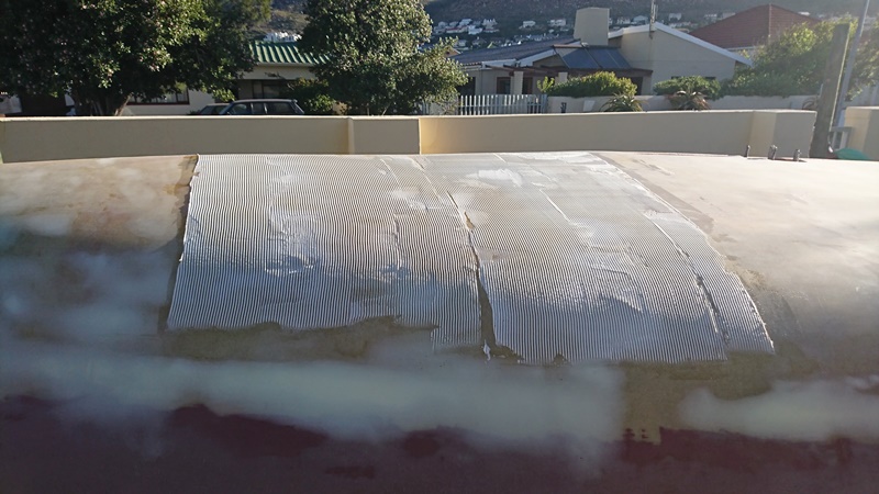

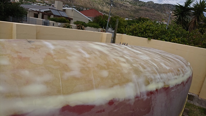

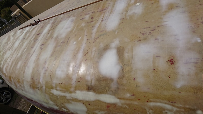

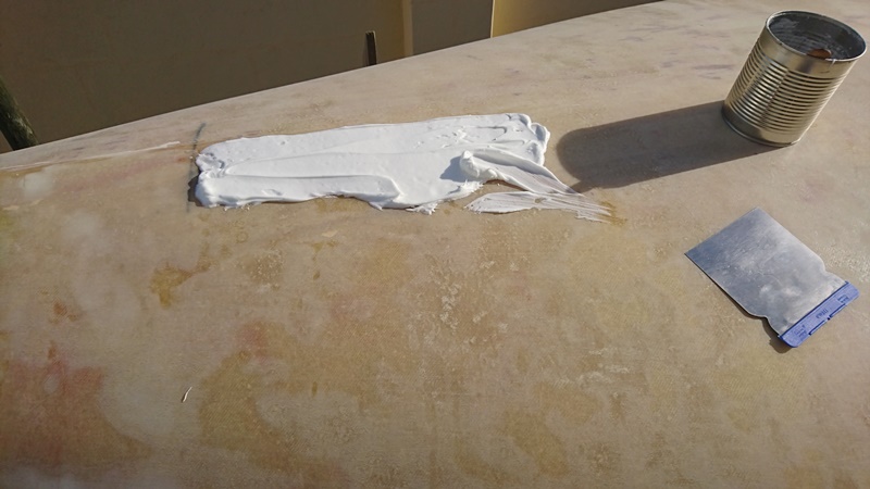

After smoothing on a thin layer of fairing compound it was time to try the serrated edge trowel. First go was not so successful, scraped it all off and redid the thin layer. Reason being the tight radius cross wise and the curve of the hull lengthwise. Had to learn to concentrate on keeping the trowel parallel with the curve along the length of the hull while dragging it straight down the radius of the curve. Turned out ok for my first try.
You can clearly see ridges where the fairing compound was left behind, valleys where the hull is visible on high spots and a couple of areas where no ridges are which shows really low spots. Used slow hardener so I had time to play around and cater for mistakes/trial and error!

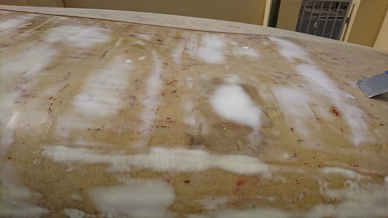

Ok - feedback time.
IMHO = It is my honest opinion that this idea of using a serrated trowel and building up fairing compound using ridges and troughs would be great for changing the contours of the surface... NOT for filling low spots.
Why do I say this from my experience? I spent more time sanding down unwanted ridges. During this time I did see that you have a lot of possibility for shaping a new curve or contour because of the height of the ridges. But sanding ridges away where you actually don't want them is not only a waste of time and effort but also a waste of materials. I even resorted to using my belt sander to get rid of the most of the unwanted ridges.
I could far more quickly use a wide flat edge trowel to scrape away the excess on the high spots of the hull and leave only materials behind in the low spots. Lot less material waste, lot less time sanding. Even if I had to do this several times to build up to a flatter surface it would work out much easier to do.
Again my opinion and also why I was hesitant to try it in the first place.
Now to file off the serrations along the one long edge of my trowel!

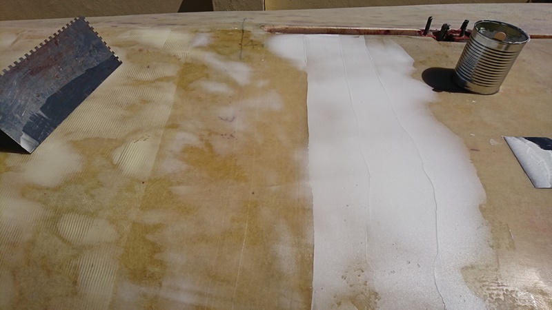

I did exactly that... except here in SA we have a "Builders Warehouse". I purchase a trowel that you describe exactly. I also used it exactly the way you described.
Not only was I able to fill voids more easily, there was also way less wastage. In fact I used only 200g of fairing compound to complete the whole remaining starboard side = about 4m length. And all I did was exactly what I wanted to do = fill the valleys. Not reshape the hull.
The previous section I tried with the serrated trowel leaving ridges took 200g of materials and barely made it half a meter length of the boat.
Picture will follow soon...

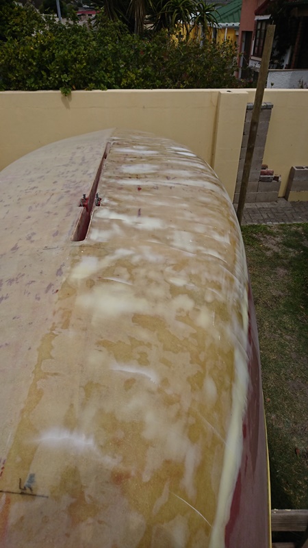

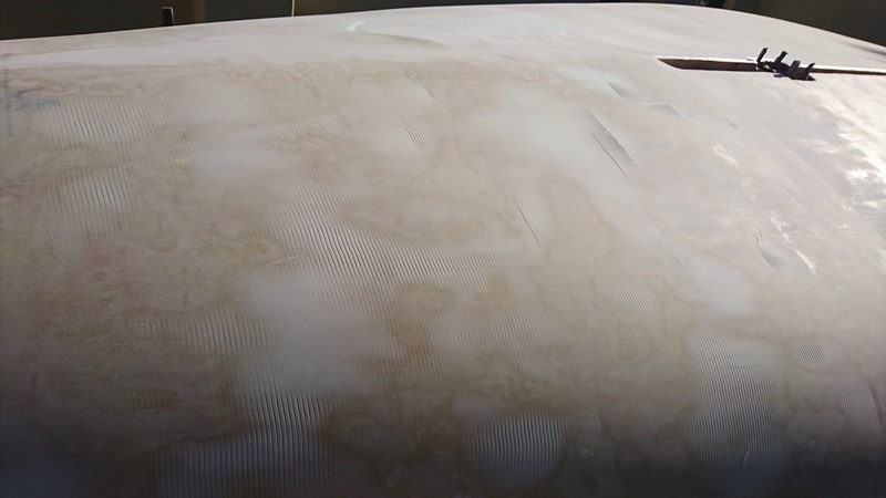

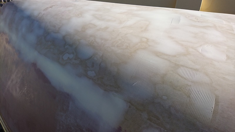

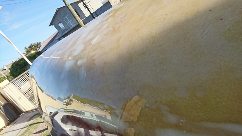

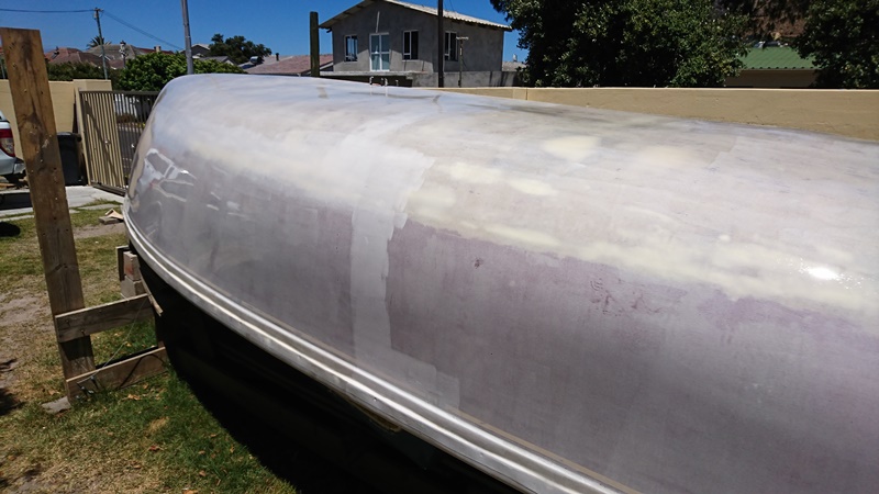

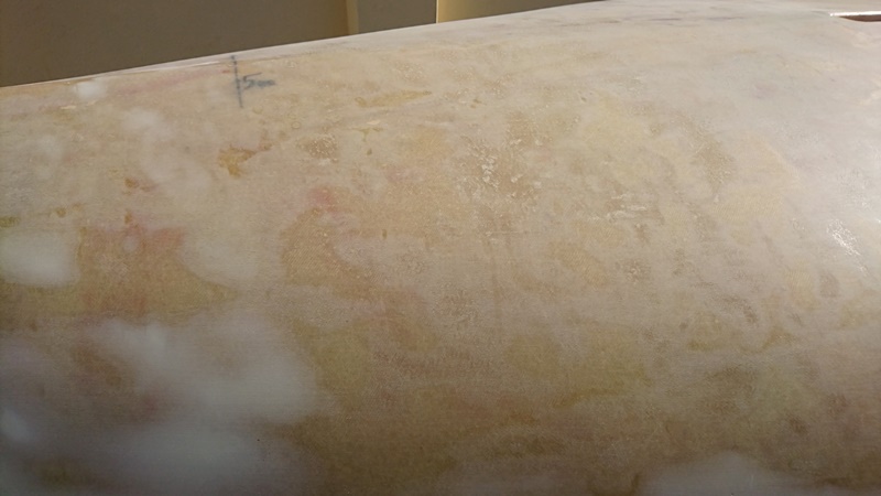

After the sanding down of the ridges I decided to wash down the hull and scope out the shape and fairness while it was all glossy wet. I must say to me you can clearly see the difference between the faired parts and the unfaired parts of the hull. It looks way better than I expected of my own efforts. Unfortunately the camera does not really bring out the true details but here's the best of the shots I took anyways.

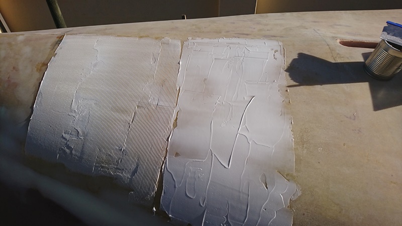

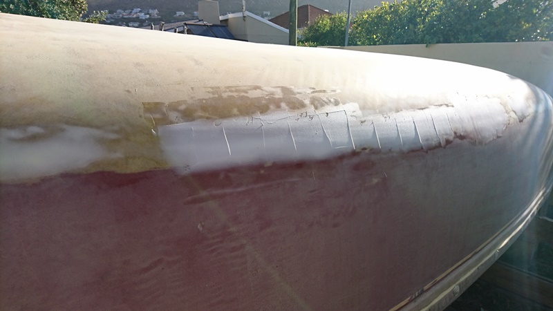

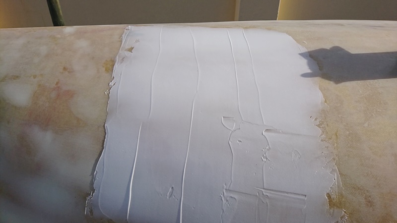

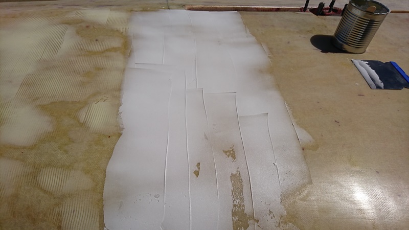

Ok - so the promised pictures. I started applying the fairing compound next to the section where the ridges were. Just to see if the new plan would prove any better. I think so! Check it out...
The new section is given a light sanding to remove any crap from wind debris, washed down and then cleaned with Acetone.

Then next morning I decided I liked the results so prepped the remainder of the starboard side and applied fairing compound in the same way. It got a bit tricky in areas where there were multiple curves which look flat from one direction but completely hilly from another direction. The boat will never be perfect but all I am aiming for is to fill the voids as best as I can.
Photo 126 and 129 shows this very well. The trailer must have put a hole through the hull at some stage. This was then clearly repaired on the trailer so although the hull has a convex curve the repair is concave = a big ding in the hull! The compound must be all of 1cm thick just to make it flat never mind bring it up to match the hull curve. So it will stay a bit flat in that area but looks a shiteload better than not fairing it out!
Used the leftover compound to even start the port side waterline area!

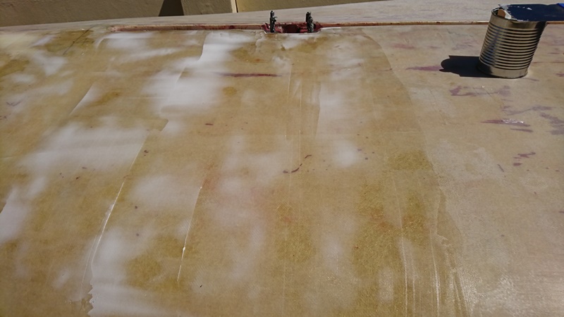

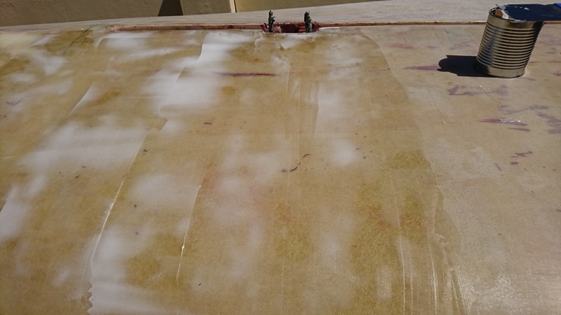

So last time I added pictures was discussing the fairing of the hull and needed to put an anti-UV type coating on the hull as the sun is really beating up the exposed epoxy I have used to sheath the hull with. I decided to tackle the starboard side first as this is the side that sees the sun mostly.
After the fairing was completed I approached the epoxy resin supplier to discuss my epoxy degrading UV issues. He suggested coating the boat with a type of epoxy used to make surf boards. It is supplied clear, has anti-UV agents and finishes off to a nice smooth glossy surface. I bought some of the resin and some white pigment to add white colour to the coating.
After waiting for a wind free day (it's been howling a nasty South Easter up to 40 knots mostly the past couple of weeks - they had to close the railways station because the beachsand has covered the tracks as well as built up in mounds on the roads!) I washed down the hull to get the sea grime off, sanded for goodness knows how long to get the degraded epoxy off then washed again then wiped down with acetone to prep the surface. I then mixed up batches of epoxy and white pigment and painted the starboard side. I got one layer down and then the weather turned windy again... so you see one layer only so it's thin however I'm extremely impressed with how nicely it comes out and how smooth it gets. Applied using the roll and tip method.
A couple of before pictures and then after. I was working in the heat of the day so I was working against the clock. Not the neatest job but very satisfying to see good results anyways :)

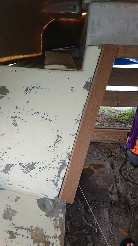

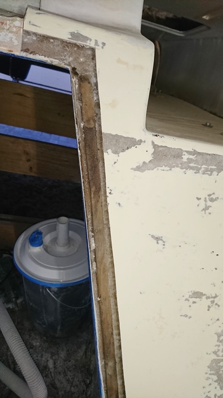

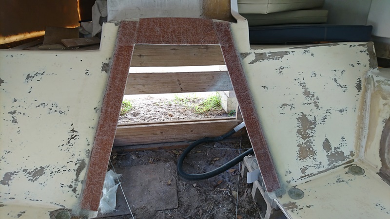

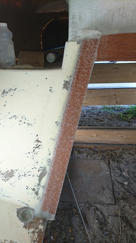

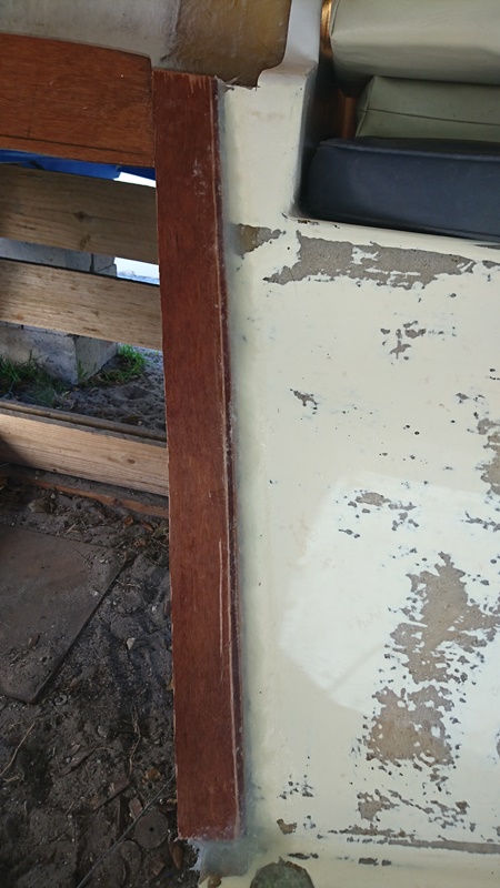

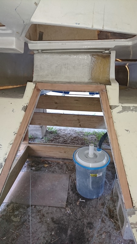

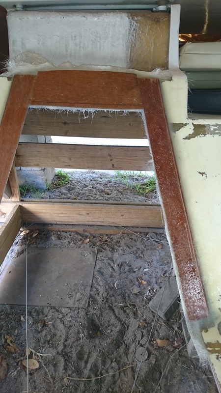

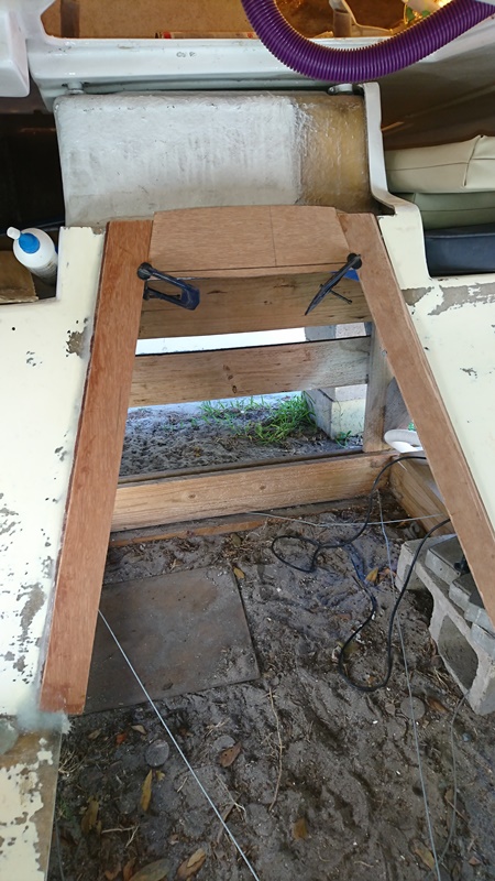

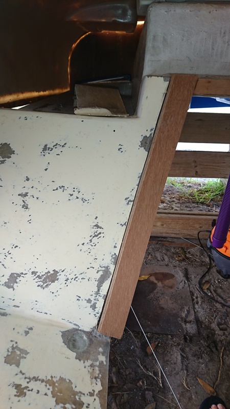

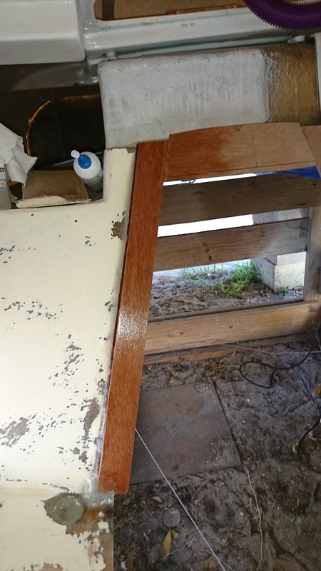

The companion way frame update:
So I wanted to install a new frame as the old one was rotted and puny to say the least. I made the choice that as the wood was rotten and the teak was severely beaten up/not restorable I was going to go with fiber glassing in all the wood I installed. I also wanted more of a "lip" around the entrance way to support the wash boards as well as be a more substantial water trap so to say. After fitting the solid wooden frame I then glued wide strips of 6mm waterproof ply wood to the frame. I then filleted in all the corners with the "peanut butter" mix to soften corners and edges. I then covered everything with CSM glass mat to add strength and seal the wood!
This job actually started in November 2017!
