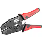

I have been using a rachet crimp tool on all types of terminals. Just a part of the project rebuilding the electrical systems in my boat.
One similar to this

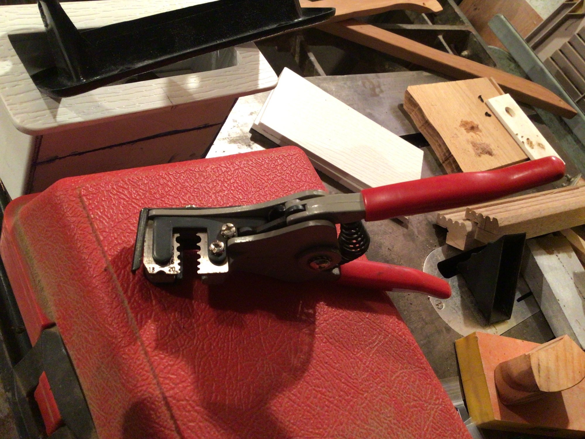

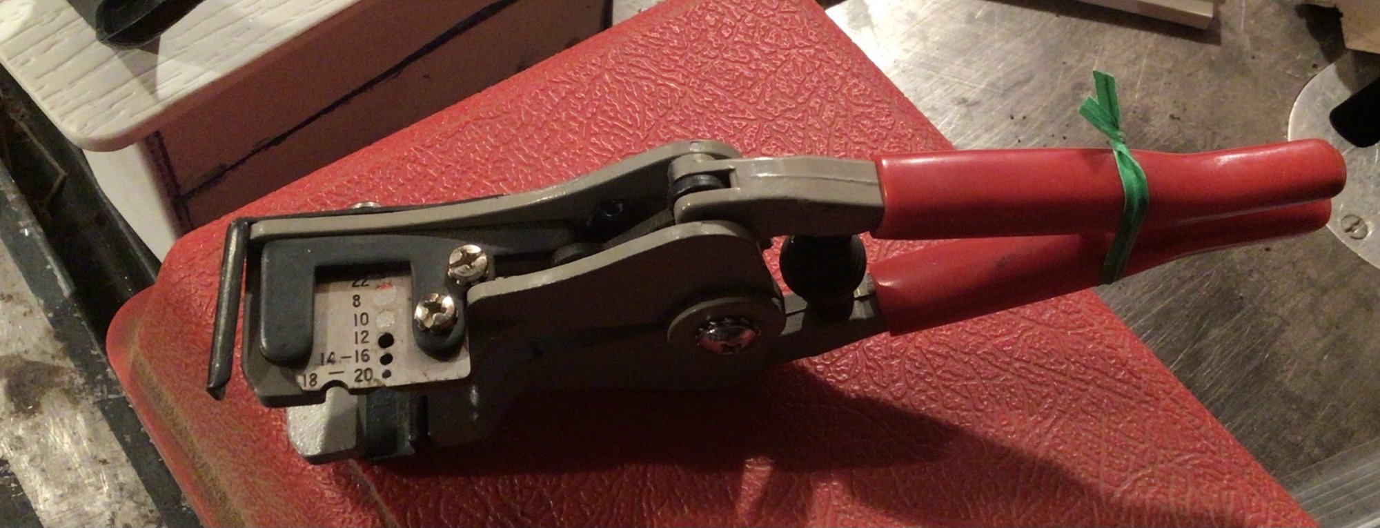

You’ll need better tools. Here are 2 you should have in your tool box for this project. You just can’t crimp heat shrink terminals with a pair of pliers. Just won’t work.
1. Definitely…..
Crimp heat shrink terminals using this part of the tool (Red Arrow)
2. Real Handy to have, is a spring loaded wire stripping tool. It strips the wire to the proper length needed, neat and clean.
Both available at a Lowes, Home Depot, Ace Hardware.
Fortunately this site will guide you through what you need to learn for your boat. Tools, techniques, tips etc.
One similar to this
I have one similar, good quality crimper with smooth dies specifically for heatshrink terminals. Problem is many heatshrink terminals are flared right up to the barrel that needs to be crimped. My crimpers are slightly to fat and makes it hard to line up properly unless in the most ideal conditions. Tired of missing a crimp, upside down in some tight spot with not much extra wire to spare. I'd rather just buy non-heatshrink terminals than go through the process of finding another crimper that workss better. Thank you though. I used to be able to get FTZ terminals in bulk but seems cant get them anymore from my previous FTZ pusher. Havn't found a new source yet.

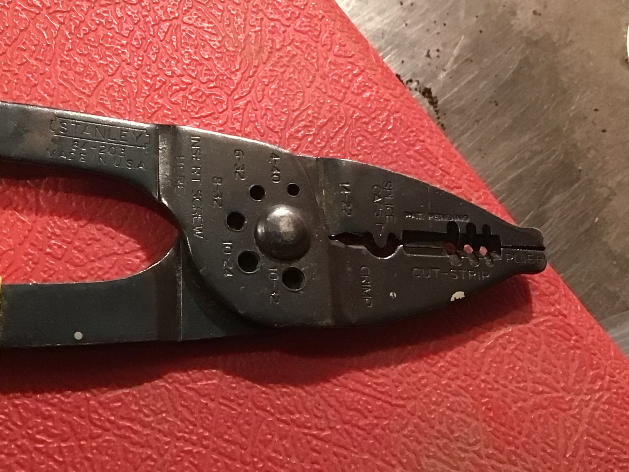

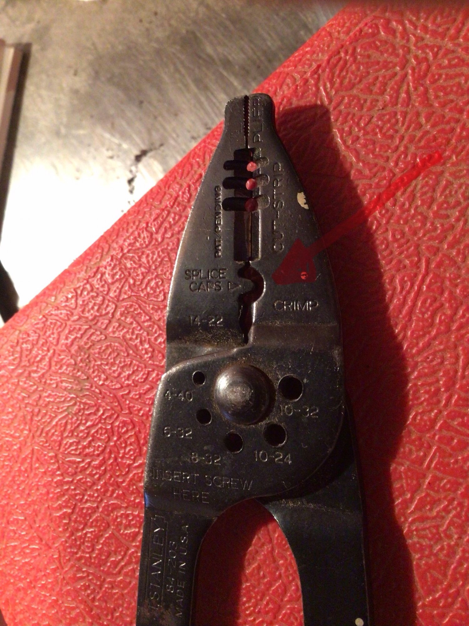

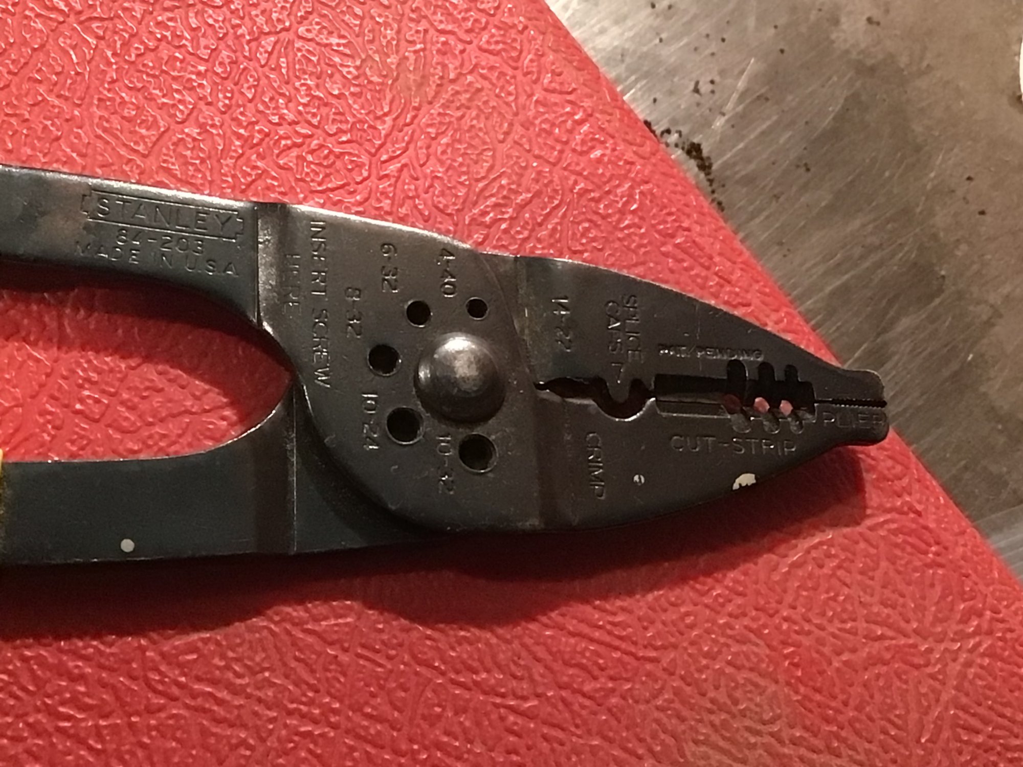

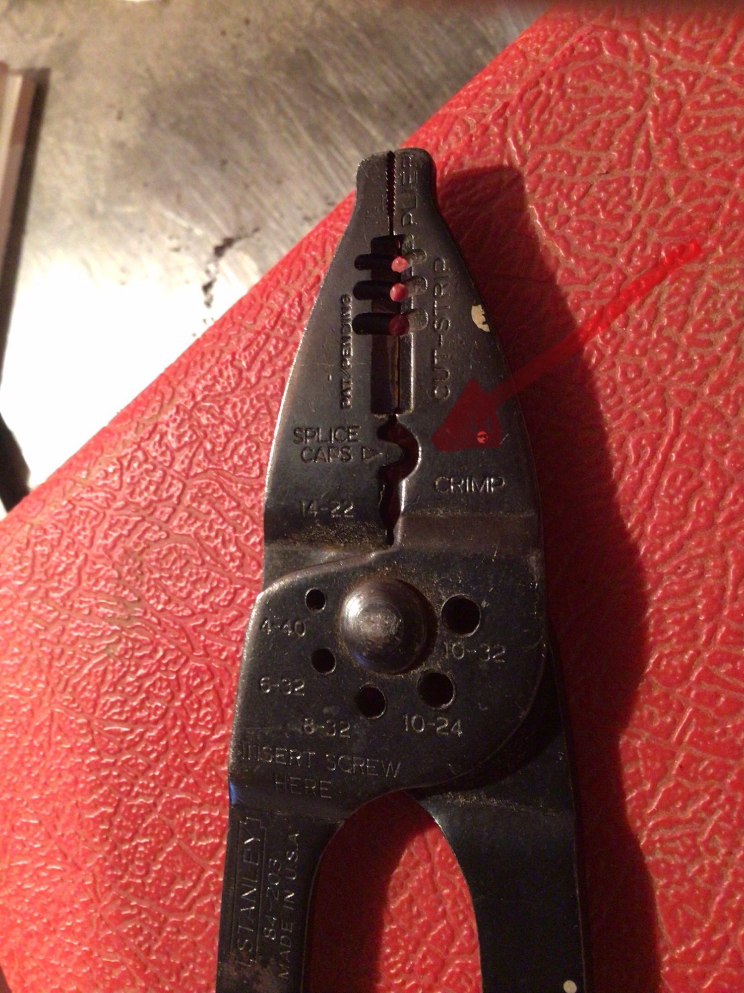

1. Definitely…..View attachment 230335View attachment 230335View attachment 230337

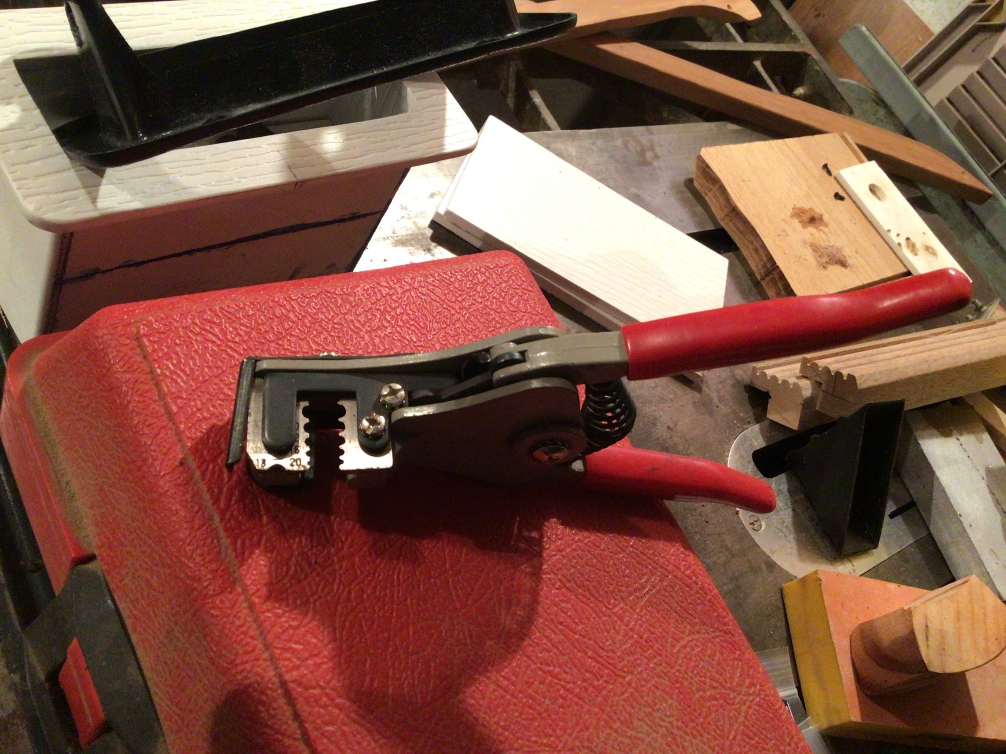

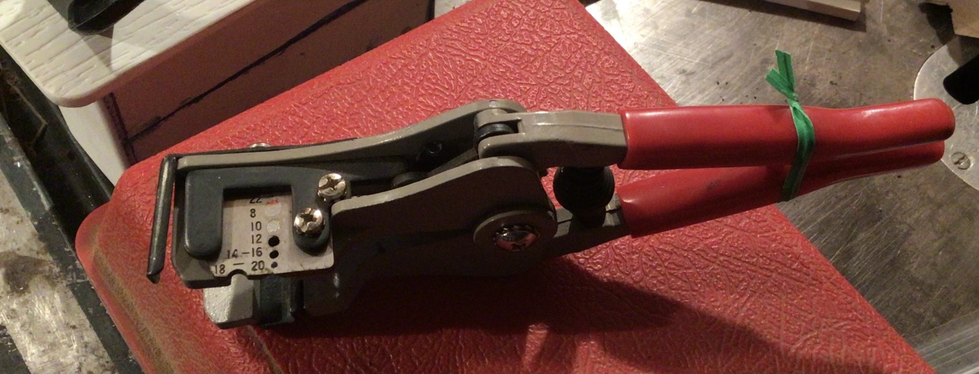

View attachment 230338View attachment 230339
This is absolutely the wrong type of crimper to use for heat shrink or insulated terminals. It will pierce the insulation and allow moisture to enter the fitting violating the seal the heat shrink and insulation are there to provide. Toss that crimper in the trash where it belongs.
