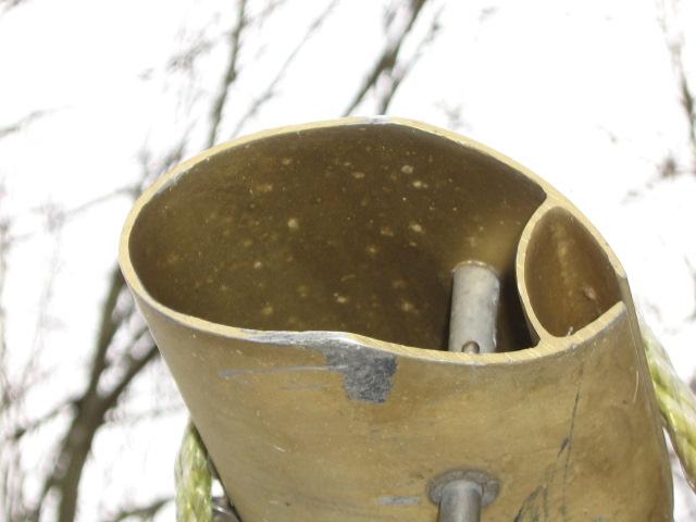

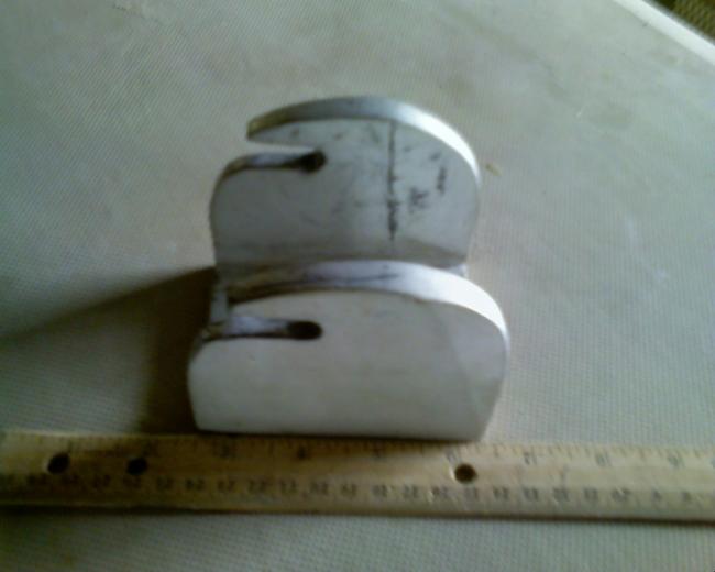

Picture??
Does your boat have the aluminum tabernacle, or the newer stainless-steel hinge plate?
If the older-style aluminum tabernacle there should be 2 cotter pins through the pin inside the base of the mast to prevent the pin from coming out of the mast, but there are no cotter pins or safety pins to hold the pin into the tabernacle (not needed and the way the tabernacle is desgned they wouldn't do anything anyway.
