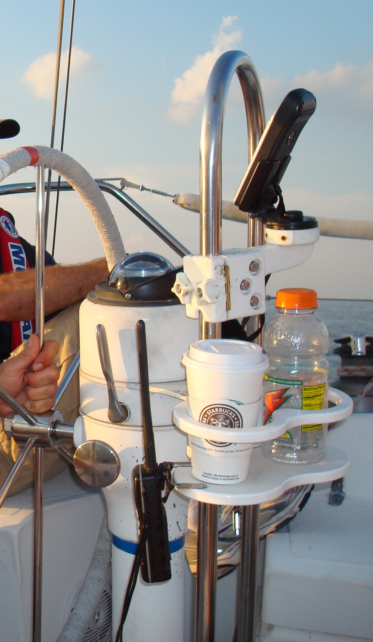

Almost 'something for nothng'...
...'cuz the base for the Garmin had to be purchased. Everything else for the GPS support came from starboard scraps and salvaged parts from other projects. Does that count?

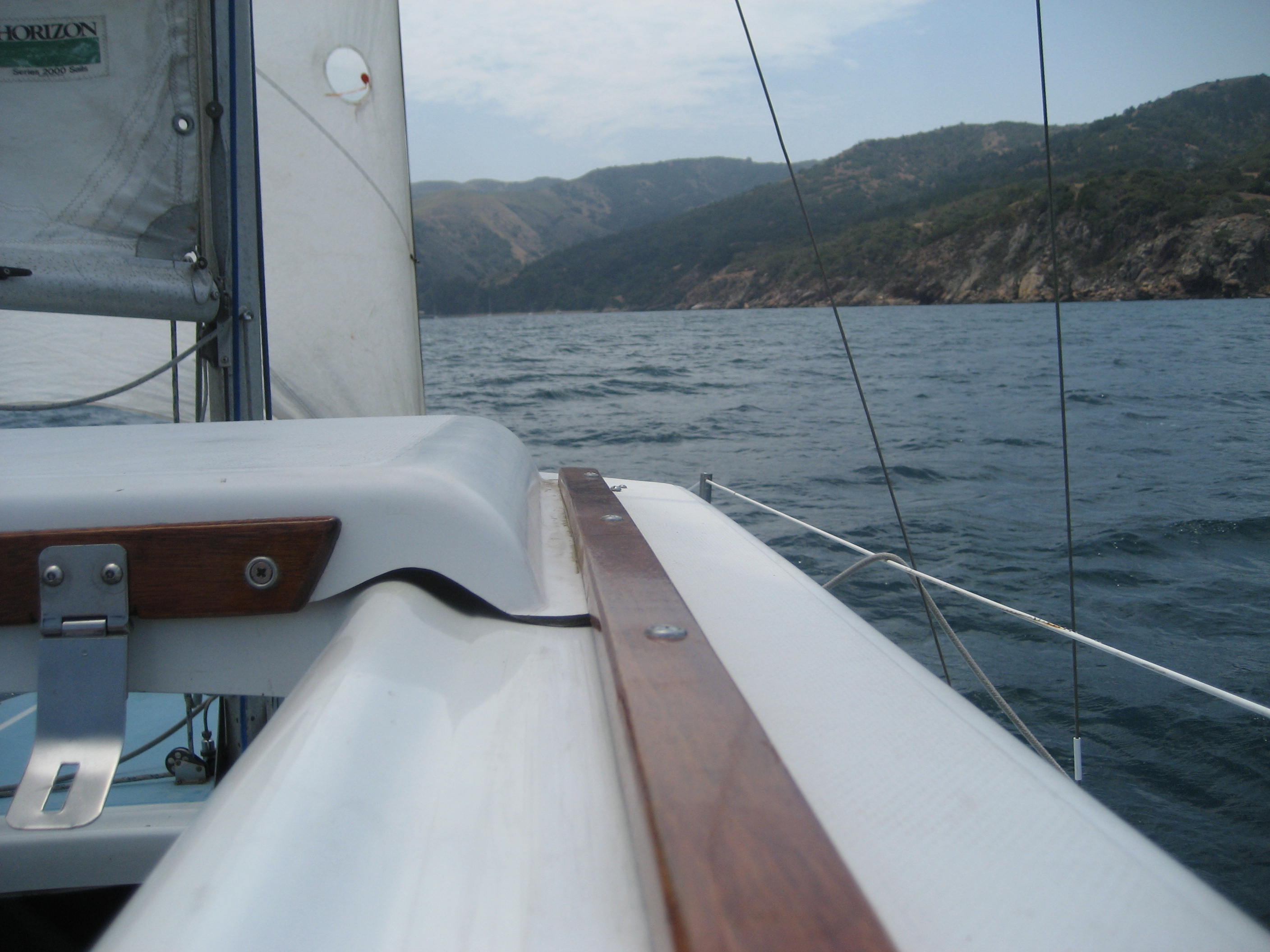

Replaced my poptop and companion hatch guides with some mahogany stock from school woodshop. Rabbited them during lunch at school. Used some extra marine varnish that I had in the garage. They turned out beautiful and best yet, they were freeee.

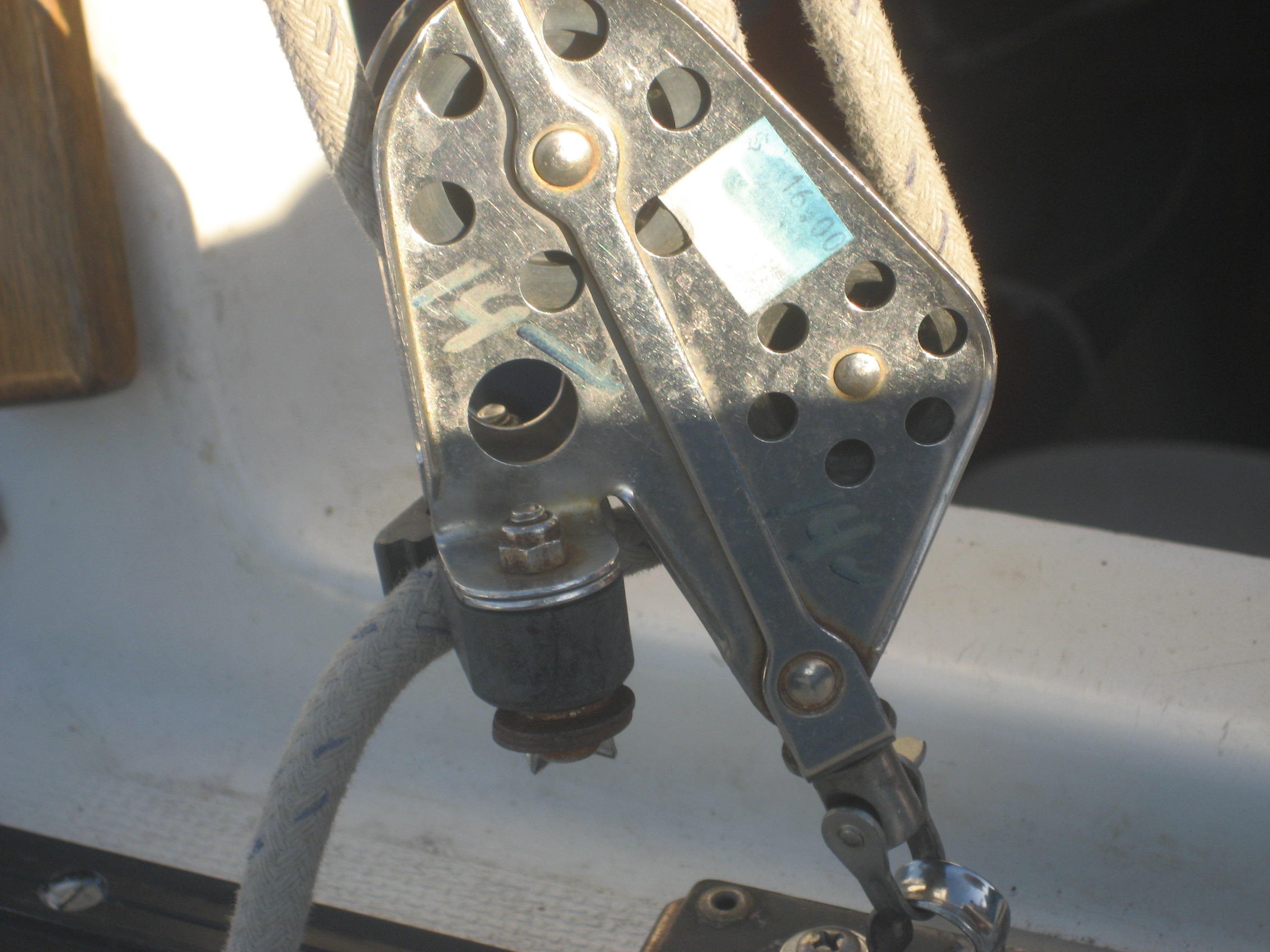

Installed traveler using block and existing hardware plus extra traveler from old Hobie cat and left over track from genoa tracks. Total cost for sheet block $16 from Minneys.

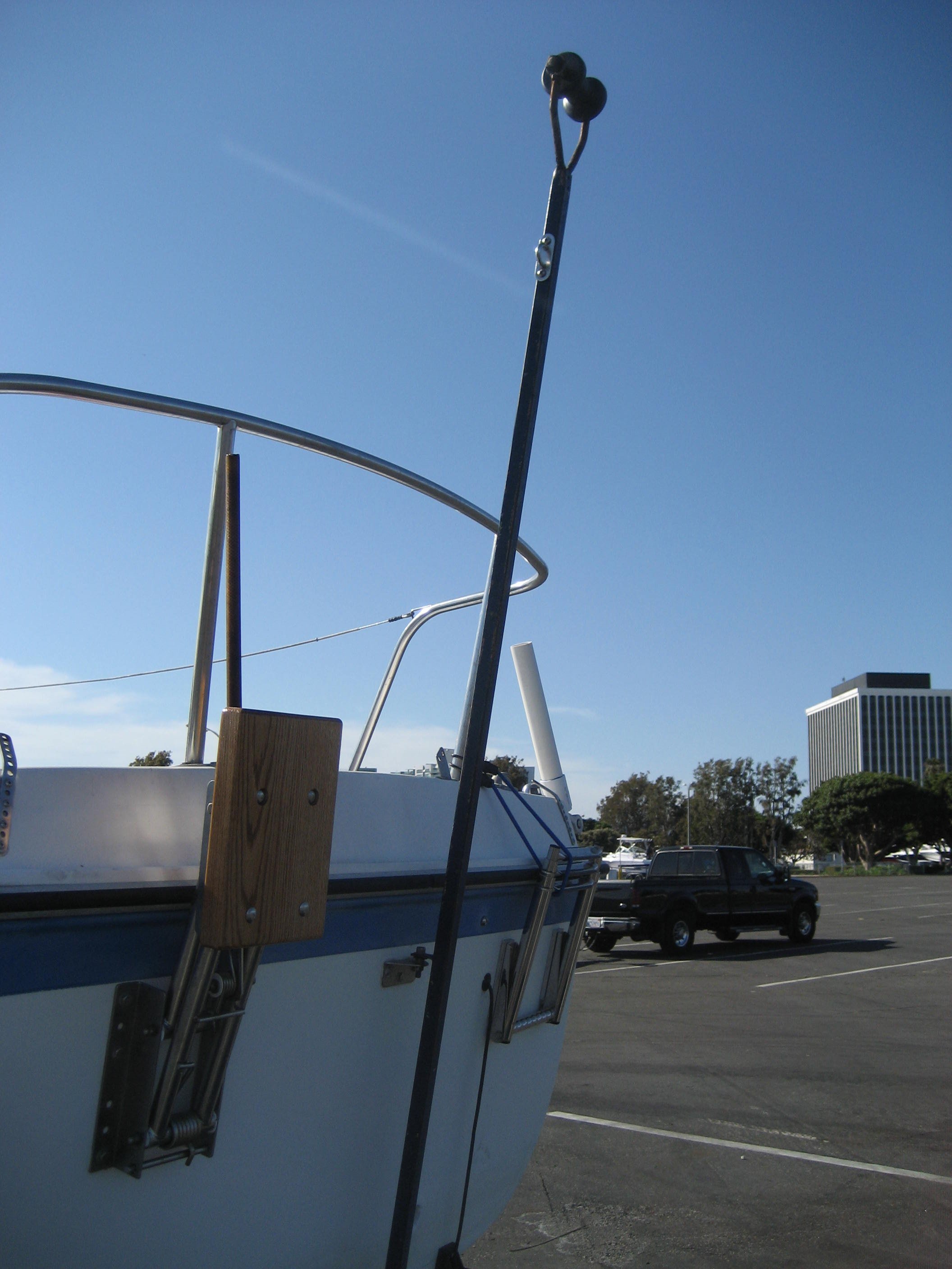

Telescoping ladder from Ebay $25.
Oak motor mount laminated 2 1x8s from scrap bin at school woodshop.
Adapted anchor roller to store anchor. Drilled 1/4" hole to keep pinned in place while traveling. Made 1/4" pin from stock found in garage. SS keeper pin $1.98 from OSH (don't think that paying $2 for a small hitch pin didn't hurt).

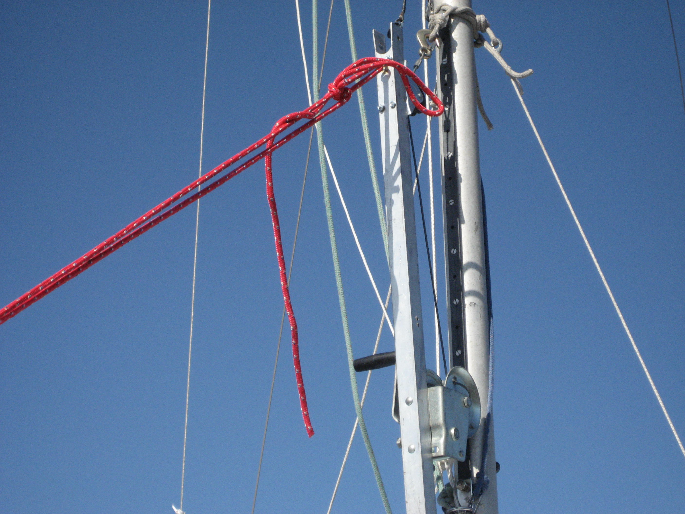

Made mast stepping system for less than $30. Saved $ by grinding wheel of $2 rubber caster into a sheeve and used as block.
