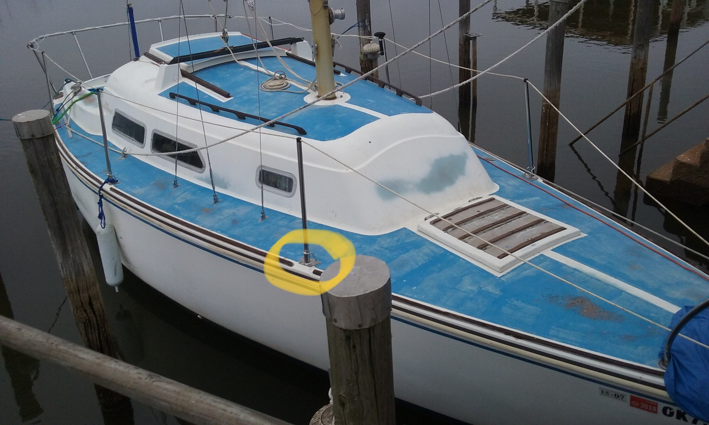

The circle is the exact spot the leek is coming down the wall in the v berth
Well that's a promising location. Hopefully just re-bedding the stanchion will take care of it.
You may want to check the deck in that area to see if it's spongy, which would mean it's waterlogged and bigger repairs may be in order.

It’s all super solid. I checked. Not one spot feels soft or spongy
