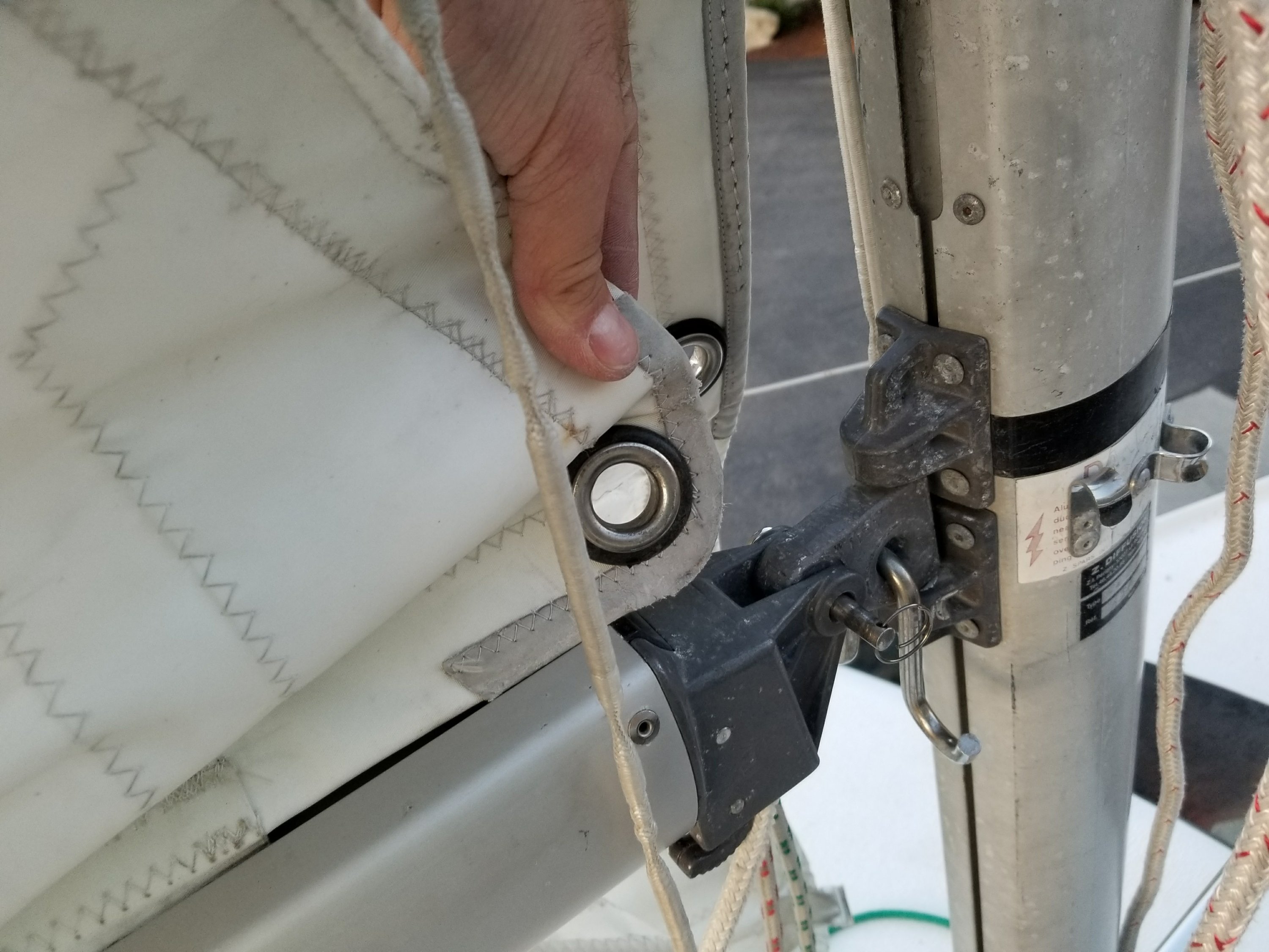

So after getting the mast up with ease after figuring out that you hook the mainsheet in the anchor locker, (thanks forum members), I'm focused on a couple other things.
First, I'm not sure where to attach the tack of the sail? The double hook on the gooseneck?
Second, where do I secure the reefing line? I'm used to there being a cleat on the bottom of the boom but I don't have one.
Joe
Jun 1, 2004
8,004
Use the hook on the gooseneck. It's upside down in the picture... you will have to ease the outhaul/clew hook at the other end of the boom. You should have a strap ring on the luff reefing cringle to slip over the hook when reefing. This should help you understand the isomat spars reefing system.

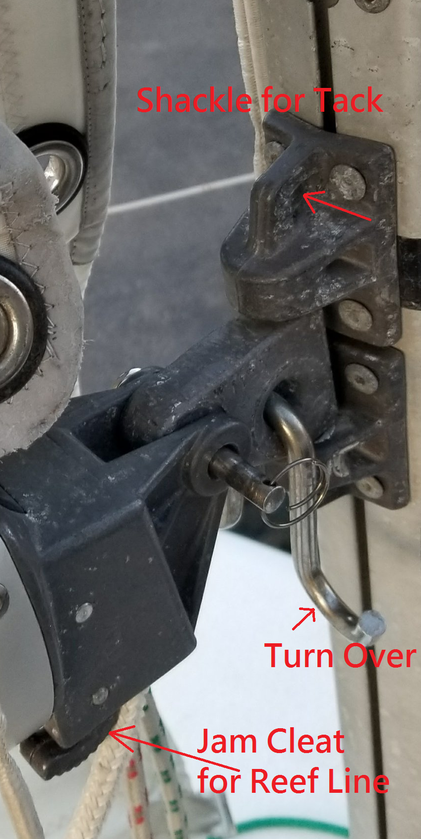

The tack of the sail attaches with a shackle to the eye in the gooseneck attachment to the mast. The rams head hook (double hook) is used for reefing the main. When reefed the hook is used to secure the reefing eye at the mast end of the sail. The reefing line exits the boom is routed through the lower reefing cringle and then ties to a pad eye on the boom. You need to use sail ties in the other two reef points once you reef the sail. I leave my two sail ties permanently installed on the two center reef points so that I don't have to look for them when I need them.
Do you have a copy of the 23.5 owners manual, there is a great diagram of how to route the lines for the jiffy reefing system.
Tony
10,051
Joe is correct the hook end is upside down and the hooks are the attachement for the mainsail for both standard attachement and reefing. Follow the diagram for the reefing line to. Thank you Joe.
8,402
rgranger did a great job illustrating the fixes. The horn needs to be turned around. The tack needs a shackle. The horn would not be advisable for a normal attachment. Every time you dropped the sail the chance of coming unhooked is great. Use it for reefing.

What are the two lines (red and green) coming out of the boom? those were both resting in the jam cleats on the gooseneck side of the boom. Are those both for the tack end of the sail? I could easily be mistaken, but I thought the reef line was the larger line coming out of the boom. Maybe that's just for the luff end? All my boats have been old junkers with roller reefing (boom reefing) systems so this is a little different for me.

it appears that your gooseneck clevis pin is too small a diameter and too long. keeping it tight will slow wear.

There should be three lines in your boom, one line is for your jiffy reefing, usually the starboard most line, the center line is your outhaul, and the line to port is for your topping lift adjustment. The topping lift should be attached with a shackle of some fashion to the end of the adjuster line so that you have control of sail shape as well as the ability to lift the boom up and out of the way if your anchored and want the clearance.
The Tack of the sail just gets attached at the gooseneck. I think I currently have mine on the hook but like someone said, it tends to fall off.
My H26 has room for 3 lines like that through the boom. One is the outhaul attached to the clew of the sail. For me that runs out the boom and then back to the cockpit. Another is the reefing line. I had trouble keeping that jam cleat from slipping so I added a cleat to the lower part of the mast for this one. My third one is not used but I suppose it could be used for a 2nd reef point if you have one or to adjust the topping lift. As for what line is what in your picture, I think you just have to figure it out from the size and length of each line.
12,369
Your reef line is the one in the jam cleat. It goes to the clew end of the boom, exits and then goes up to the reef gromet (reef clew) and back into the boom. To reef you lower the main and insert the tack gromet in the reef claw at the mast, then simply pull that line near the jam cleat. it will cinch up your tack and.... done....

I found if the foot of the main is tight enough with the correct tension on the outhaul, the horn turned up correctly will hold the main in place. By putting a shackle on attached to the fixed plate pop riveted onto the mast, it takes more time taking everything apart paticuraly if you are trailering a lot.
As for the topping lift, there are several things you can do. First with age the topping lift line coming thru the jam cleat at the head of the boom will eventually wear out and give causing that line to loosen up and boom falling. I use to put a stopper knot in the reef line so if it did prematurely fall, the knot would stop at the jam cleat lever keeping that boom from falling hurting someone or damaging the boat.
As for the topping lift, you could add a curved base turning block attached to the end of the boom either side leading forward aft to a cleat. There is another option that worked well for trailering to help eliminate time. In the small boat vang dept. there is a two turning block with a V jam on the back side. You could attach the block to the end of the boom and run the topping lift thru it by running it on the back side of the first or upper turning block and around the front side of the larger lower turning block and back up to the v jam. Worked very well. You could attach the V jam two turning block to the end of the reef line exiting the back of the boom (coming out of the boom). Food for thought

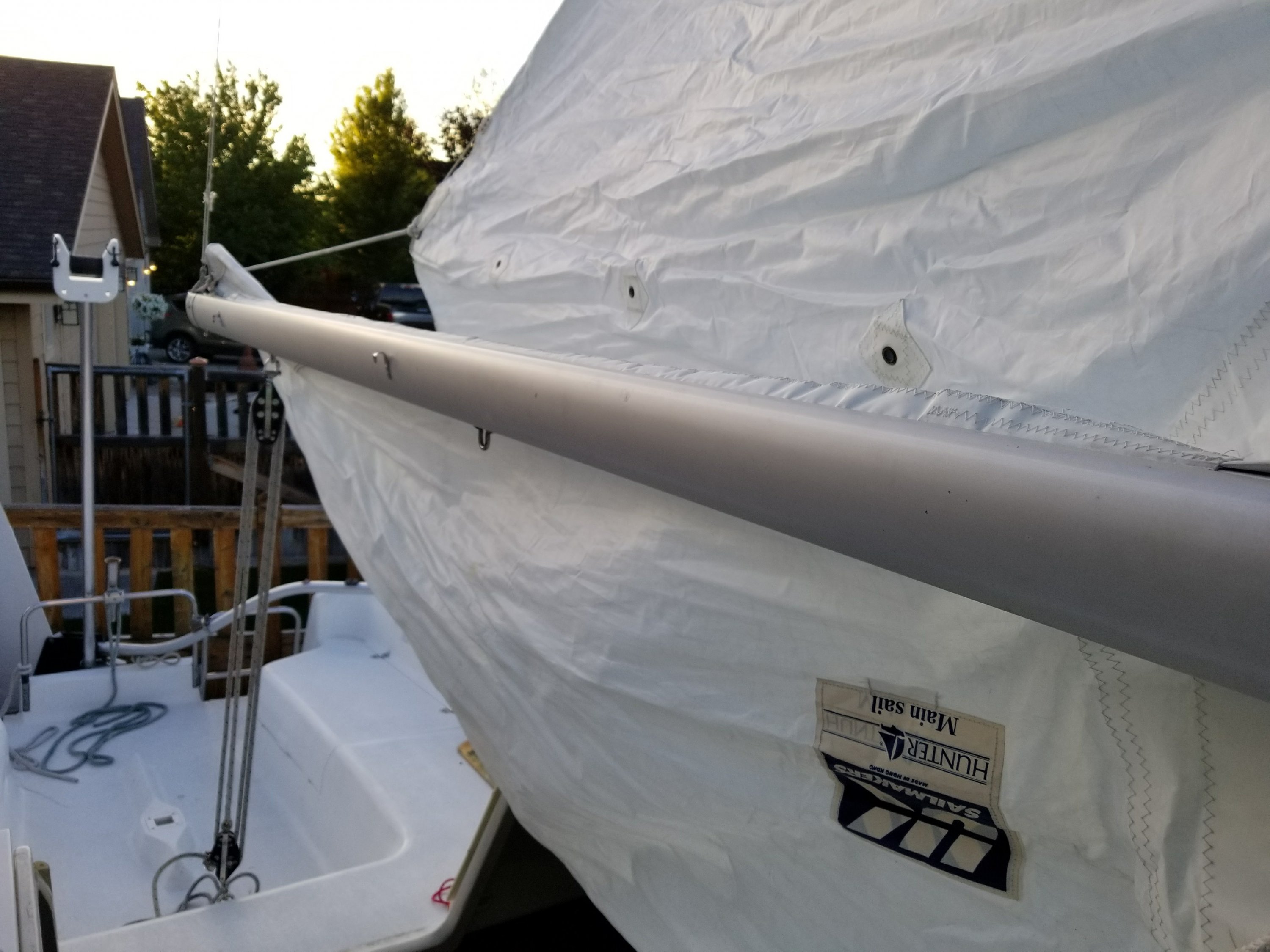

Thought I'd share the fruits of my day on the water. Thanks for all the helpful insights and suggestions. We didn't have much wind, but was able to practice reefing with the jiffy reefing system, proved out the swing keel functionality, raised and lowered the mast with ease although I still have a little trouble loading on the trailer trouble free, but the boat is back in its parking spot safe and sound. Awesome day out!

Thanks for sharing the photo.... that is what it is all about....
