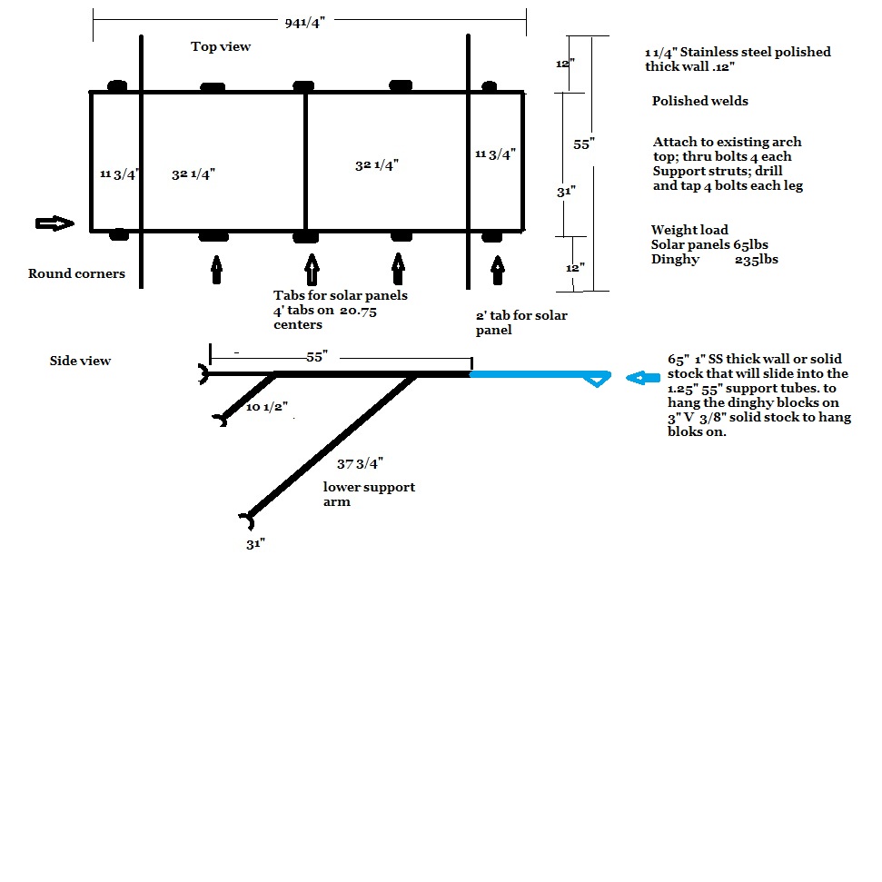

For on top of the bimini you buy ss handrails. They are available in different lengths and styles. Cut an x in the sunbrella material, drill through existing bimini frame, bolt on. 4 u bolts, 4 lengths of aluminum 90% angles, 2 bolted together.
