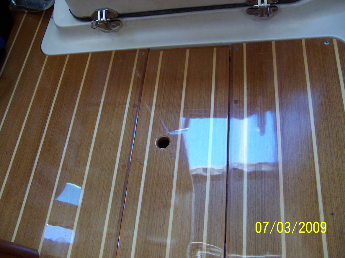

Hopefully you still have your original pieces as a pattern. Contact a GOOD carpenter to cut new pieces, attach strengtheners same as original, and varnish with about five coats of spar varnish. It's not going to be cheap. Might be cheaper to take a carpentry course and buy the needed power tools to replace the carpenter.
The real stuff is a bit of a pain but always looks best :

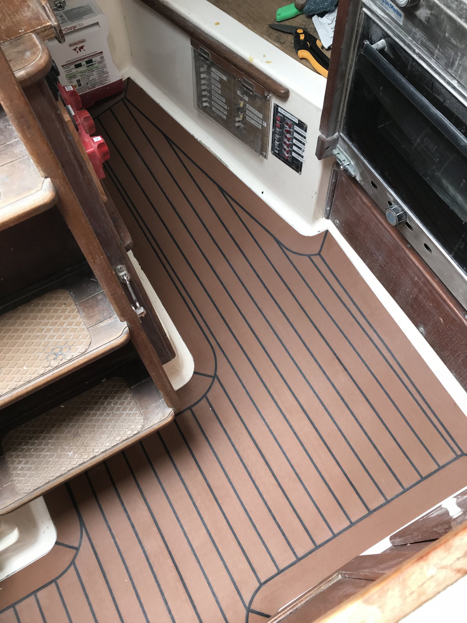

My dock neighbor had a company come out and photo image his deck… then a computer laser cutter made custom faux wood plasteak mats that dropped in. Looked FANTA$TIC!!!

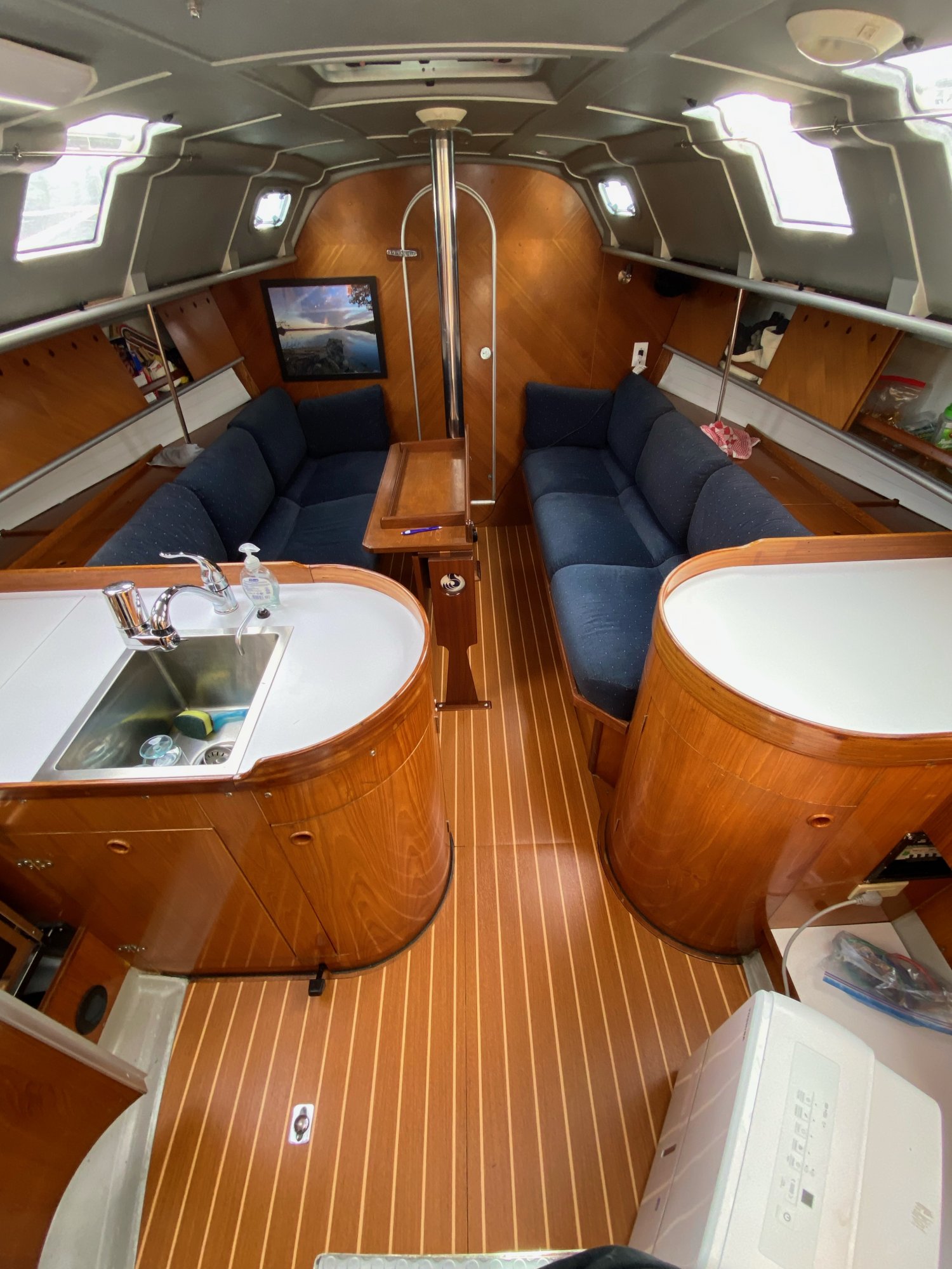

You might consider refacing your sole plates (if they are sound) with Lonseal T & H or Plasteak. Both are synthetics that look like the real thing with the added advantage of never needing maintenance.
This is our boat with Lonseal epoxied onto the original sole plates.
