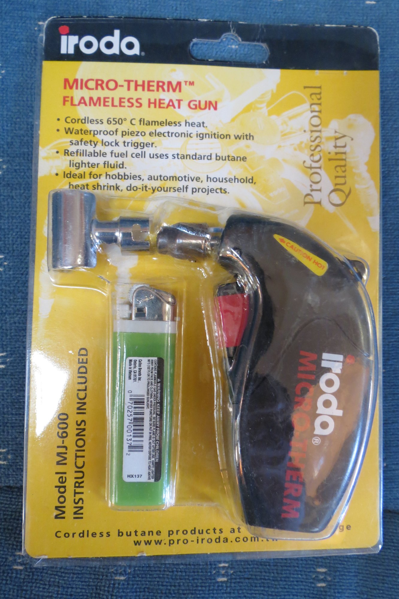

The coax connectors I use are solder-less. They use a special tool that compresses the connector and makes watertight seals on the cable and the shield. I forget the brand but I can look it up when I get home. As for the 6-conductor cable, I think the best connections use adhesive lined heat sealing terminals. You have to make sure that they are crimped tightly (takes practice and a quality crimping tool), but no soldering is required. As for sealing the heat shrink at the top of your mast, I have a device that is designed for this task and it uses disposable butane lighters for fuel. Barring that, you could use a small torch in a low wind condition. A torch like one used for caramelizing the sugar on creme' brulle could be perfect.

Here are pictures of the heat shrink device that I have. No flame, light and easy to use and completely portable. But pricey- I remember it was about $30. For your one-time job, I might try a small torch. OTOH, it is a nice item to keep on-board for future projects. If you are doing any amount of wiring, it is really handy. Check on eBay or Amazon for a source.
