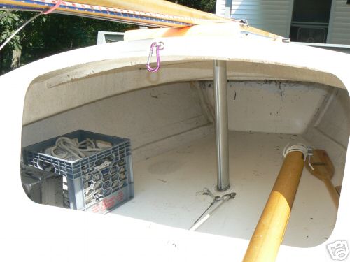

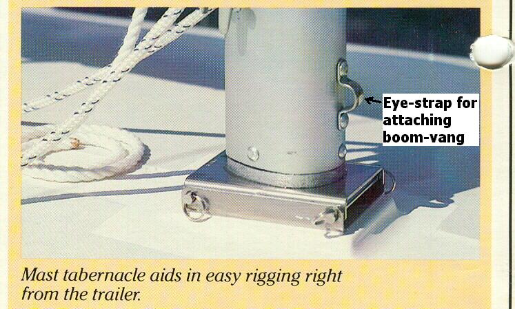

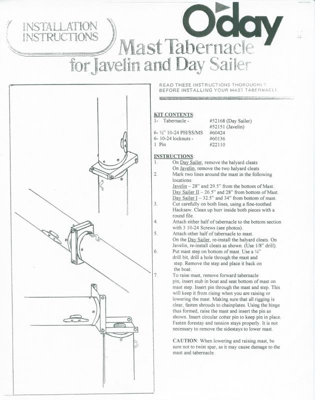

The DS II has a lighter mast that the MARINER, but I'd look for one with the hinged maststep option (standard starting in 1981 or '82). A hinge can be added to the mast just above the top of the cuddy if you found a DS II without the hinge. D&R Marine sells the parts or a local sparmaker can sell you the parts (and do the work if needed). Because the DS II has less rigging on hte mast, it weighs about 2/3s that of the Mariner mast. The 24'3" mast legth on the DS II includes the part below deck, if I recall the hinged mast will be about 27" shorter (that 27" stays in place with it's foot on hte cuddy "floor", pinned to the step). The last picture is of a 1984-5 model where the hinge was now attached to the deck instead of being spliced into the mast.

I will look for the newer mast step type, or follow your advice and install the kit.
