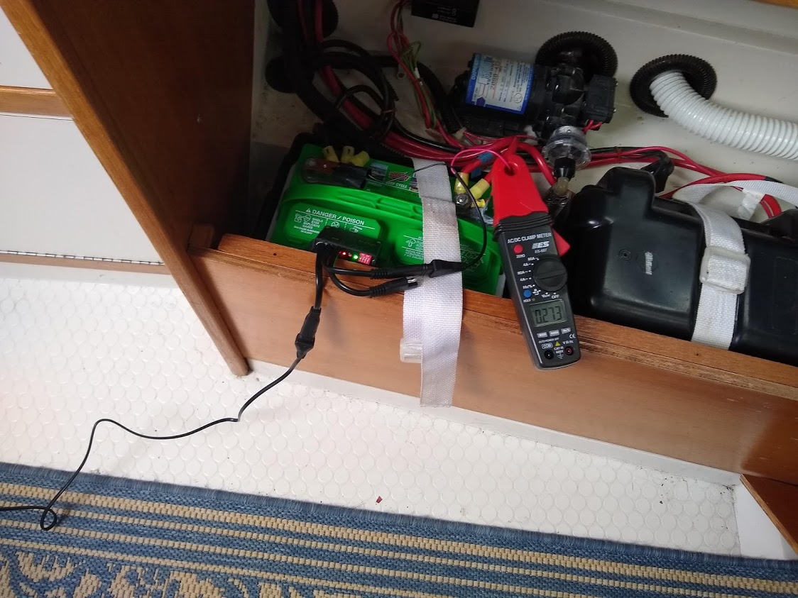

Because of flooding on Lake Ontario I have lost my dockside power. To be able to charge my starting battery I purchased a 30W solar panel with a controller. I plan to clip onto the wires from my normal AC charger that run to the battery (they are easily accessible).
Once I have my dockside power back later this summer can I make a permanent connection to the battery? This means I would have the alternator, AC charger, and solar charger all connected in parallel.

As I understand the original post, basically, he plans on using the battery charger cables as an extension cord to reach the batteries until the water recedes on the lake and he can use shore power again at which point he'll connect the solar panel to the batteries correctly, i.e., to the battery posts or to positive and negative busses. He does have a controller to regulate the voltage.
A 30 watt panel properly controlled will have a maximum out put of about 2 amps at 14v in full sunlight. That's enough keep the batteries topped off, but not enough to recharge a partially discharged battery, unless there is a lot of sun with the panel properly positioned to maximize the solar energy for a good many days. In upstate NY this spring, those conditions aren't happening! He'll get about 8-10 amp hours a day out of a 30 watt panel if he has a decent MPPT controller and the weather cooperates.
I don't think the OP intends to run the AC charger off a small DC solar panel.

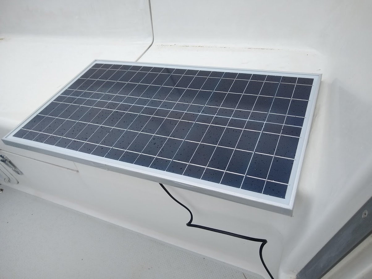

Just came today. Hooked it up to my battery just as it stated to rain. Panel still putting out 260ma.

That looks pretty big for only 30 watts. Not much smaller than a 100W panel. Glad to see you were planning to use a charge controller, as a panel will such the juice out of the battery once the sun goes down without a charge controller or blocking diode.
