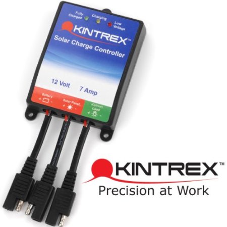

I used one of these for years (a different brand but same device)
I believe its true that you cannot overcharge with a 5w panel (that's what mine is) but this device is 'just in case'.
I've since moved to a bigger unit to handle alternator charging as well.
