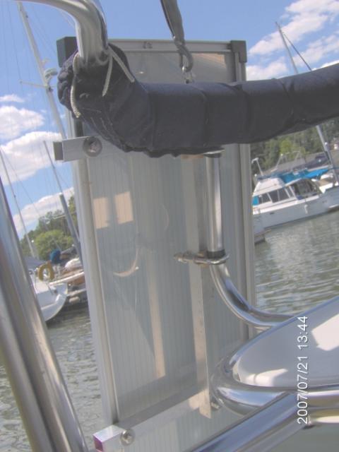

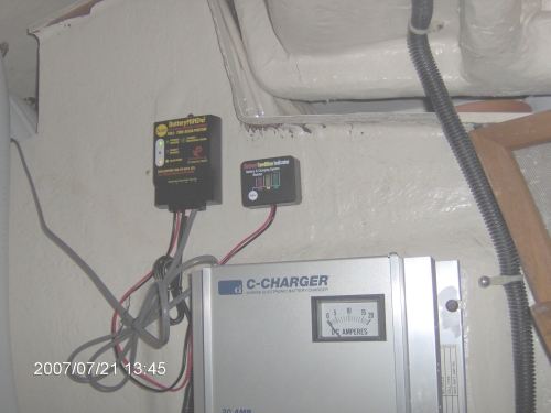

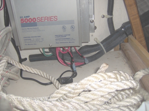

A more modest setup than Witzend's
I have a 15watt solar panel installed as I almost never use the shore power at the dock. The solar panel is wired into my shore power charger as the wires were already run so it was much easier. I mounted the panel on my stern rail. Been using it for 3 years now and it works great. My controller also had a desulphinator circuit which I credit for giving my last set of 4D batteries 3 extra years of life.
