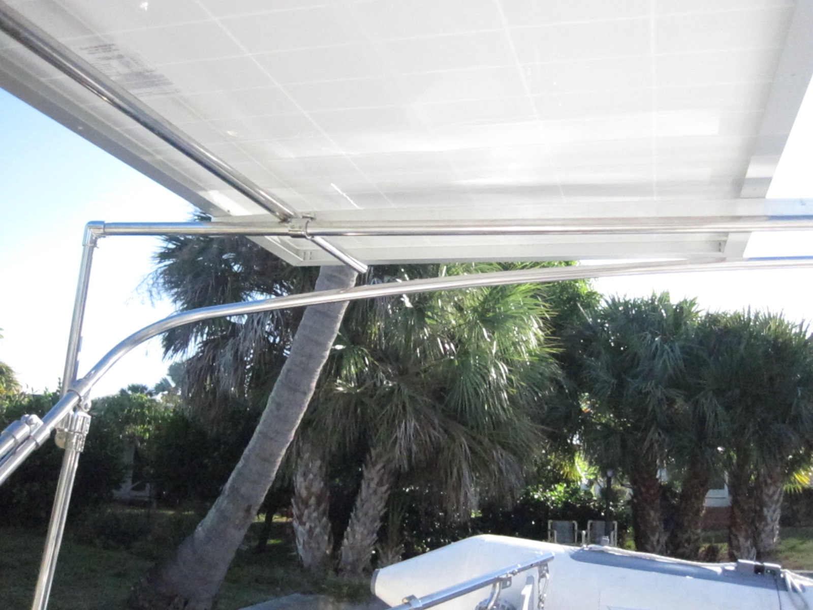

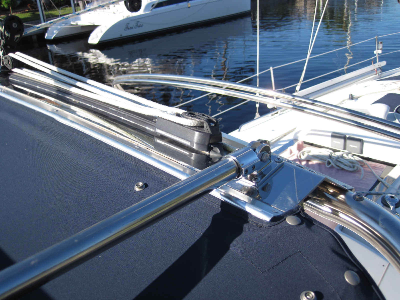

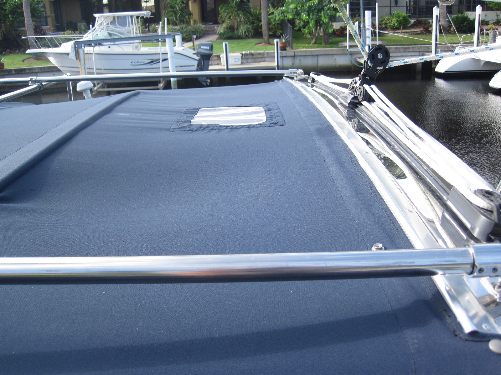

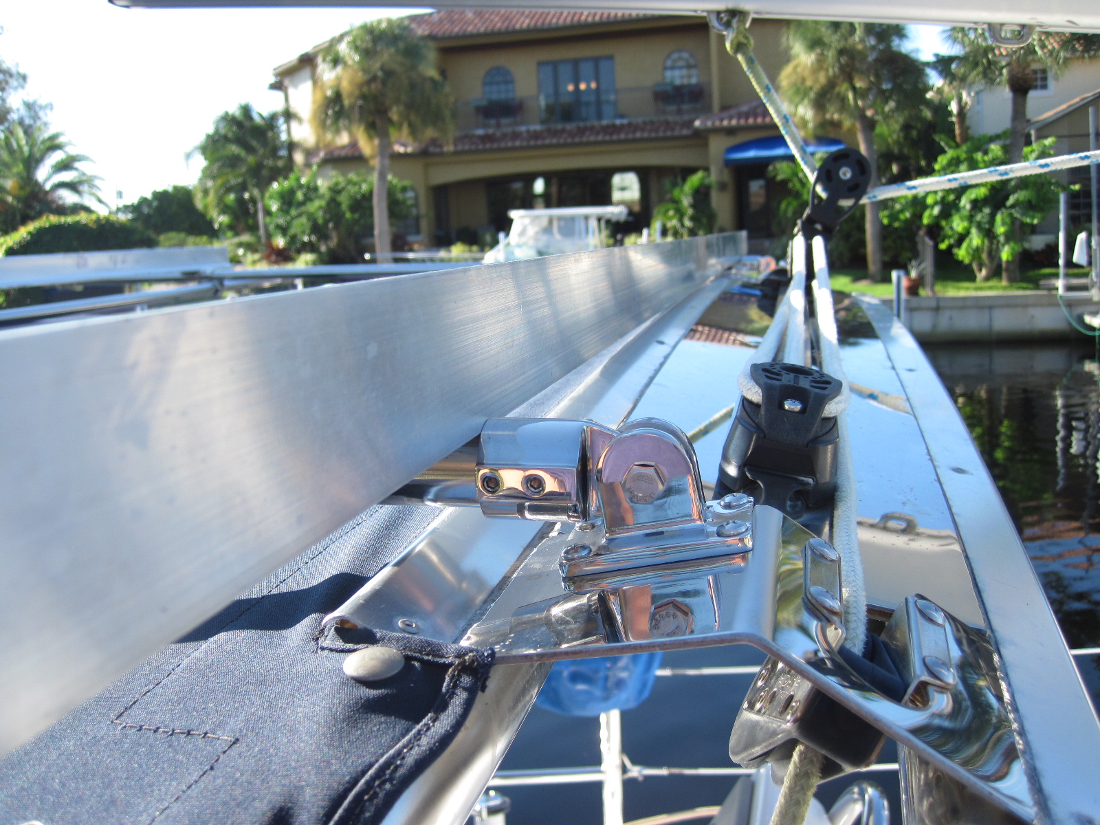

Dec 19, 2006
5,836
Hunter 36 Punta Gorda
I used stainless mounts off of the arch with stainless tubing
to the back bimini support.
Will look for my photo's.
Nick

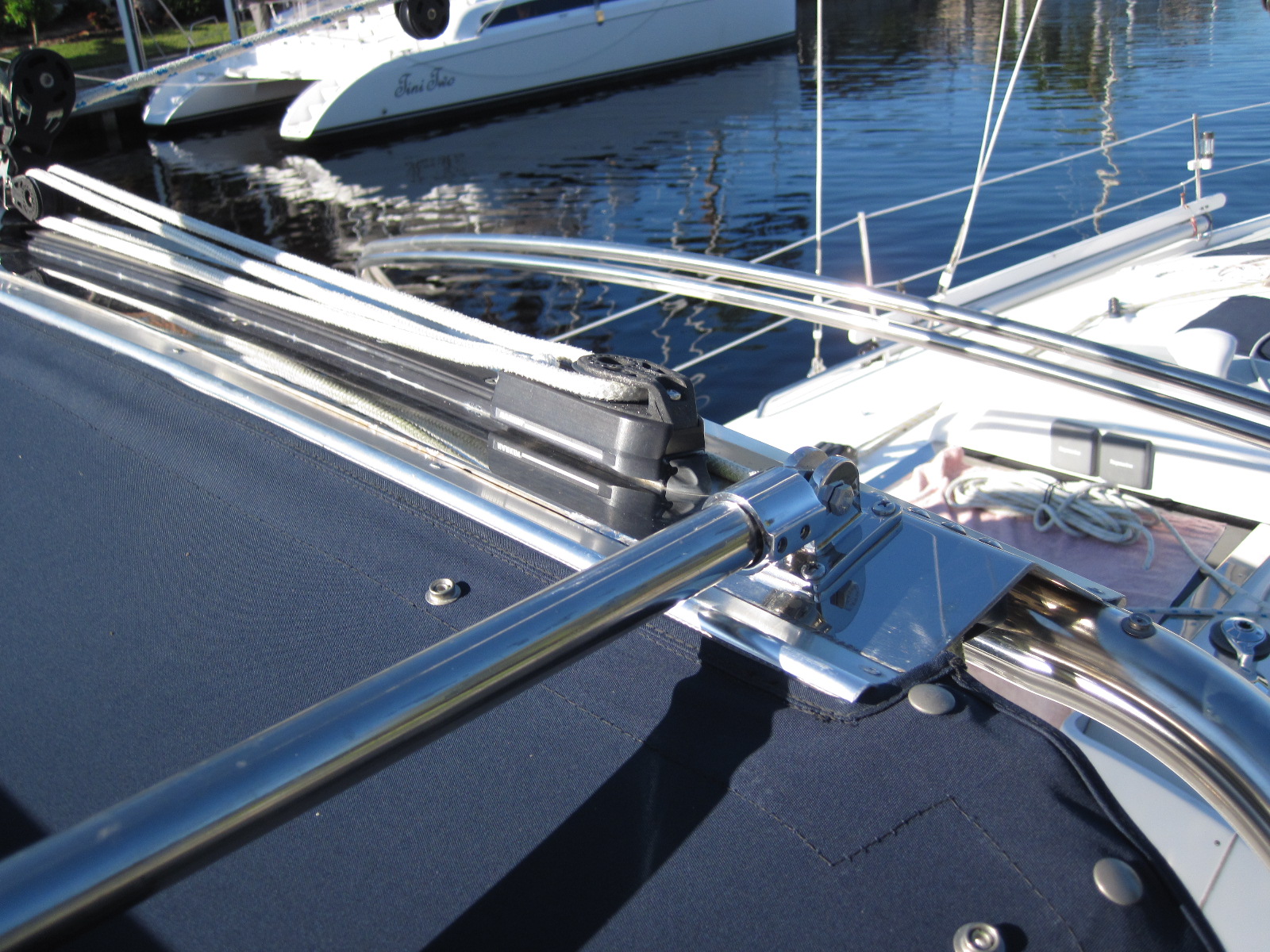

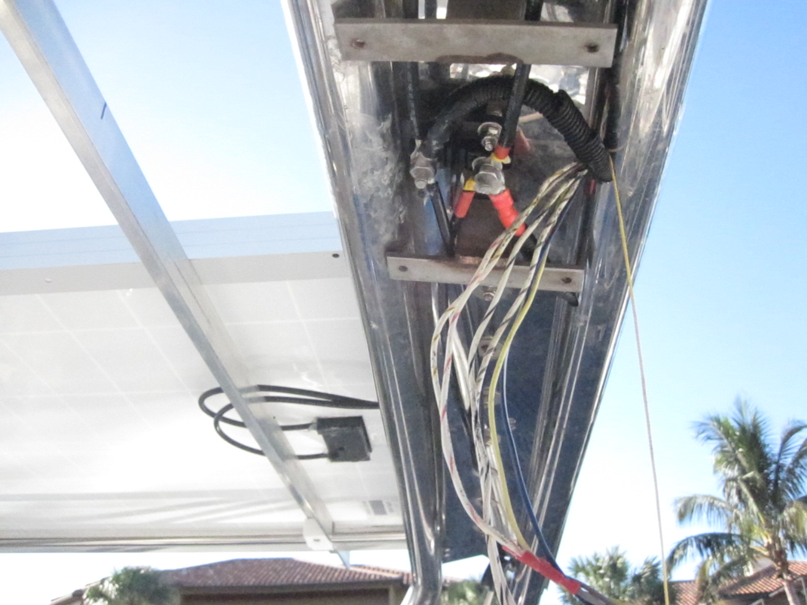

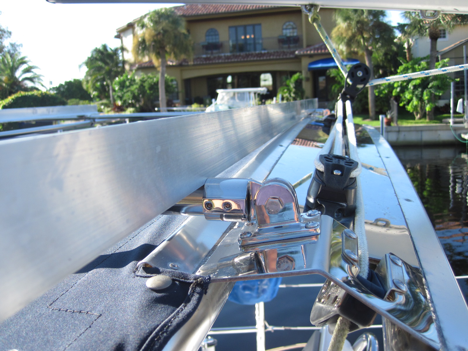

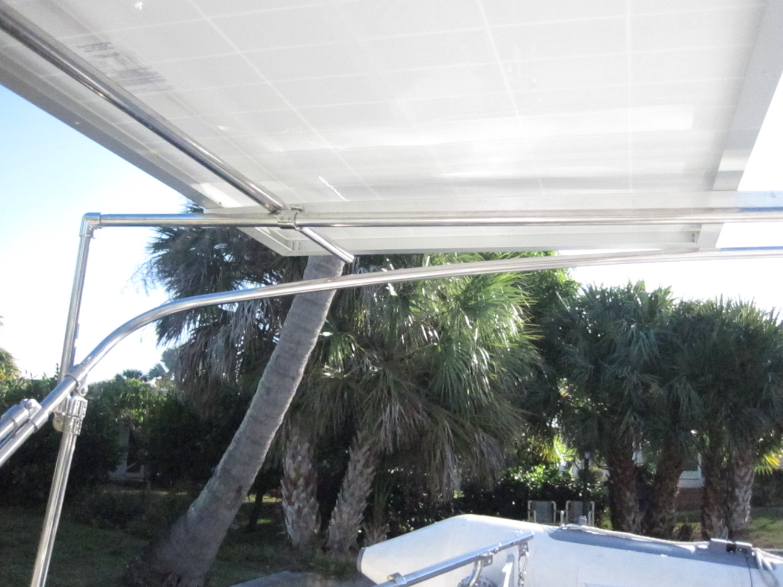

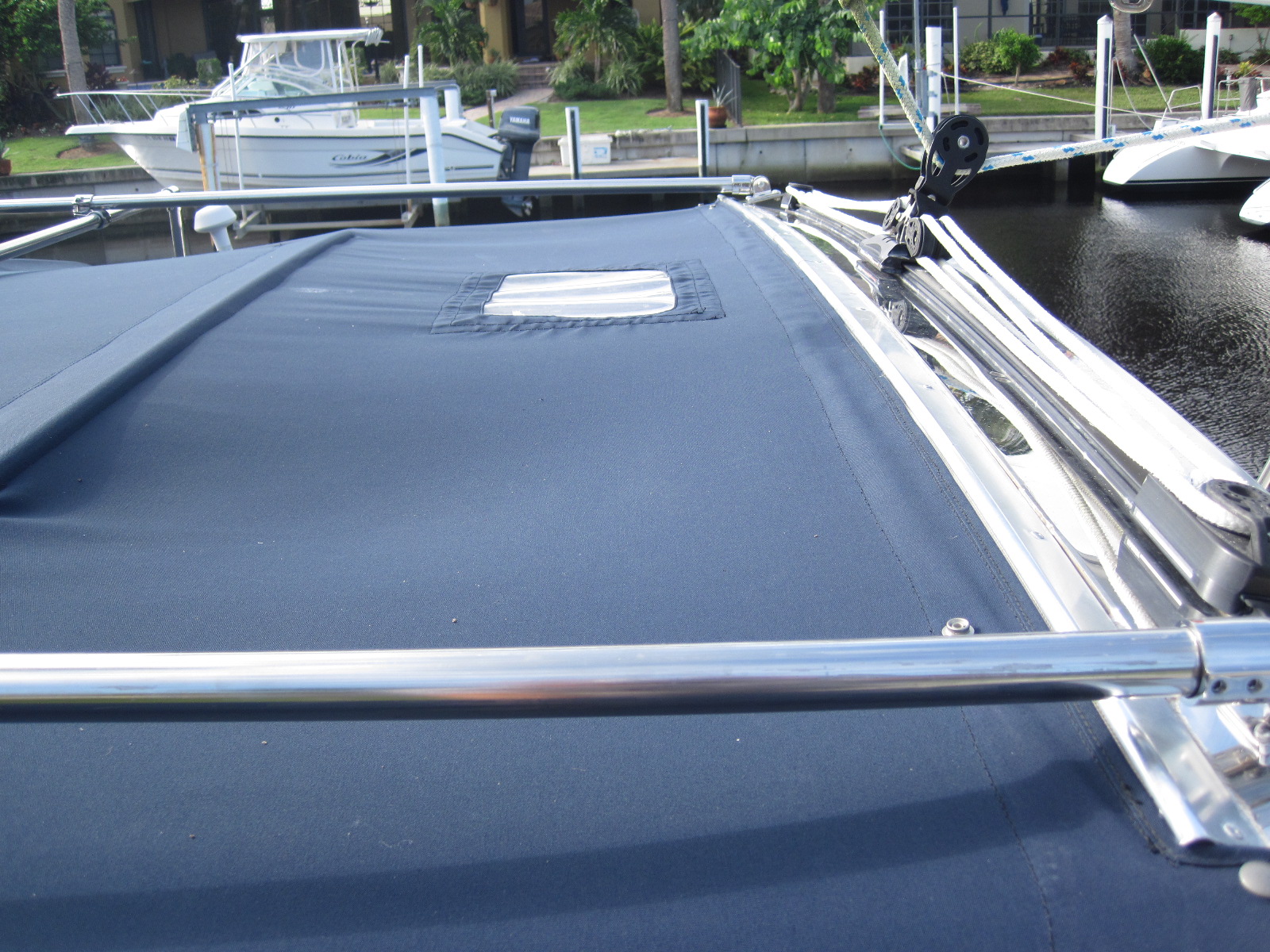

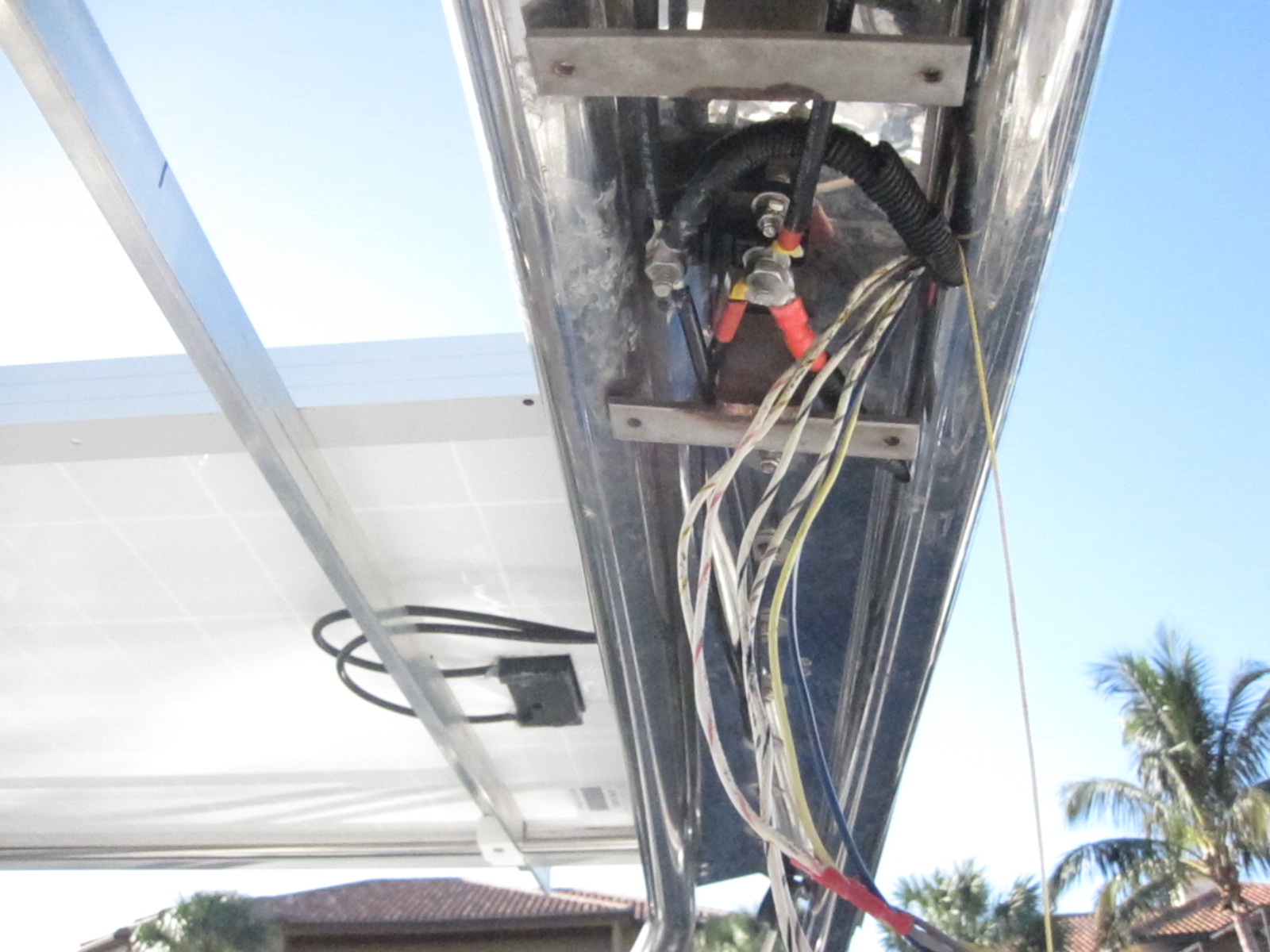

I used one large panel, 325 W mounted behind the arch above the Bimini. We use about 100 Ahr per day. Usually at 100% SOC by noon, then use the surplus to charge computers etc.
I'm surprised your energy budget is not higher. With radar, plotter, AP etc running. We use 100 Ahrs just with the fridge, freezer, LED lights, anchor light etc. I know he fridge and freezer are the energy hogs and the ambient temperatures can make a huge difference. How did you measure your energy use ? We used a Victron battery monitor.
I have pictures on my profile page.
Bob
