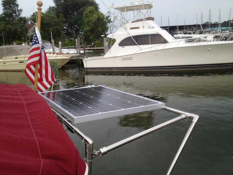

I started out with a 15w solar panel with two controllers, one for each battery. This topped up the batteries when at the dock over a few days, but was useless in keeping up with the amount of power I was using on a daily basis when sailing
I went with a 100w unit and now can run the VHF, the stereo, the auto pilot and keep my cell phone plugged into the cigarette outlet, without a drop in voltage from the batteries. At the end of the day, I can run my anchor light all night and use the LED cabin lights as needed without running down the batteries completely.
Taking the advice from the knowledgeable people on this list, I basically looked at how much power I would be needing with everything running and got a solar panel with enough watts to cover and added an extra 20 watts.
I am basically running my equipment without decreasing the amount of power in my batteries.
I am going to see how much of a difference it will make when I plug in my laptop to keep the battery topped up.
The panel I bought came with 20 feet of cable and a single controller. Having already installed two controllers I used them and have an extra, now sitting on the shelf.
The panel is framed and I created a stainless tube frame off the back of the transom railing to hold it. There is enough room on the frame to put a bigger unit if I want to, but for now I am good with what I have.
