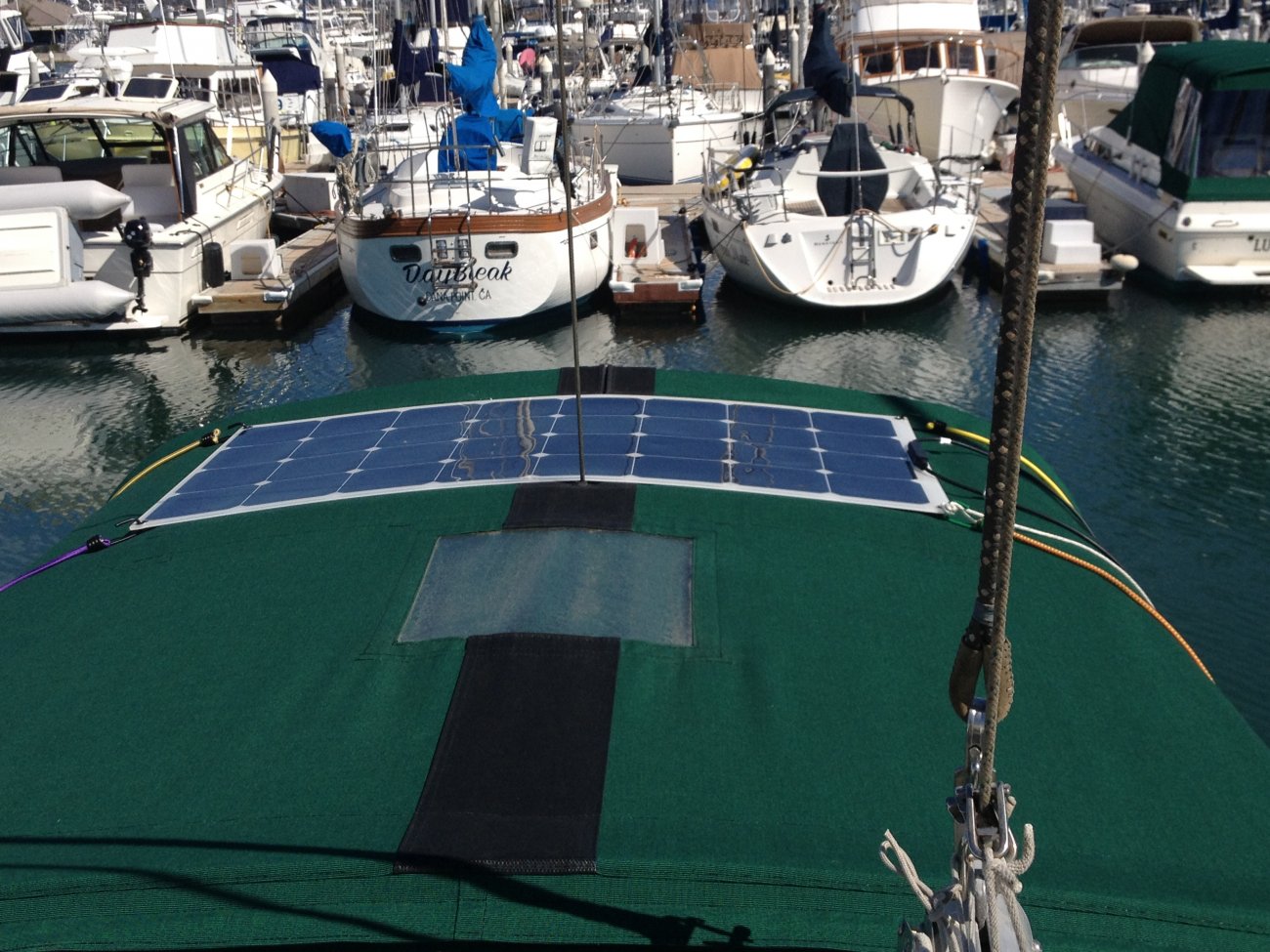

I use a 100w flex panel from Grape Solar that I bungee to the bimini (pic). With MPPT controller.
Have a quick disconnect plug in cockpit for panel input.
It runs the whole boat, including Indel TB18 fridge, charging phone, tablet, etc. All LED lights reduce consumption drastically. The controller is green (full charge) by mid afternoon. -this is when moored/anchored. Under way uses more juice with AP, chart plotter, VHF, instruments, etc. Not a problem with one day passages, but 100w would be inadequate for long crossings.
I only use the panel when cruising, then it hides under the quarter berth cushion.

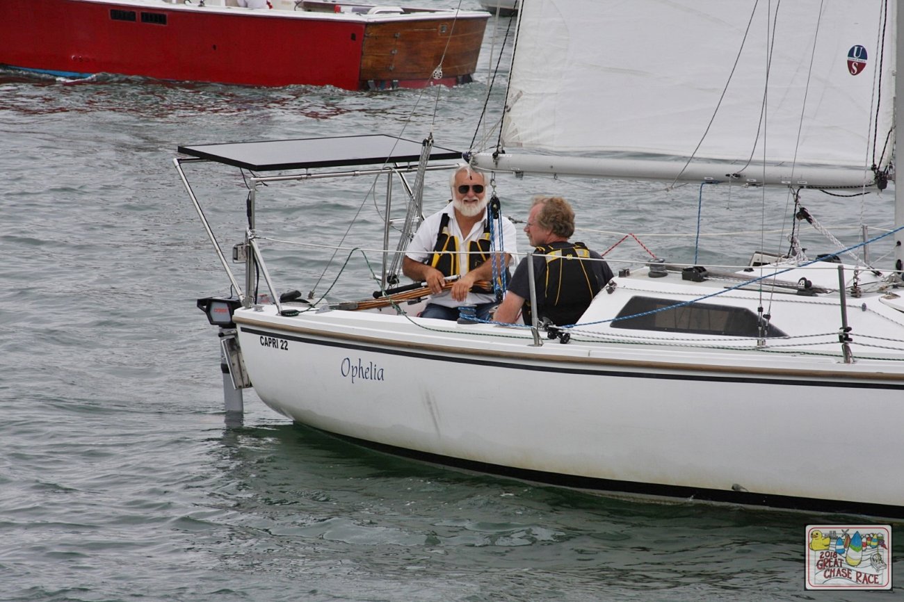

Keep in mind that everyone has different goals while sailing. I race but I consider it as practice for effective daysailing.
I have a 110 watt rigid solar panel permanently attached above the stern. The goal was to charge and maintain the 24 volt, 210 amp lead-acid battery bank while on a mooring all season. The standard "12 volt" solar panel needed a 12-volt to 24-volt booster controller.
The battery is used to power a Torqeedo Cruise 2.0 electric outboard for several years. The solar panel via a separate 12-volt charge controller also charges the "house" battery that runs the lights and electronics
Last season I changed the lead-acid batteries to lithium and shed 200 lbs. Plus I increased the rigid solar panel to 160 watts. The solar panel continues to charge the batteries while we enjoy the sunshine as we sail.
Previously, I tried using Ganz flexible walk-on panels on the foredeck. They worked well for two years reducing windage. But the flexible panels all failed about the same time. The internal connections between the solar cells broke during the heat and cold cycles (not the walking on).
The frame is 1-inch tubing (lighter gauge would be sufficient) clamped onto the stern pulpit.
The photo shows the basic configuration. It was taken this September at the annual Hull YC "Great Chase Race". There was an hour delay waiting for the wind to appear. We had to motor over from Winthrop and then troll around for the delay. Eventually the wind came up and provided an enjoyable race.
