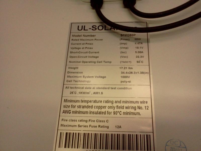

I finally had time to go by the warehouse and open my package.
Ed. The reason I purchased these is because I have about 36x60 open area and these two panels would fit properly. I had explored the idea of puting them over the Bimini top and I was going to use the 24 x 48 size.

Thanks Jose. I found the UL-Solar panels on the web. Two of those 80 watt panels should serve well in SC. I'm looking for something just so I don't have to worry about the bilge pump during the week at the slip. I want to leave the boat unplugged. So I am thinking the 60 watt at 26" x 26" would be a good size. The bimini frame would be perfect but then I can't fold it back. :cry:
