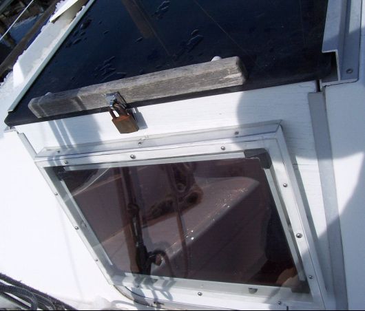

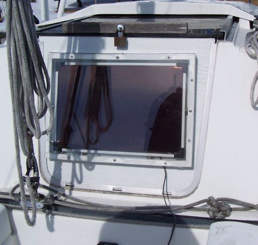

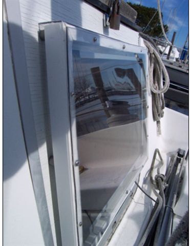

I have the Harbor Freight 5W pane- actually 2 of them- They are not supposed to be directly exposed to rain- I had inquired about it to HF. I wanted to mount one on my weekday companionway slide-in board and run the wire under the lip of the cockpit locker and to the battery below it.
l liked the price so I got it and bought a clear plastic sheet and several feet of plastic deck rail trim from Home Depot and built a frame. Nigel Caulder's book on sailboat electrics mentions that the effectiveness of these solar declines in heat(I have a southern exposure in the slip). To allow air to pass under/thru the panel/ frame, I had the panel lifted off the board with bumpers - and also since its not waterproof- had a piece of the clear plastic touching the companionway board across the top.Just in case I also put a thick bead of silicone around the solar panel's frame edge - both top and bottom. Its worked fine.
When I'm at the boat in the slip for the weekend I hang the solar board on the stern cage rail. its out of the way but still functional. The Second 5W solar panel hangs under the Vberth hatch- it wedges nicely into the dog locking channel of the frame and the the dogs/lever hold the other side up-and it plugs it into my 12V system to the 2nd battery.
