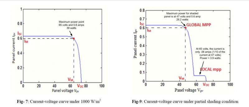

It’s interesting to look at why this makes any difference. Solar panels usually have some internal mix of serial and parallel diode connections. So when you connect two panels, you are just making them a little more either serial or parallel and its complicated for what actually happens with partial shading. Each manufactures panels may behave a little different.
This link is from a recent IJRET technical paper regarding MPPT and partial shading
http://esatjournals.org/Volumes/IJRET/2014V03/I19/IJRET20140319072.pdf
The above is from that paper and figure 7 shows the V/I panel characteristics for full sun and figure 9 shows the same panel with partial shading. Likely different panel architectures might behave different than what is in these figures but this likely does represent a fairly common V/I for a shaded panel.
If we assume we have two panels in our application, take a look at what power you would get with some different architectures for the panel in the figure.
With both panels getting full sun, both panels operate at the maximum power point in figure 7 (65 volts and .6 amps = 37 watts) so the total output power is 74 watts.
Now if we connect a full sun and a partial shaded panel in parallel with a MPPT controller, an interesting thing happens. One panel has is maximum power point at 65 volts but the shaded panel has its maximum power point at 47 volts.. however, since these are electrically connected, they both operate at the same voltage.
If you add the power of the two panels together (forced to operate at the same voltage), there is a maximum power peak that occurs at 47 volts where the total power is 28.2 +28.2 = 56.4 watts and a second maximum power peak at 65 volts where the total power is 39 + 3.9 = 42.9 watts.
A better search algorithm for the controller will find the best maximum power voltage of 47 volts and get the 56.4 watts. A not so good search may find the max of 42.9 watts at 65 volts.
Now consider the case of a MPPT controller on each panel. This now allows each panel to operate at its own best voltage so the unshaded panel operates at 65 volts = 39 watts and the shaded panel operates at 47 volts = 28.2 watts.
So the total power of the two panels with separate MPPT controllers is 39 + 28.2 = 67.2 watts.
Compare the best power you get with a single controller of 56.4 watts to the separate controller on each panel of 67.2 watts. The separate controller per panel outputs 19% more power. Now if the MPPT controller for both panels connected together found the lower maximum of 42.9 watts, the controller per panel of 67.2 watts is a whopping 56% higher output.
The other really interesting thing for the particular curves we are looking at is that both the non shaded and shaded panels still operate at about the same current. So if these were operated in series and with an MPPT controller, the current through the panels would be .6 amps and the unshaded panel would operate at its maximum power voltage of 65 volts and the shaded panel would operate at its maximum of power voltage of 47 volts resulting in a total power of 39 + 28.2 = 67.2 watts.
So for this case, you get the worst partial shading performance connecting the two panels in parallel with one controller. And, both the series connection and the controller per panel each netted the same maximum power available. The series connection doing as well as the controller per panel likely is not always the case.

Good presentation Walt. It is easy to grasp the simple fact that 2 separate solar systems have advantages and especially with regard to shading. With such a technical presentation just be aware that few people will comprehend the detailed narrative or graphs. Chief

Just to point out.. for the case I showed in the figures, the two power peaks were at 47 volt and 65 volts. Some controllers will actually do a large enough sweep to find the best peak at 47 volts. But in order to do a large sweep, the controller has to actually vary the load so that the operating voltage covers the range of concern. During this time of the sweep, there is only one instant where the controller operates at the peak power point. The rest of the time during the search, it would be operating at a non optimal spot and lose some power conversion.
So.. I have some doubts about full sweeps multiple times per second (would need to see some backup info). What they may do is small sweeps around the current maximum power point very often but the larger sweeps not so often. This is all just how the software is written for the controller so can be done a lot off ways.

Probably no big deal.. but another thing those graphs show is that if you have more than a couple panels and one of them gets partial shading - and with MPPT, the panel that gets the partial shading doesnt just have reduced power, the power of that panel can actually go almost to zero.
Say we have seven panels all in full sunlight. All operate at the same voltage and the MPPT controller finds the optimum power point - easy since they all have the same power point. In our figure, that would be at 65 volts.
Now if one panel gets shading, the rest of the panels/MPPT controller still hold the maximum power point voltage at 65 volts as this is true peak power voltage for the whole set.
But if you look at the graph for the panel that has partial shading, it only is producing 3.9 watts at 65 volts. It is biased so that it is ONLY putting out 1/10 of full sunlight. I.e., the rest of the panels picked a power point voltage that pretty much biased the one with the shade OFF.
If you just avoid partial shade, all this junk goes away.
