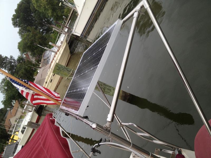

Aug 11, 2011
1,020
O'day 30 313 Georgetown MD
Here is how I have mine installed:see picture below
Thanks for the explanation. If I understand it correctly the controller is the master for distribution of all power. It must have a sequence manager built in, as it first recharges the batteries, then provides power to accessories where ever it finds them. That does not sound like a regular controller, must be a nice upgrade. Mine like Seadaddler's merely controls the power to the batteries and when full will shut off. Therefore any additional energy created is being wasted. Can i have a brand and model number of this upgraded controller to do some research? Thanks.

Kito: My panels are mounted off the stern rail on ss railing made into a rack for the panels
