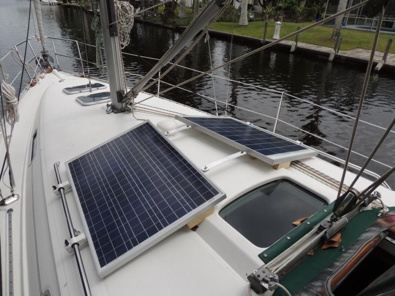

Would love to see a picture if you get a chance, Tom!
Here are a couple pix taken at noontime tday.
Just finished the basic mounts & put panels in place for the next steps. Still have to resolve how to hold upper sections of the panels firmly without drilling into structure or putting undue loads on the corners of the cabin top, at the same time securing the panels from weather violence. If I wasn't worried about wind getting under the panels and raising havoc, just letting them lie as shown in the picture actually seems pretty secure with just the clamps tightened.
Feb 6, 1998
11,759
The solar controller is the least of the worries in this installation. The location of the panels, & shading, will be the major detractor on solar performance.

Last pix a work in progress. These were taken yesterday. Strap across top = 1.5" x .125" aluminum bar (local big box store) like straps under panels; fasteners = ss storm shutter bolts threaded through tangs on panels with wing nuts (1/4 - 20); cushioning mat'l = seat cushion foam (would like something a little firmer and neater looking, but will do for now). The big deal in the setup is the Sea Dog Removable Rail clamps which make it all possible. I got them through LFS Marine & Outdoor, excellent people. They come in pairs but the ads don't stress that, so don't double up like I did.
