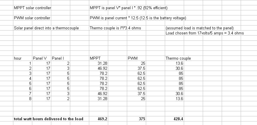

Here is a quick and dirty spread sheet showing a comparison of the power "delivered to the load" for a solar panel run through either a MPPT solar controller or PWM solar controller or directly to a thermocouple. I made up the solar panel power profile vs hour so keep that in mind. I didnt intend to pick it to favor one method or the other but it of course does. This doesnt take into account battery loss but for this profile you can see that the power delivered direct to the thermocouple is between the MPPT controller and the PWM controller assuming that the panel was matched to the thermocouple.
I dont know the details but the compressor coolers are supposed to be more efficient and that is not considered here.. But its a little bit interesting..

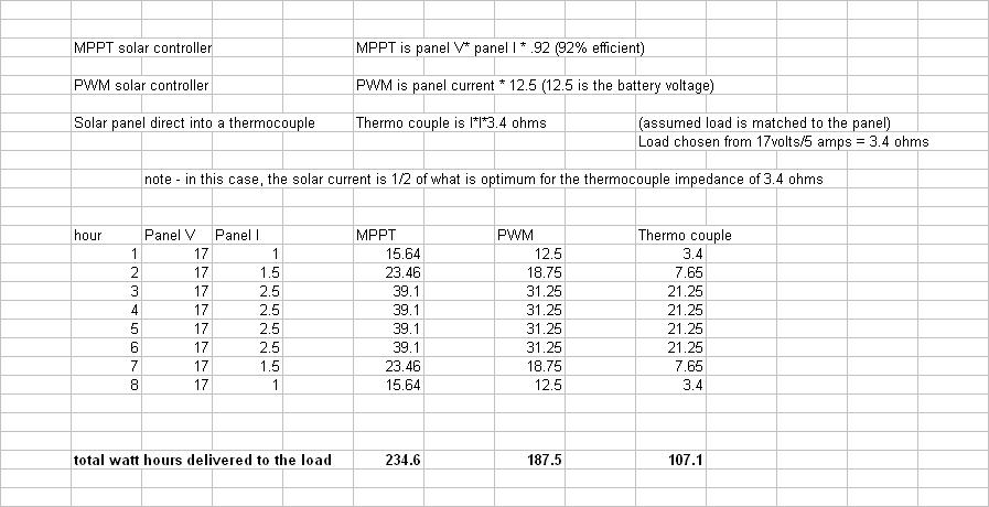

The down side of the solar to thermocouple.. this is the same spread sheet as before but the panel currents were cut in half to represent a cloudy day. The thermocouple impedance is no longer matched to the panel max power output and the power delivered really drops off compared to the MPPT controller which can adapt to whatever the panel max power point is.
