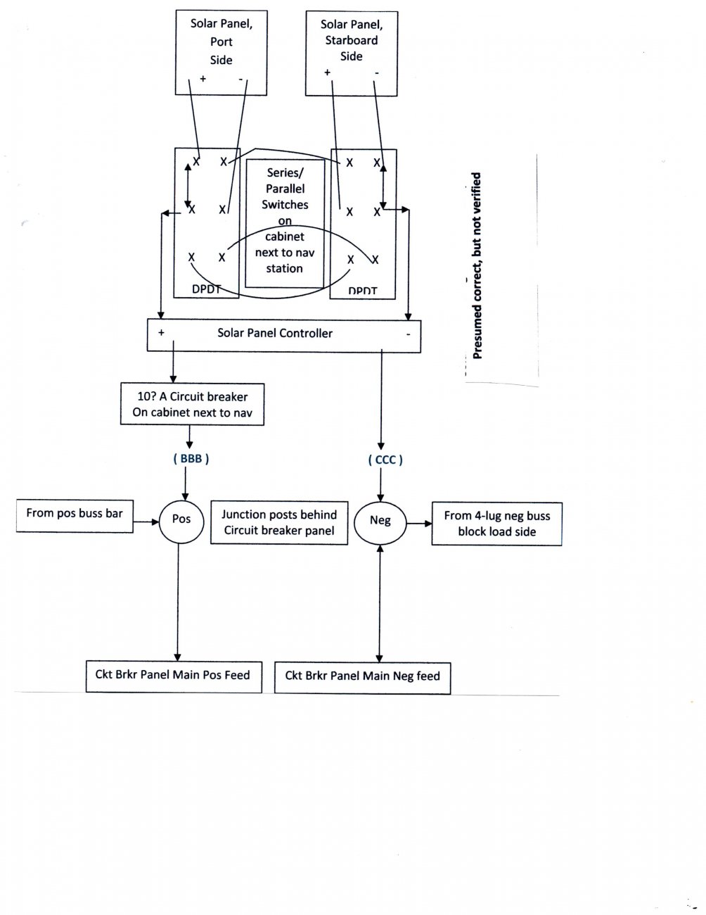

I placed my controller at the Nav station. I have 2 x 40-watt panels, so have a DPoffDT switch for each panel just off the nav breaker panel. I can switch the panels from series to parallel. Also have a breaker between MPPT controller output and the main DC panel, bridging the feed from the OEM battery switches..

Both switches up, series, both down parallel, either one in center, panel not online.
Thank you very much Ron. Greatly appreciate it!!
I have 2-24 volt panels in series so I can charge either the 48 volt propulsion bank or the 12 volt housebank. This wiring configuration would allow me to parallel the panels for the house bank & get more amperage out of them. Nice!
