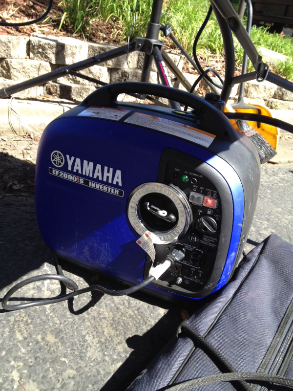

Every Tuesday is food truck day, and is best time to check out generators. Last week the organizer put up some music. I thought he was running off batteries so went to see what he got. I didn't hear this generator until I was close enough to take the attached picture. Almost silent. Couldn't believe it. It is also very small. If you want fridge and ample power for long trip, that's the way to go.
