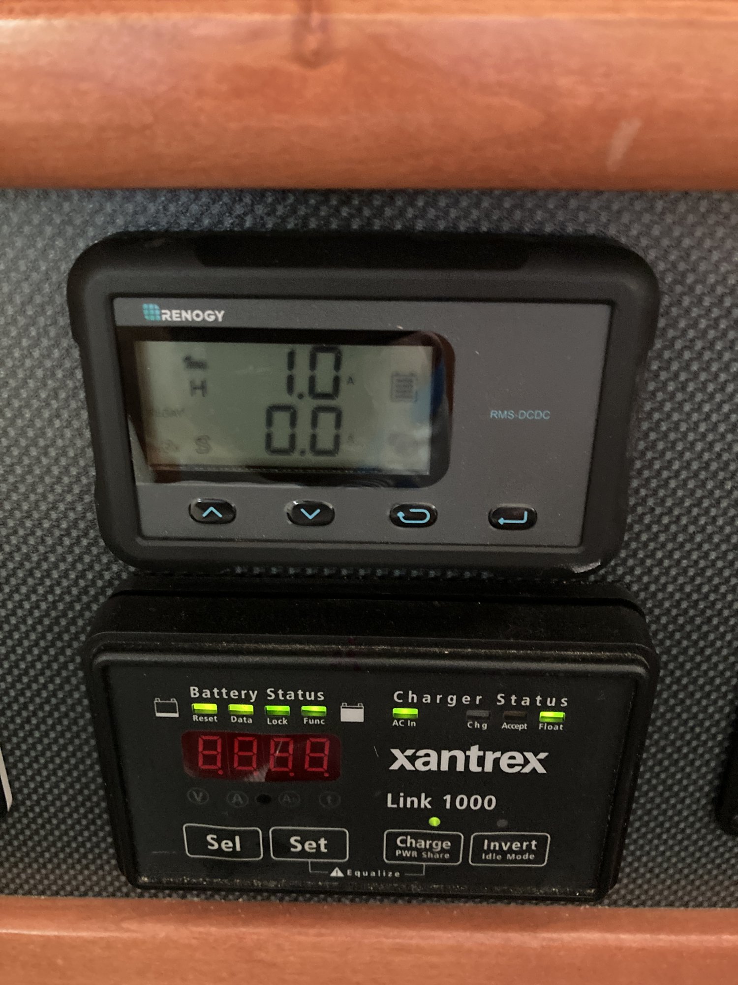

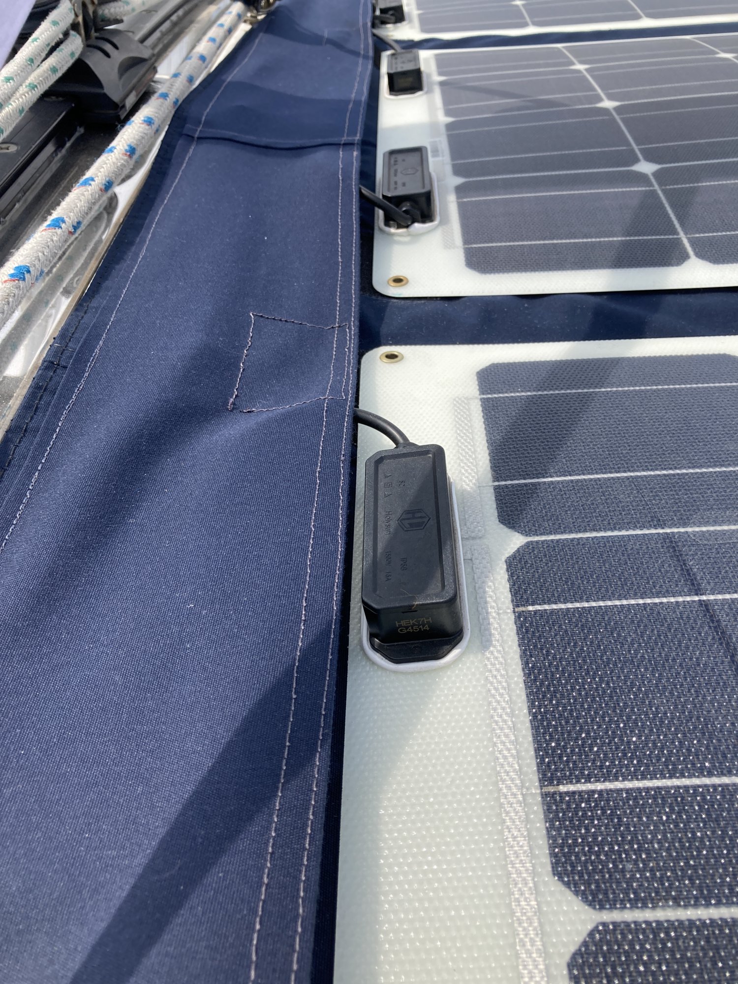

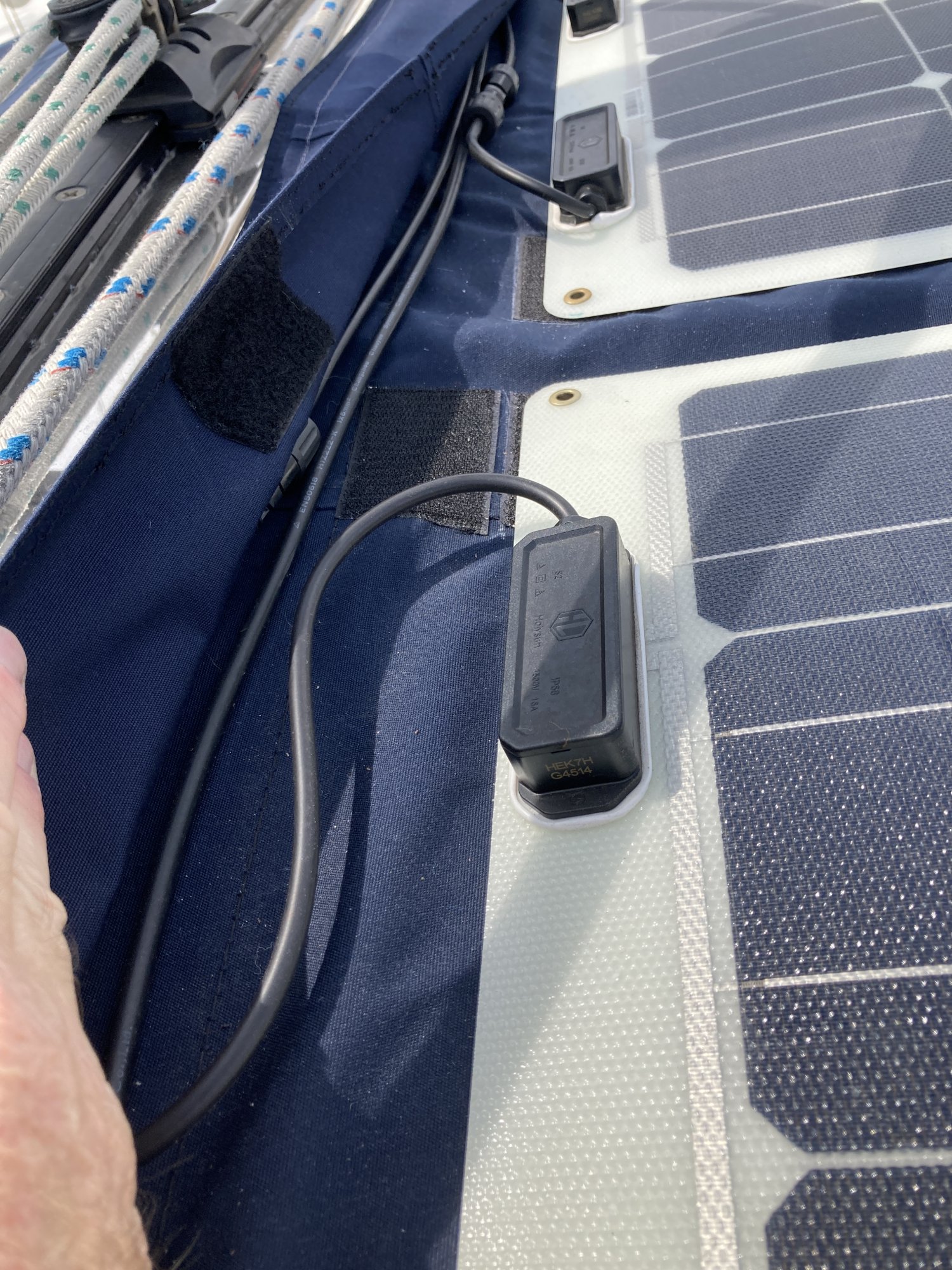

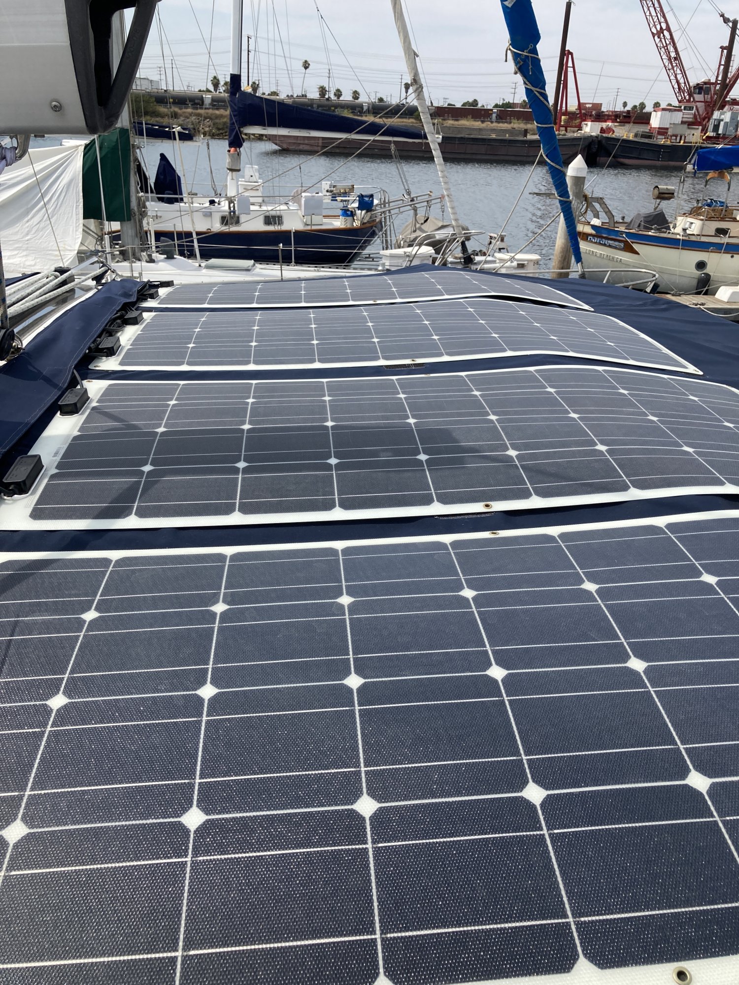

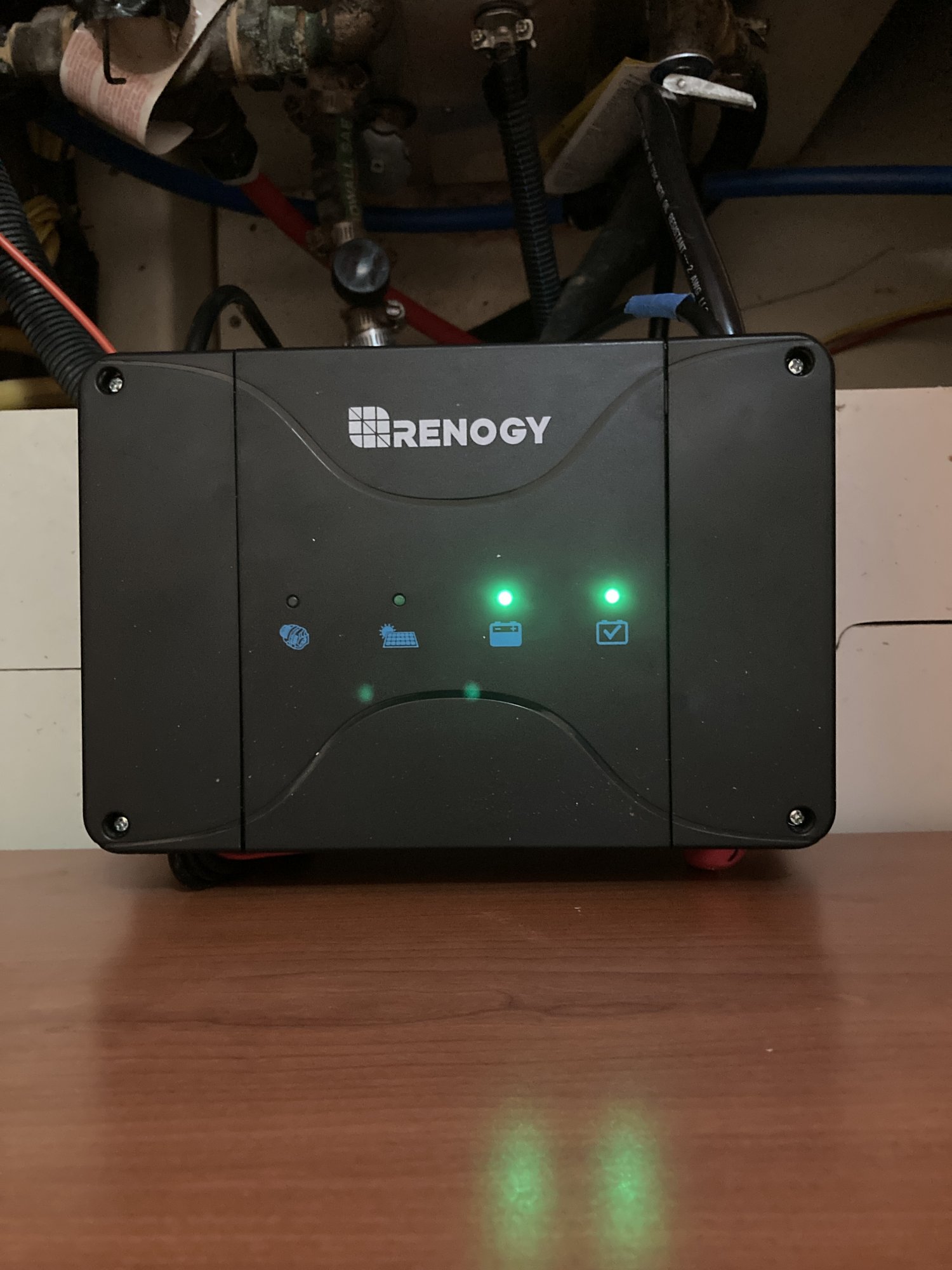

We just installed a Renogy system. Four 100 watt flexible panels on the Bimini. Ran the proprietary wiring inside the arch to an MPPT controller. We also mounted and plugged in a monitoring screen. The whole kit was plug and play. We only needed to make the wiring from the controller to the batteries. Renogy even sells the fuse blocks and fuses. Super easy to install. So far it is working beyond our expectations. We have a Hunter 49 with two refrigerators and two freezers. We are able to run them 24/7 on a mooring at Catalina while keeping the batteries charged to the fourth bar without running the generator. We also run lights, toilet, water pump etc. for short periods of time. We were worried about voltage loss because our wire run is really long, but no problem. The system works like a charm.

Yes, standard two stand alone fridges and two ice box type freezer/fridge units. Together, they can draw about 15 amps, but they are rarely cycling at the same time. I'm 5-10 amps in the positive for most of the day with the solar panels. In the afternoons, that goes up. overnight my state of charge sometimes drops to three bars, but is back to four by the next afternoon. I was very skeptical based on what I have read over the years, but the panel technology must have improved a lot recently because this system is powerful. One thing to watch out for is running your inverter. I noticed that devices running on the inverter, like the TV or charging the ebikes, suck a lot of energy from the batteries. Our main goal was to be net positive while enjoying full refrigeration on the mooring. This system does that.

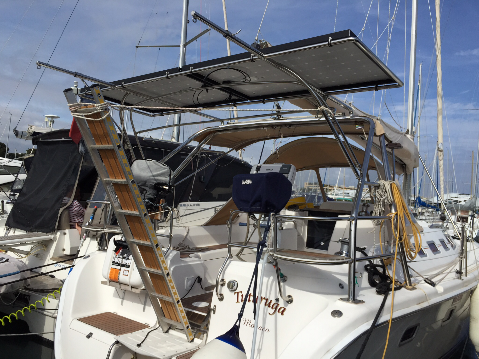

I have 2 Sunpower 327W hard panels in // on our boat with a Morningstar Tristar MPPT 45 controller, sailing in the Med. Installed house battery cap is 3x180 Ah. It is nice to run fridge and freezer non stop in the summer without having to worry about battery voltage.
Edit: Start battery is charged from house battery via an Echo charger.
