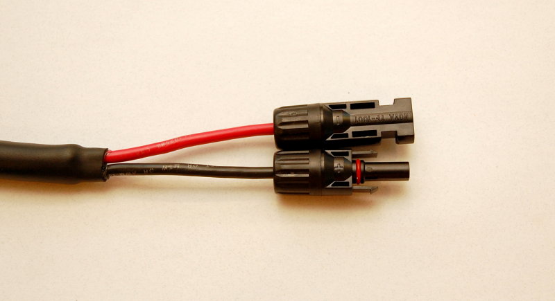

These are solar MC-4 connectors the FEMALE on the bottom and the MALE plug on top.. Today more and more solar panels are shipping with MC-4 terminals and less and less with actual junction boxes. I still personally prefer a water tight j-box, and water tight gland nut, but not all panels ship that way.
The MC-4 solar connectors are UL rated for 600V and 30A of current they are also IP68 rated which means they are fully "dust tight" and can be submersed to 1 meter and still retain water resistance.
They work well but on boats but if not carefully installed they can be a tad bulky and prone to being caught on things. That said, they are one of the better water tight electrical connections available for marine use. You don't have to use them only on solar connections and they could certainly be used for other applications.

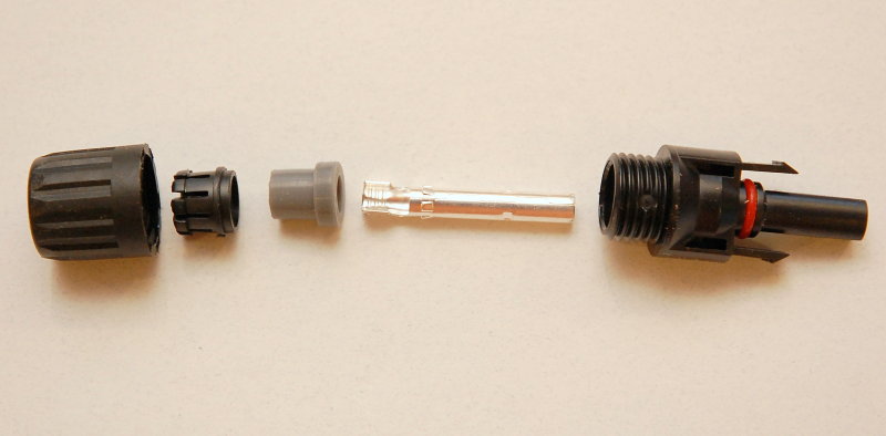

These are the individual pieces of the FEMALE MC-4 connector:
From Left to Right:
*Compression Nut
*Gland Compressing Ring
*Water Tight Sealing Gland
*MC-4 FEMALE Crimp Terminal
*MC-4 FEMALE Plug Body
MC-4 FEMALE / + Positive

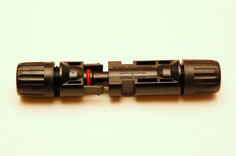

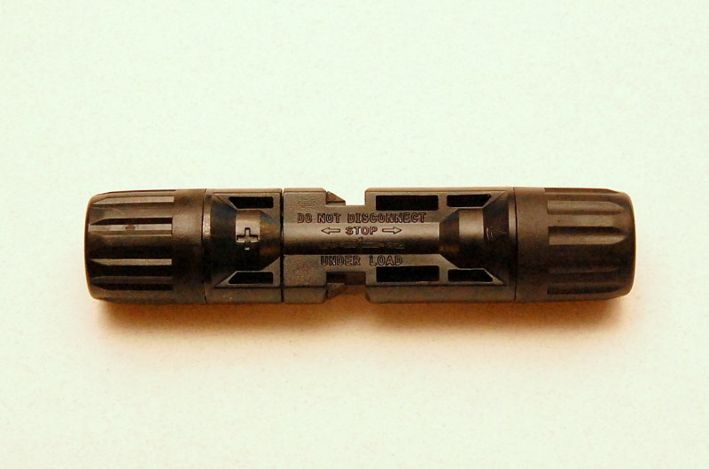

The FEMALE terminal on the left is ready to connect to the MALE terminal on the right.
FEMALE & MALE
I know it is confusing, the FEMALE vs. MALE with MC-4's, because the one on the left clearly looks like a MALE and the one on the right clearly looks like a FEMALE.
The terminology relates to the crimp terminals inside the plugs not the body of the plugs. The plug on the right has the small male "pin" and the plug on the left has the FEMALE barrel/receptacle.
Insert FEMALE into MALE
You just press them together until they "snap" closed.
Press & Snap Closed

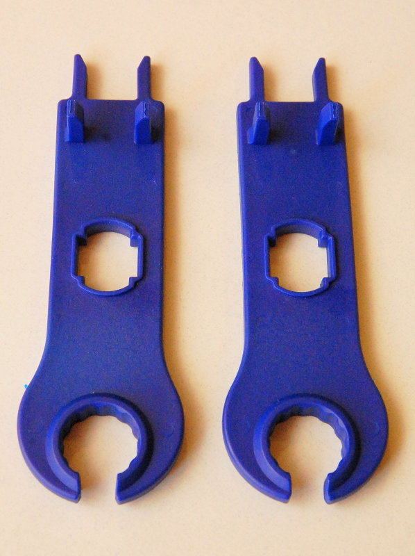

These are the MC-4 assemble and disassemble tools. They are inexpensive and worth having especially for taking the terminals apart after they have been closed.

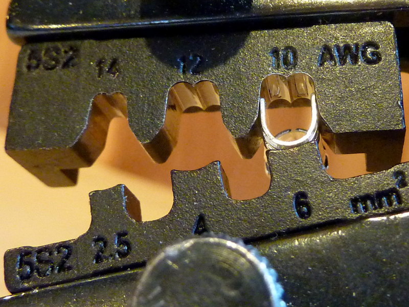

MC-4 Crimp Dies
Like a D-Sub crimp tool the MC-4 dies from Pro's Kit make a "butt-cheek" crimp. The die set is sized for 10, 12 & 14 AWG wire as well as 2.5 mm², 4 mm² and 6 mm² wire.
MC-4 Crimp Dies Closed

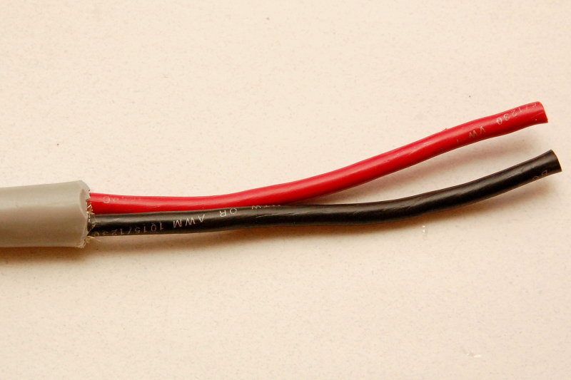

Here I have stripped back the outer jacket of the wire exposing the inner 10GA conductors.
Strip Outer Jacket From Cable

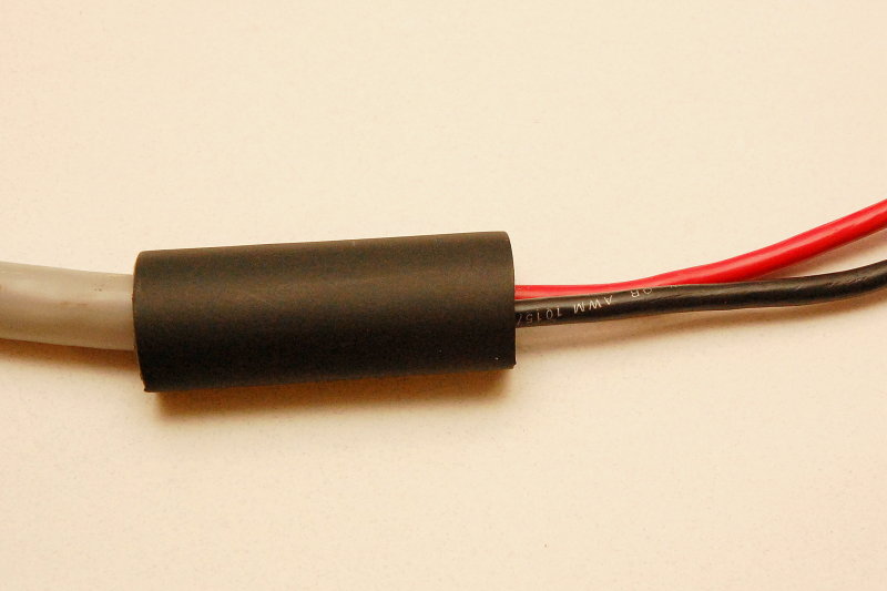

To give the wire a nice finished look, and feel, I slide some adhesive lined heat shrink over the wire before I install the terminals.
Slide Heat Shrink Over Cable

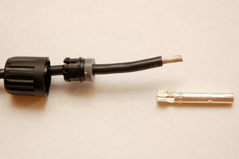

Next, slide on the compression nut, compressing clamp and watertight seal in this order.
Slide MC-4 Parts Over Cable
Now strip back about 1/4" +/- of wire. Be very careful not to damage any strands.
Strip The Wire
Insert the stripped wire into the crimp terminal and check your strip depth.
I prefer to have the stripped wire extend into the barrel of the terminal a bit so it does not "fan out" when crimped and create issues when inserting it into the plug body.
Check Your Strip Depth

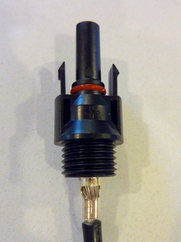

Once you've crimped the wire to the terminal you can then insert the terminal into the MC-4 plug body.
Insert Terminal Into Plug
Keep pressing the crimped terminal into the plug body until you feel it "click" into place. With some MC-4 terminals this is less obvious than with others.
Don't worry about mixing up the terminals and plug bodies because male & female pins will not fit into the wrong plug bodies.
Bear in mind that solar panels ship with the female plug shown here, marked +, on the positive output lead from the solar panel. This means the positive wire on your boat will get the corresponding male plug not another female plug.
Press Until It Clicks
