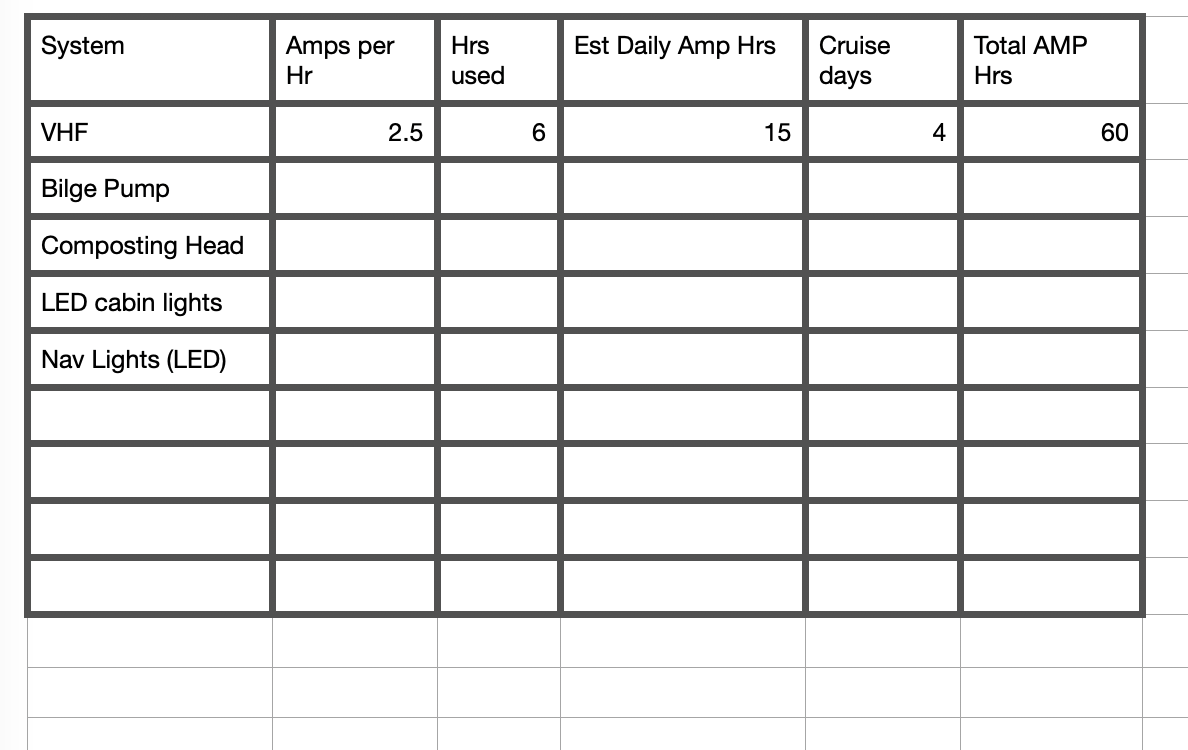

To answer this query you need to estimate the Amp Hrs needed. Then you can choose the correct battery for your needs.
I would like to put in a 100 or 200 aH Lithium Iron Phosphate battery, knowing that it will carry me through a 4-day trip without needing to charge.
Armed with an idea of your needs and consumption, you can now identify the type of charge system you will need to prepare the batteries for your next sail.
Or you can just buy some batteries and a solar charge system and see what happens.

24,926
You are correct in your approach, Stu.
Reading the OP's question, he stated his desire for a system that would last four days of cruising with charging at the end of the four days. Thus, a four-day consumption calculation is included to size his battery bank.
It is not as elegant as your spreadsheet; it is more of a directed response with a quick and dirty start to a specific solution.
A detailed solution is unattainable without the details of the systems consuming his battery bank charge.
