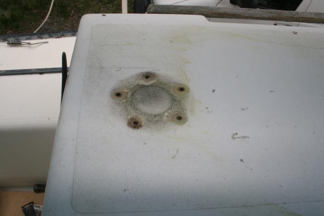

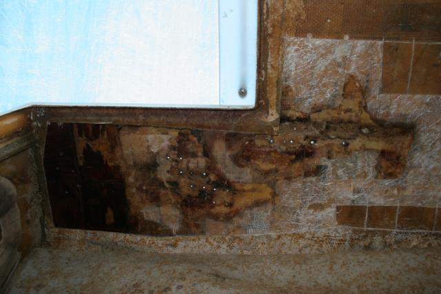

Re-bed your deck hardware, don't put it off. Beg or borrow a moisture meter.This is a view of the cabin ceiling where the halyard winch and rope clutches were mounted. After cutting out the inner skin, of course. And then one of what the winch mount looked like from above, i.e. not much of a bedding job. Even the hatch track screws were leaking.
So, how 'bout opinions on new core material to be patched in. Balsa as before and properly potting the fasteners? Any point is using foam core? I'm set up for West System.
