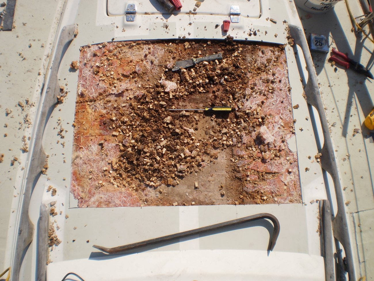

I have a 1978 O'Day 25. Core rot is a problem. I've chosen to make strengthening patches. Removing the Pulpit, cut the fiberglass under the pulpit attachment places. Remove and save the cutout. Then clean out as much rotted material between the layers as far in as possible. I used a pressure washer to clean out between the layers. Let is really dry out. Then get some fill material, lots of little blocks of wood impregnated with resin. Make sure that the thickness is correct to fit between the layers. I then mix up some resin and dip the blocks one at a time and insert them between the layers pushing them as far as possible into the cleaned out area. Keep going until the area is filled and inject some extra resin into the area. Replace and bond the cut out fiberglass let cure the replace the pulpit drilling new holes, and lots of backing inside.
I've done this with stantions with great success. There are some places that you cannot get to using this technique but is works for those areas that really need strengthening.

I’ve done something similar in re-coring sections of the deck of my 1979 Montgomery 17. I had been dreading this job and was torn between various approaches to the repair. The inside fix turned out to be relatively easy and mess free.
I cut out large pieces of the inner skin with a multi-tool and scraped out the rotten parts, leaving the skin intact. I cleaned and sanded the fiberglass skins in my garage, then epoxied on the appropriate thickness of end grain balsa core that I had ordered from Defender. After the epoxy set I trimmed the excess core from the edges of the fiberglass. Then I saturated each piece (individually, one per day) with slightly thickened epoxy and carefully brought it into the boat and put it in place. (Needless to say, I had removed the cushions and lined the v-berth with plastic sheeting to protect the cabin from spills.) I used a couple of bottle jacks and some scrap 2x4s to hold the section in place until the epoxy kicked. Repeated the process every day until all of the irregular shaped pieces were laminated in place and formed a secure deck. A little sanding and some touch up with epoxy and I was done. I will probably paint it or add a fabric headliner at some point but it is mostly out of sight so it might be a while.

Not sure I'm getting this "bracing" idea? You have two layers of FRP with a large gap between them. Bracing the bottom layer does nothing to stop the top layer from flexing down when stepped on. You will never be able to tighten the nuts as the deck will keep flexing until the two layers come in contact. You need to fill that gap with something solid that also bonds to both layers.

I concur. at the bare minimum any holes drilled through the deck to use for bolting on a below deck brace would need to be "potted" in order to make a small compression post to keep the bolts from pulling the two skins together and causing further damage. This should become obvious as soon as the first hole is drilled if the core is rotten.

You need to get the moisture out. Injecting foam seems it would capture the water an the wood would still rot. I suppose if it is small and you drilled holes on the underside to drain the water out then you could drill small holes in topside and use Git Rot, I had a small area on a bulkhead, about 2" x 4", and it worked well enough. Keeepi g the holes small will make it easier to fill then and cover up.
