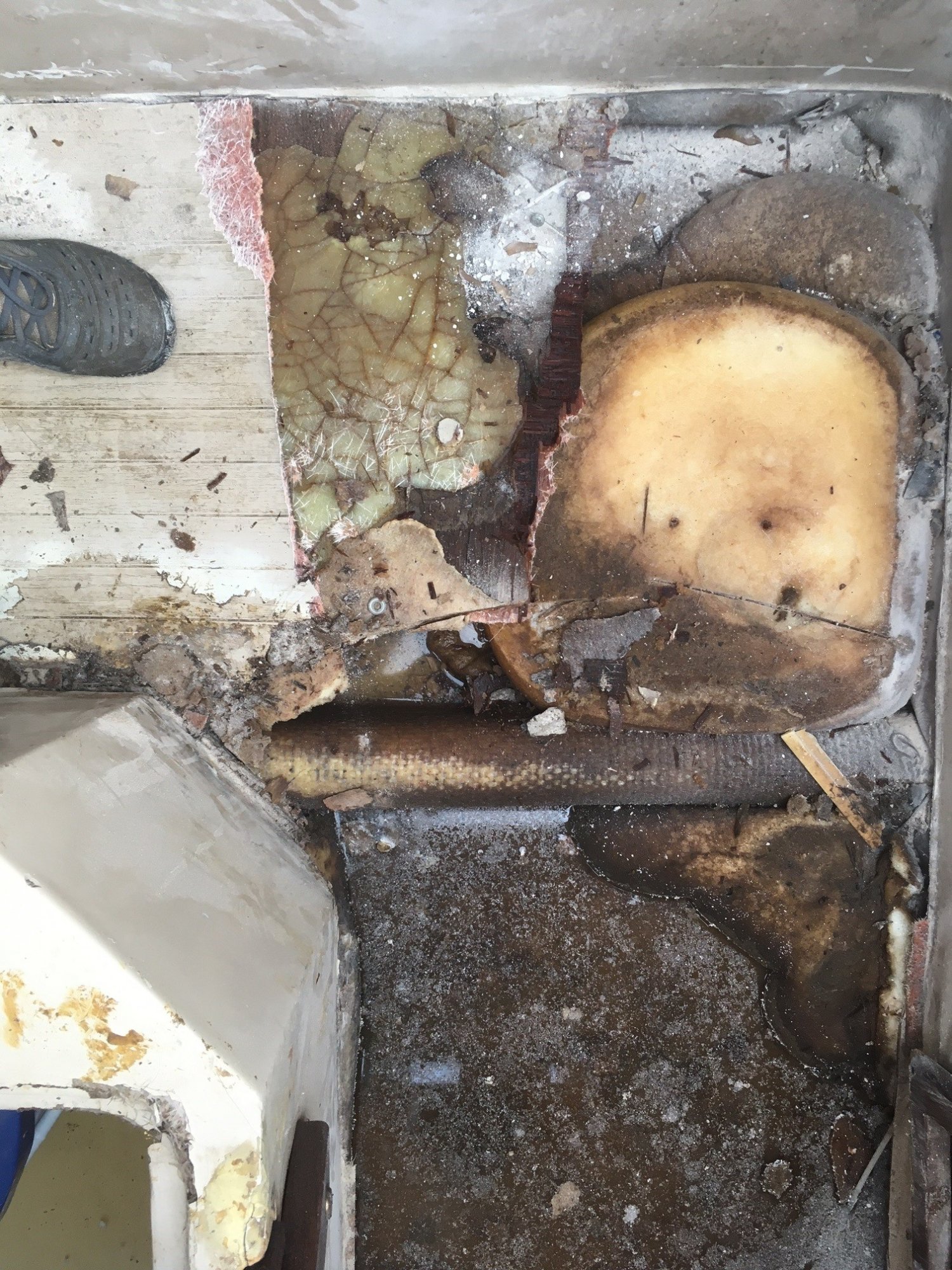

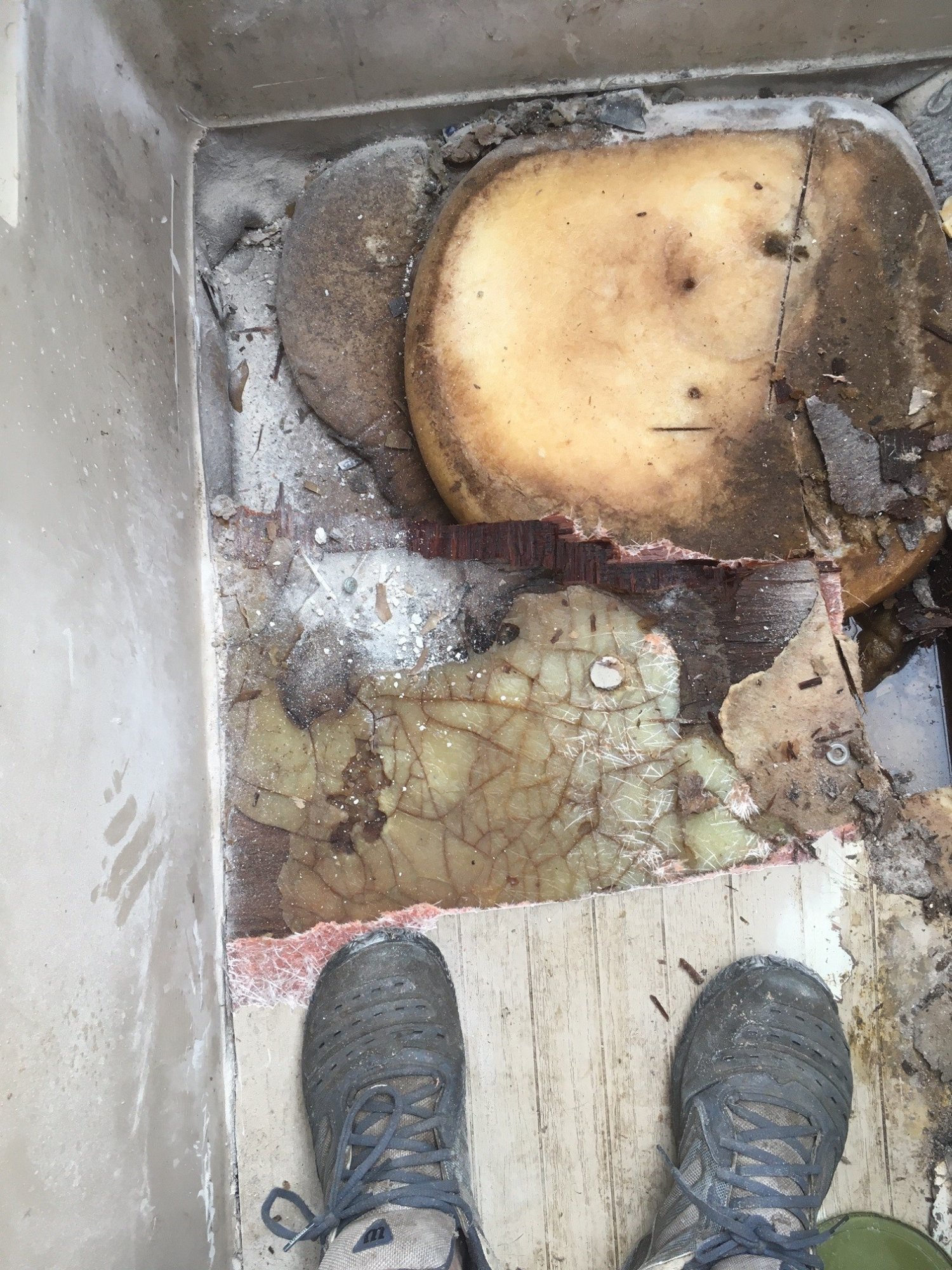

At the bottom of the steps, there was a rug cut to fit in place. There were two flat brackets screwed into the sole. These were put in attempting to bridge an unlevel floor due to varying degrees of rot beneath. They lifted straight up without even unscrewing them due to the rotten wood. I am no longer entertaining reusing the existing fiberglass cabin sole. I am using a rotary tool and an angle grinder to cut through the sole and a bit of wet, rotted wood around the edges of the entire floor area that gets walked on. The current mission is just to remove all of the wet rotted wood and the old sole, and give it a few days to a week to dry out and see what I am dealing with.
Jun 26, 2021
23
Catalina 25 Swing Keel Racine, WI

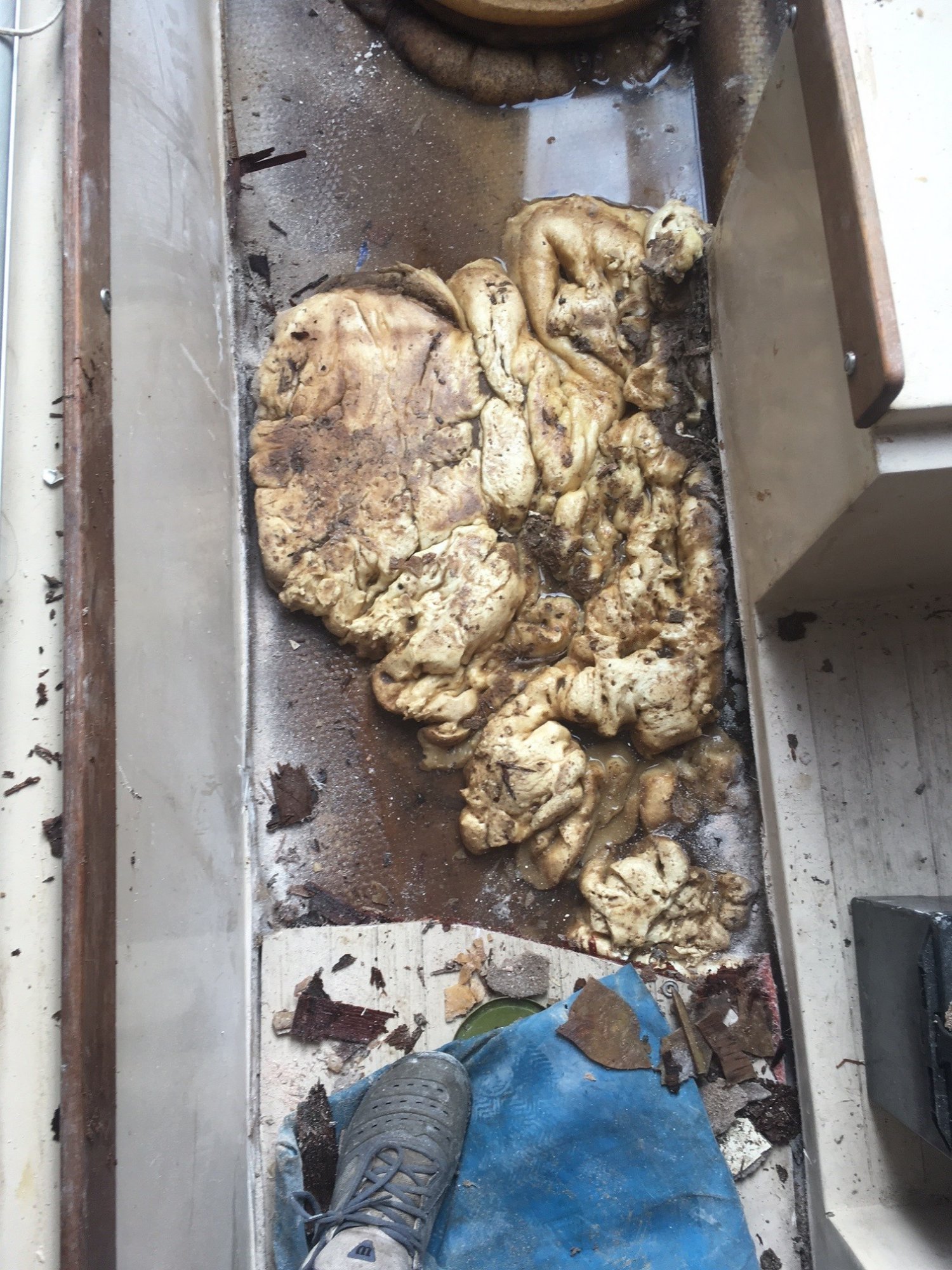

I cut the edges of the sole everywhen you can walk. Between the sole and hull I found what you see above. 2-3 inches of standing water in some places. Connected to the fiberglass sole was not even plywood. It was more like luan board. And then, for support, the luan lays on top of some kind of foam. But only in a few places. The support foam, which is very similar to expansion foam, in not consistently places between the luan and hull. It is just in a few places. In one of them, (the "brain" looking picture), the foam is soft. As you can see, there is nothing like a stringer. It is just hull and the horrible foam. So is the best plan to build some type of epoxy support stringer type braces that follow the contour of the hull and are level at the tops, and flange screw some type of high grade plywood into them and install fiberglass sheets over that and epoxy that to the fiberglass coming down the sides that meet the sole? Or should I find a similar foam product and use that to support the plywood, like it was?
May 17, 2004
6,136
Interesting. I wonder if that’s how it came out of the factory or if that was some previous owner’s attempt to stiffen the sole after it was compromised in some other way.
My concern with adding some kind of stringer would be adding hard spots to the hull.

I am pretty sure the foam was factory original, but I could be wrong. Would it be bad for the boat if I created and installed some type of epoxy stringer? Only 2-3 would be more than about two-feet wide, 3-4 would just be the narrow walkway between the setee and the seating bench. So are you sayng I should find and use some comperable type of foam to support the plywood ? While I am down to the bare hull on the inside, it is likely a good time to install my in-hull depth transducer
David, I am inclined to see that as a previous owner's attempt to address a "soft or squeaky floor like you do under a land based wood floor.
This is what I would have expected to see...
06DB0A12-DCA4-4A03-9F68-7C3EA500A962_4_5005_c.jpeg42F5AA7E-2EC1-45D9-B869-B53B3EF5D6D4.jpeg111E967C-C8E8-4A16-96C5-FFFA3C6DD70D_4_5005_c.jpeg
I believe the floor was part of the interior pan used to provide stiffening to the hull between the two bulkheads. The sole changes, as seen here in the images, at the forward bulkhead where the inside of the hull rises up in front of the keel stem to become the sole. Note that there are 2 ways to access the bilge under the table, in the floor, that looks similar to the images of this messages poster.
My guess as to what happened, water entered into the void under the floor. The foam soaked up the water. The floor pan appears to be a plywood base, laminated to the fiberglass beadboard pan. As seen in the above images the inserted foam soaked and compromised the plywood.
The images of the damaged floor show the rounded fiberglass part of the inner hulls mold that look like stringers. An intack floor could rest on the stringers, or what might improve and stiffen the boat would be to add cross stringers and then set the floor on top of the cross stringers. I would be inclined to use fiberglass not foam to create the stringers that way water would no longer get to the sole (flooring) material. The sub floor could be G10 or marine plywood as desired with a laminate on top perhaps even a vinyl water proof/resistant glue down floor. A lot of nice options exist.
Water will still enter into the void under the floor, so there should be limber holes that allow the water to move to the bilge and be expelled by a bilge pump.
At least that is my take of the issue.
