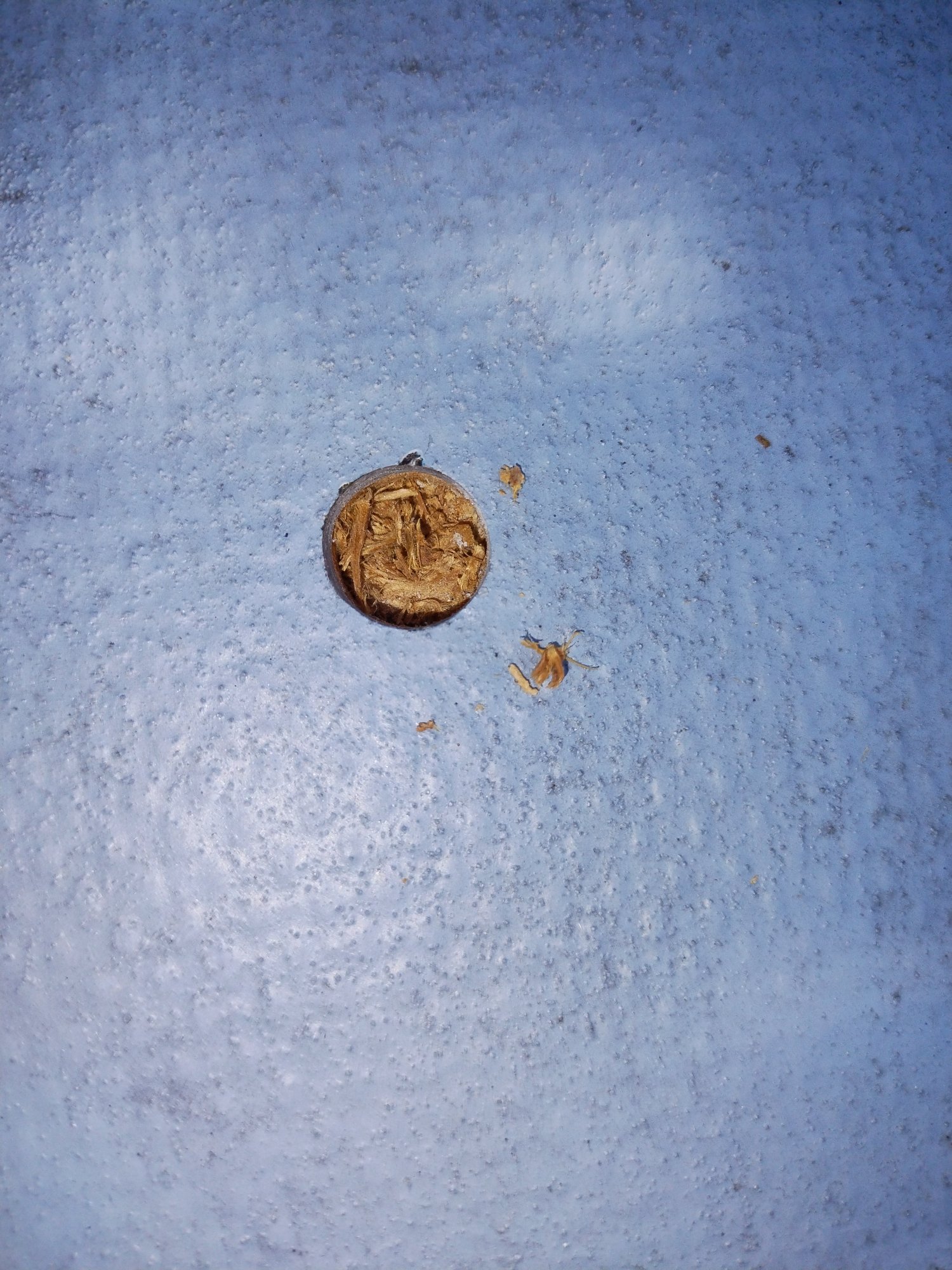

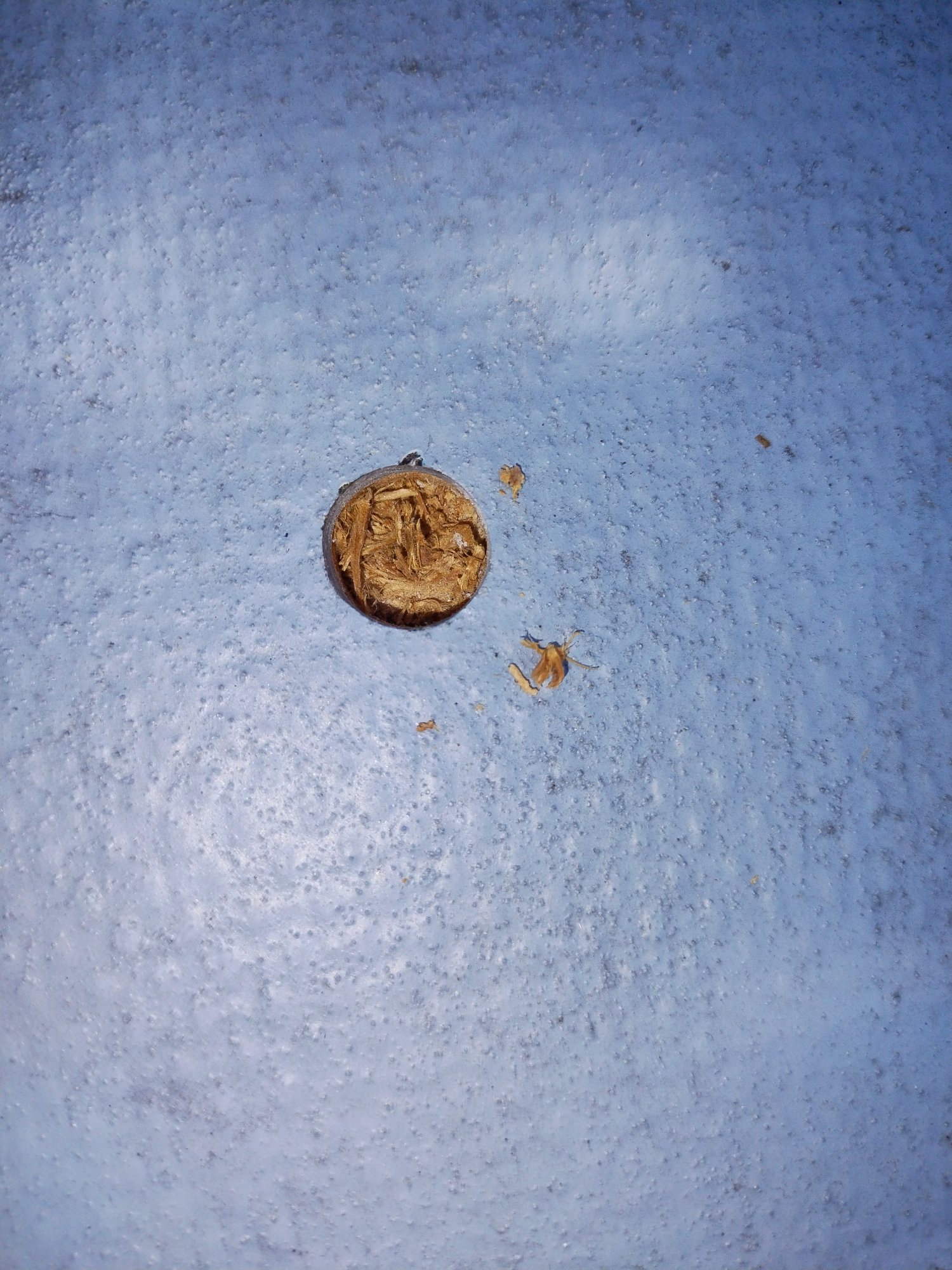

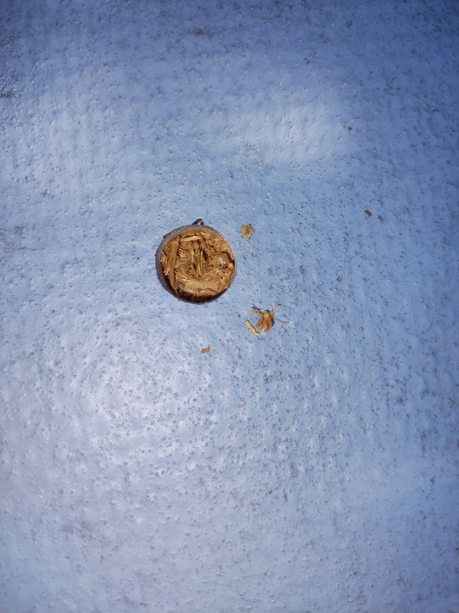

drilled two holes. The top deck has wood inside. However it is dry. Epoxyed the holes. Not going to worry about it.
14,293
The wood was hard and appeared dry.
Great! The wood looks like plywood which was often used as a core. One problem with large pieces of plywood as a core material is difficulty in getting the wood to bond with fiberglass. Plywood typically has large sections of hard grain, resin does not bond well with these sections. In between the hard sections are softer porous grain areas, resins can penetrate these areas and the glass bonds to the plywood. Over time the fiberglass separates from the hard grain areas, the deck feels soft because there is some flexing where the bond failed.
If this is truly disturbing to you, there is a fix. Drill a pattern of holes in the soft areas and inject epoxy into the holes to rebond the fiberglass to the core. This is a good fix if the deck will be painted, otherwise there will be a bunch of visible epoxied filled holes in the deck.
