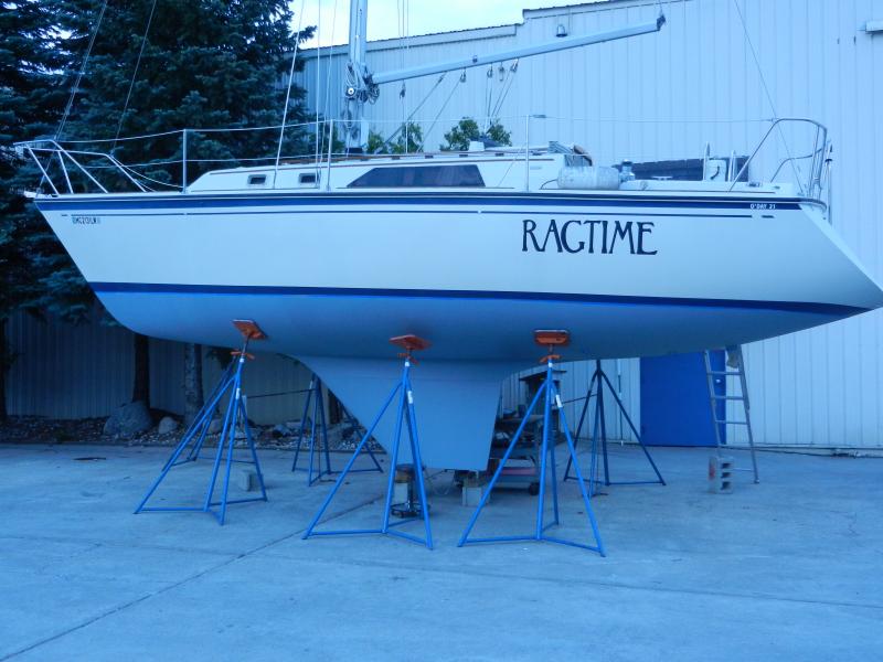

A barrier coat such as Interprotect will require 4-5 coats to be effective. The window between coats has been lengthened over earlier versions, and it is quite easy to get the job done correctly. The stands can be moved between each coat to assure a "seamless" finish. Alternately, a couple stands can be lowered a few inches on each coat - different ones on the next coat, etc. A little planning and all goes smoothly. See pics of this job from Summer 2013.
Contrary to some advice posted, the barrier coat is NOT built up while still tacky. That will get you into a gawdawful mess. Successive coats are applied while the previous coat is CHEMICALLY active, but dry to touch. (a thumbnail should not be able to scratch the previous coat) This is the WINDOW. READ THE LABEL.
