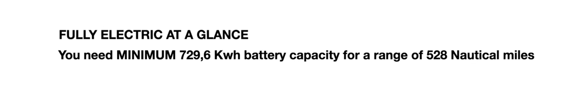

Ok, so if we do the math, he needs 730 kWh to go 528 nm. Let's do the math, that is 730/528 = 1.38 kWh/nm. What we don't know is at what speed he is traveling. What we should know is power consumption is not a linear function for diesel or electric.

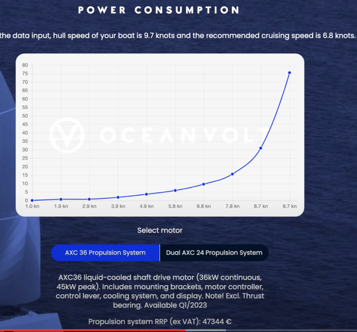

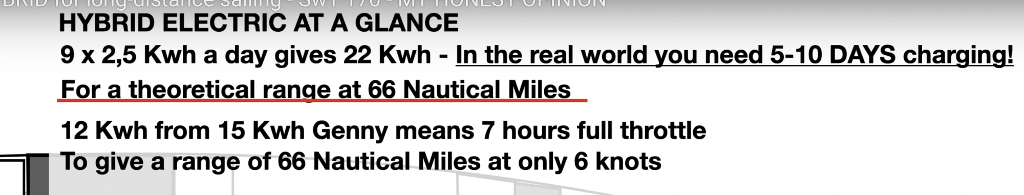

He claims he can only go 66 nm on a full 22 kwh charge. I really have no idea how he is coming up with that number. I went to the Oceanvolt Website and looked at their calculator and estimated the WL and displacement of his boat, my numbers came up with a hull speed of 9.2 kt and a cruising speed of 6.4, close enough to Thomas's. At 6.4 kt the engine consumes 8.78 kw, which would burn through 22 kWh in about 2.5 hours while traveling 16 miles. Slowing down to 4.6 kt power consumption drops to 3.4 kw, about 6.5 hours of travel time for a range of almost 30 nm.
None of this should be very surprising, we all know or should know the relationship between power/fuel consumption is not linear, it is curvilinear, power/fuel consumption increases faster than speed. If you go into considering electric propulsion without knowing this relationship, then you haven't been paying attention.

He stated his current panels produce 2.5kWh per panel on a good day, and if he increased to 9 panels he could theoretically generate 22kWh in a day. He isn’t saying that 22kWh will get him 66nm, but that with 5-10 days of charging he could generate enough to fully charge the three 30.4kWh batteries in the recommended Oceanvolt setup… and that is enough for 66nm. He is probably accounting for other house loads and days with lower production to get the 5-10 day estimate.
Also, his boat does not have electric propulsion, it has a Yanmar with fuel for 1000nm range. That was the point of the video… Range=Safety. The money he spent was on the solar installation, and that is what isn’t performing as well as in the Med or Caribbean.
