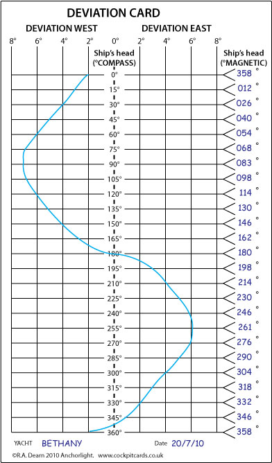

as for GPS and compass agreement, I've always found that my GPS course and compass agree quite well once you account for variation, deviation and current.
And for those whose GPS and compass do not agree, it is a very simple fix. Either learn to swing your own compass or call the guy who does it locally.
Every prudent sailor should have a fairly recent deviation card for their compass aboard.

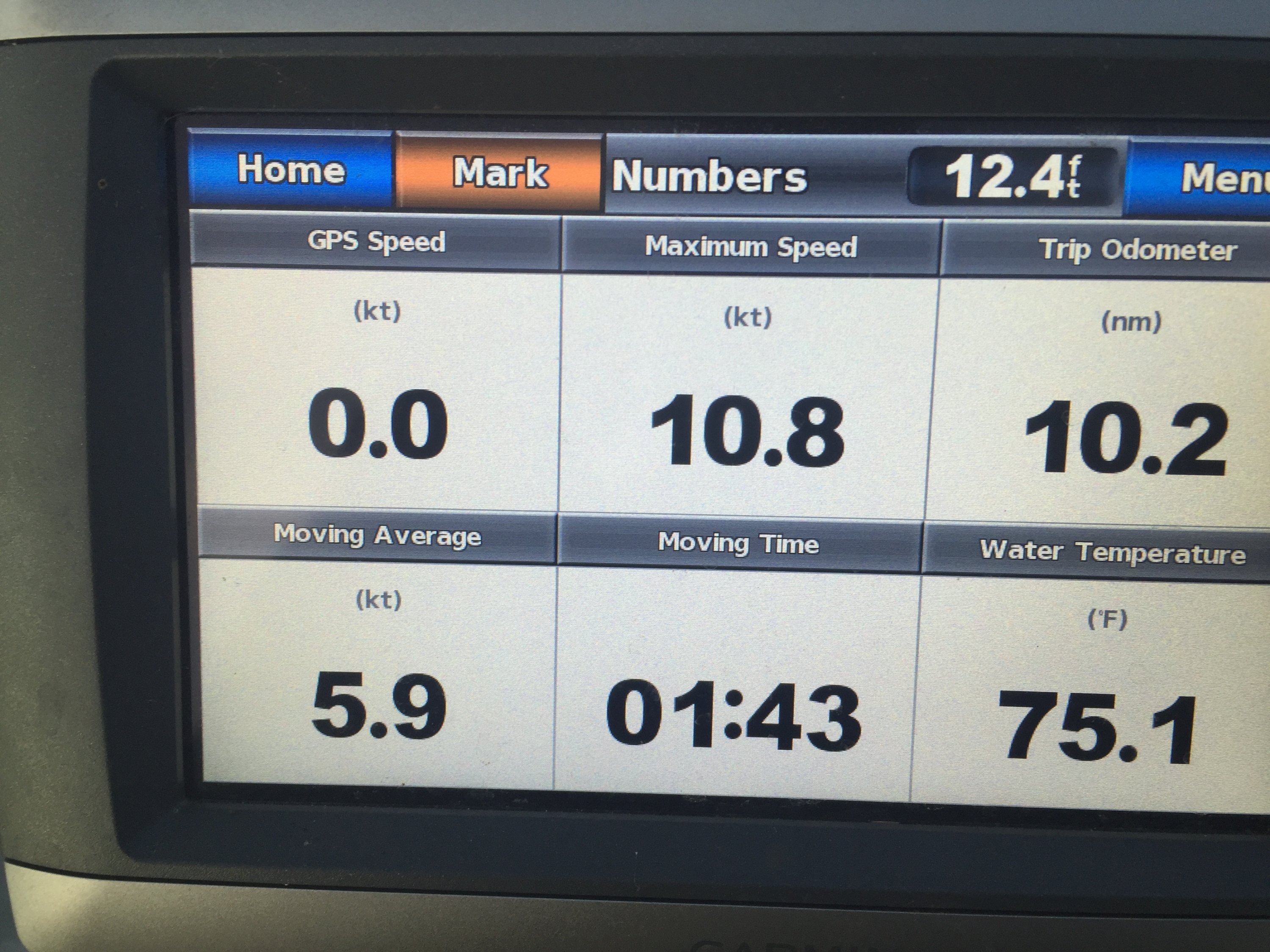

Was out Wednesday night in 22knots of wind and 8-9 foot waves. Reefed jib only.
Quite a wild ride.
"Surfed" down a wave for the first time, and recorded 10.8 knots !
Not sure how accurate that is, but it sure was an exhilarating sail!

Very cool, walmsleyc. Thanks! You and dlochner make it clear that there are indeed currents in the Lakes. That should answer Greg's question about which is more accurate: GPS for speed over ground, the log for speed in mobili (for Verne fans).
I'd bet that Greg's top speed number was derived in a more reliable way in the Garmin than in the iPad. Are there any Apple techs here who can tell us how an iPad does its GPS thing? It might depend on how the boat was pitching (as SFS pointed out) at the moments the iPad took its bearings.

another comment on compass and GPS. I like the format of capta's deviation card but find that I usually know the magnetic course I want and need what compass course I should steer to get it. Having all the magnetic courses "jumbled up" (598, 12, 14, 26,.... etc) and the compass courses all nice an neat (0, 10, 20,...etc) makes that a lot harder. I prefer having all the magnetic coursed nice and neat so I can easily interpolate the course I need into a compass course to steer. capta's format is handy to shoot bearings with however so I'm thinking would want both formats.
