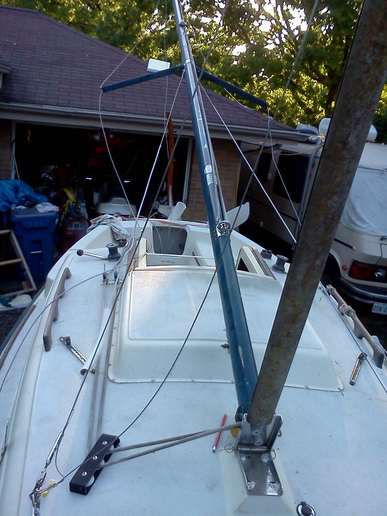

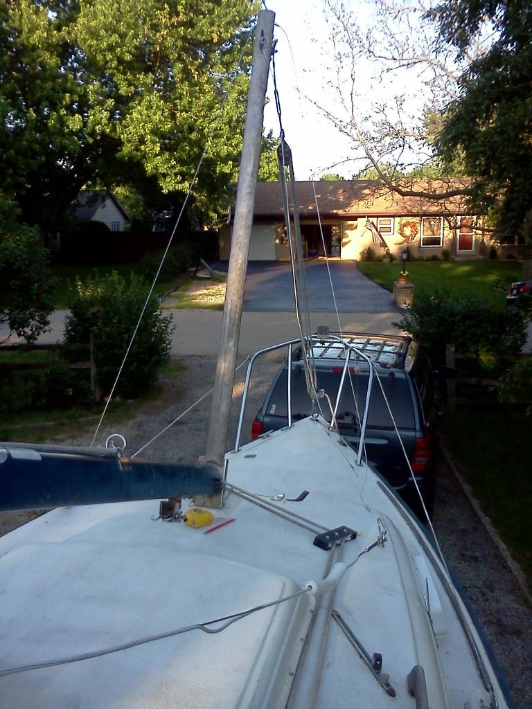

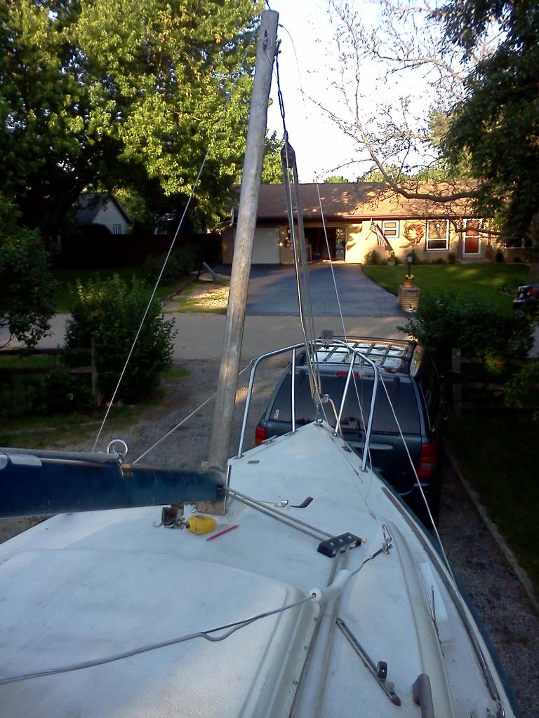

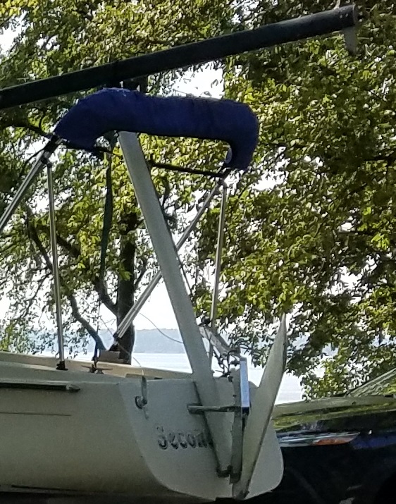

To catch my mast, I had a section of 3 inch PVC pipe that would shove into the rudder mount. I mounted a bow roller to the end for the mast to sit on. This worked for the most part, but it really needed guides to keep it on the roller, as it would tend to steer off as you pushed it back. For mast raising, I had an old section of a broken boom that I cut the end, so it would sit on the mast step. To stabilise the mast while raising, I put two U-bolts up through my cabin, where I could clip the baby stays onto. The gin pole was also cleated to the same u-bolts. The mast would move a little side to side, but not bad enough to stress anything. To raise it, I used the main sheet. The nice thing about that is, I can cleat it at any point and untangle lines that inevitably get caught when raising it. I can easily do this by my self with a 28 ft mast.
I will also mention, the PVC pipe I used to rest the mast on was also used for transport. This was one less thing I had to do to after arriving at the ramp. From the time I parked the car, I could have my mast up within 10 minutes.

To catch my mast, I had a section of 3 inch PVC pipe that would shove into the rudder mount. I mounted a bow roller to the end for the mast to sit on. This worked for the most part, but it really needed guides to keep it on the roller, as it would tend to steer off as you pushed it back. For mast raising, I had an old section of a broken boom that I cut the end, so it would sit on the mast step. To stabilise the mast while raising, I put two U-bolts up through my cabin, where I could clip the baby stays onto. The gin pole was also cleated to the same u-bolts. The mast would move a little side to side, but not bad enough to stress anything. To raise it, I used the main sheet. The nice thing about that is, I can cleat it at any point and untangle lines that inevitably get caught when raising it. I can easily do this by my self with a 28 ft mast. View attachment 186853View attachment 186854

As far as the PVC goes, do you have a better picture. I can't quite make out what you have. I have 2 small gudgeon mounts on the back for my rudder.

I see that you have the tilting base for your mast. My boat has just a bolt that goes through two side pieces of metal. I don't know what it technically is called, but I have thought of replacing what I currently have with one like yours. I think the tilting mast base will help keep the mast more straight while I raise/lower it.
I'm not sure I would trust the pivot bolt to keep the mast straight. A small amount of crosswind, when trying to raise the mast would probably rip it out of the bottom of the mast. You really need to have either baby stays or make some temporary short side stays (guy-wires) to stabilize the mast. You can always rivet small loops to the sides of your mast to clip the stays to. Make sure the loop is large enough for a carabiner to clip your guy-wire to. You want this to be fast and easy. Since these only stabilize the mast while raising, they don't need to be super strong.

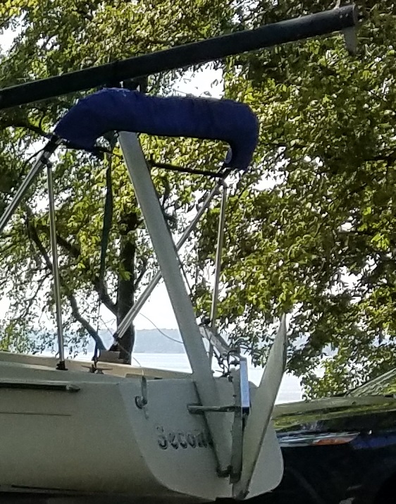

I don't have a good photo of the bow roller in the top. I just used two stainless brackets to screw it to the end of the pipe. My photo shows that the rudder mount has a loop where I could shove the PVC pipe down into, to stabilize it. If I did not have that option, I would probably just cut a vertical slot in the pipe so it is U-shaped around the tiller and have it go down over the length of the upper portion of the rudder. Use a ratcheting strap to keep it from falling off the rudder.
Thanks - Mine has a flat transom with two holes, for lack of a better term. The rudder has two posts, again for lack of a better term, that slide into the holes.

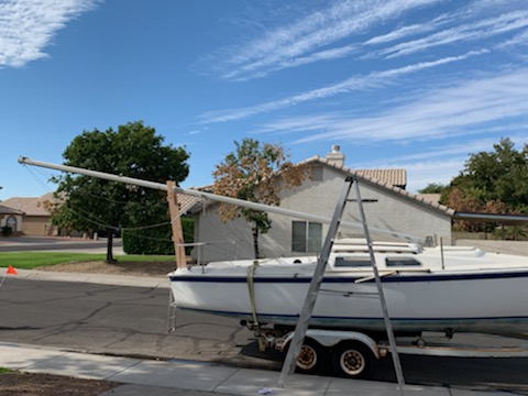

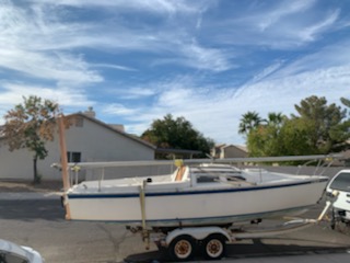

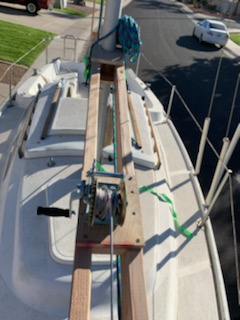

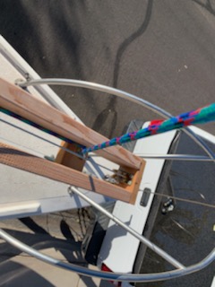

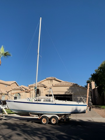

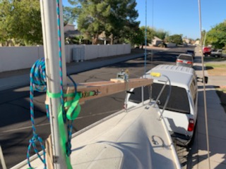

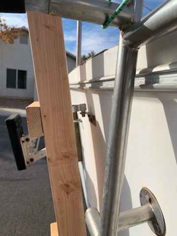

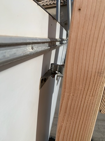

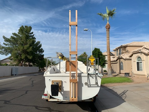

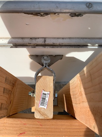

I now have a couple of contraptions that I made to get the mast up/down a lot easier. I still have a few things I need to add to make it better, but the concept works and wasn't extremely hard to fix.
A couple of issues I need to address - need to add a strap to each side of the mast and down to the boat for better side to side sway stabilization. My wife was able to hold it fairly steady, but I want to make it a little better for that. Secondly, the strap I have that holds the gin pole to the mast is not good enough and will allow the gin pole to slightly tilt - it works, but I have a good idea on how to get rid of the strap all together and won't take much work.
I have attached pictures - first time on this site.

Nice mast stepping system. A few things that might make some improvements
  • I assume your gin pole is tilting to the side that has the ratchet/buckle on it. You could start out with the gin pole tilted in the opposite direction to compensate, add a second ratchet strap with the ratchet on the other side or you could make one strap with a ratchet at each end. Dual ratchets allow you to balance things out as the ratchets pull the pole to one side or another
  • If you have a hard time getting the mast on top of the ladder, extend one of the horizontal "steps" or "rungs" past the verticle 2x4's. This would give you a resting place to allow you to step onto a higher part of the boat
  • Put some carpet samples or scraps on the ladder where it touches the mast. This makes it easier to slide the mast back and forth when attaching it to the tabernacle
  • I'll often use a line or strap attached to the cabin top handrails as a safety when I'm attaching the mast to the tabernacle. It's pretty loose but it's enough to catch it if I let go of the mast. My mast teeters on my stern rail during this process
My gin pole is actually really straight to the mast, it is actually tilting forward a little once I start to turn the wench. No problem getting the mast on the holder/ladder, it is actually fairly easy to do that part. I have a large roller on the top so I can slide the mast towards the rear. Thanks for the post.
It sounds like it'll be a pretty nice system when it's finished

I think the gin pole setup will work, I wish I could have just bought something at a reasonable price. I am sure you are right about the line size for comfort, too bad everything I have to replace going forward will cost more now.
Sep 20, 2014
1,330
Rob Legg RL24 Chain O'Lakes

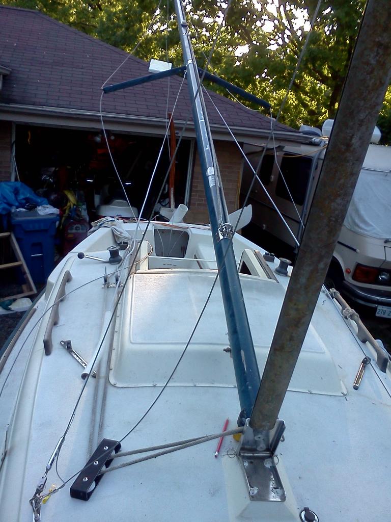

What is the purpose of the extra winch on the gin pole? Why wouldn't you just clip your main sheet and fiddle blocks between the forestay and the bow cleat directly. There is enough leverage gain in the main sheet to easily lift the mast. You can also cleat it incase you need to stop part way up and untangle a line. Once the mast is up, use the jib sheet to keep it upright so one can clip the forestay to the bow cleat.
The other thing I've sen done is use the boat winch on the trailer tong to lift the mast. That is a little more cumbersome, but at least it doesn't add weight to the gin pole.
Wood seems a bit heavy to use for a gin pole. I'd probably buy something like this for 20 bucks:
This is very similar in size and thickness to the boom section that I use to lift my mast. My mast was 27 ft, so it should be similar weight to what yours is. I just like to keep things light weight because I can work much faster. When its 95 degrees out, I want to take as little effort as possible to setup the boat. Using the main sheet to raise the mast also means less stress on the gin pole, so it does not need to be super heavy.
