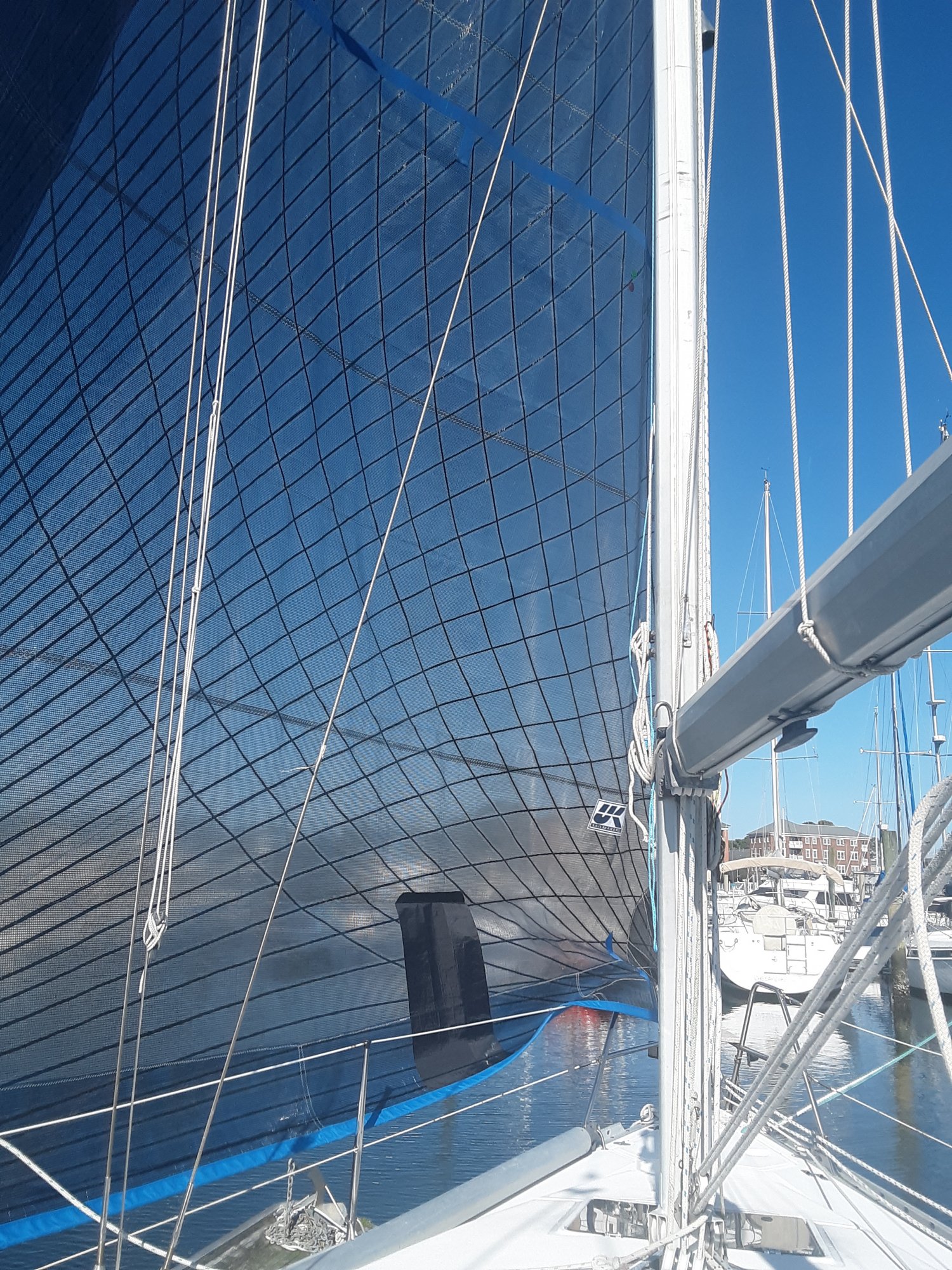

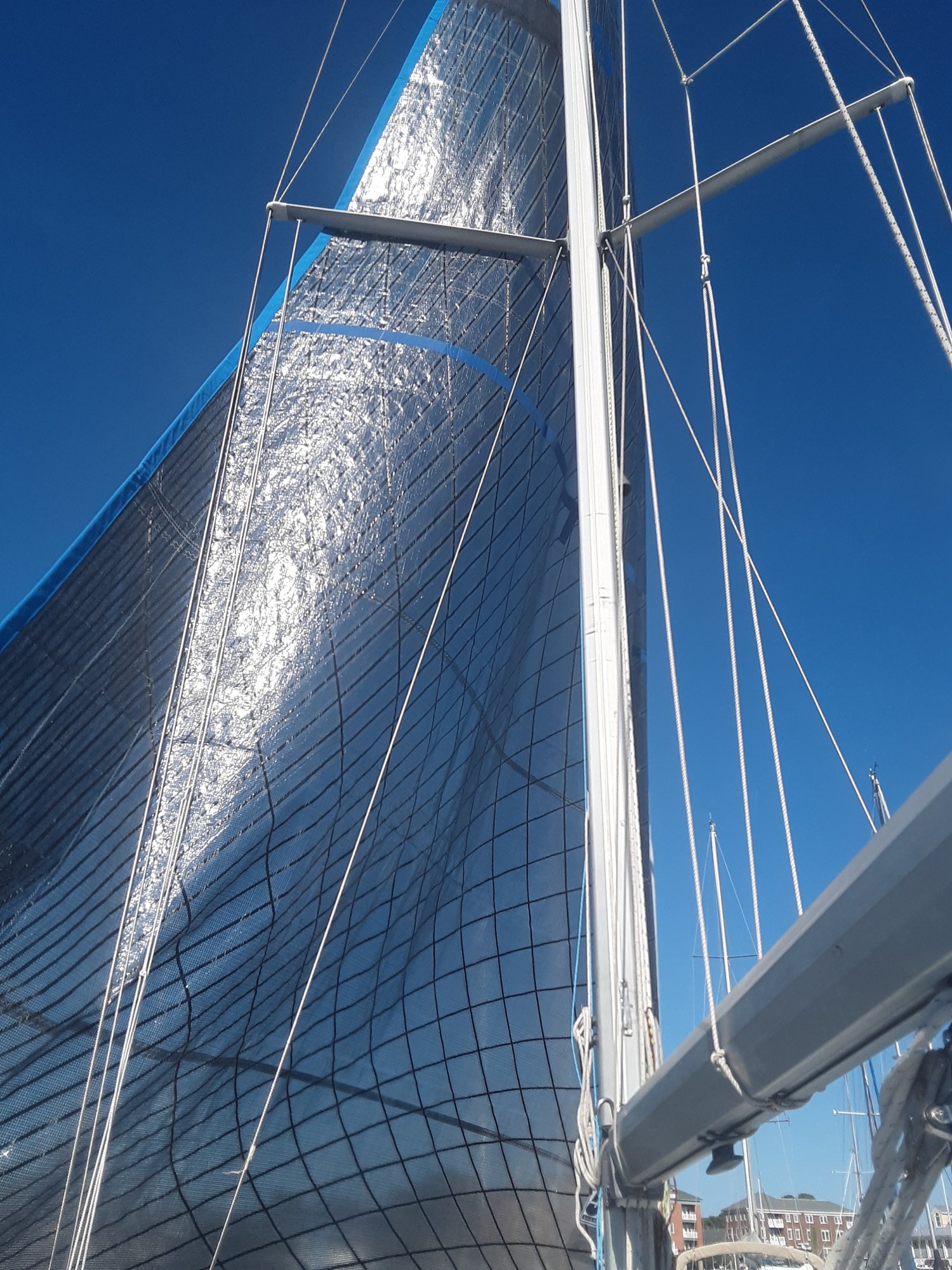

So I got these new sails the other day. I club race so i was looking for a good light wind sail. Seems to me its plastic glue and those thick lines that looks like fish not stocking is actually a sticker i peeled at it and played with it. Am i really only gonna get 5 yr out of this sail till it dies?

I bought the sail used so I dont know of its taffeta or lite skin I'll take a close up photo but it a sticker those black lines are a sticker so hoping someone knows what type sail skin this is

hard to see from the photos, but because it is a 'deck sweeper', it gets into your life lines, which is normal. hoist the sail as far aloft as you can. maybe a soft shackle at the tack to get a couple more inches off the fence. in racing, every little detail counts.
Id expect the sail to be completely inside the lifelines when close hauled, at least it is on the boats I’ve crewed on. Assuming that’s the case I think the standard practice is to get the sail as low as possible, to lower the Center of Effort and maximize the end plate effect from the deck.

I don't think there's any "skin" at all on that genoa. I can see through the genoa well enough to see colors and shapes of things hidden behind it.
You can't see anything through a LiteSkin, not even telltales, or sail numbers, not even if the sun is behind the sail.
With a tafetta skin, you can see shadows on the sail and the contrasting sail numbers.

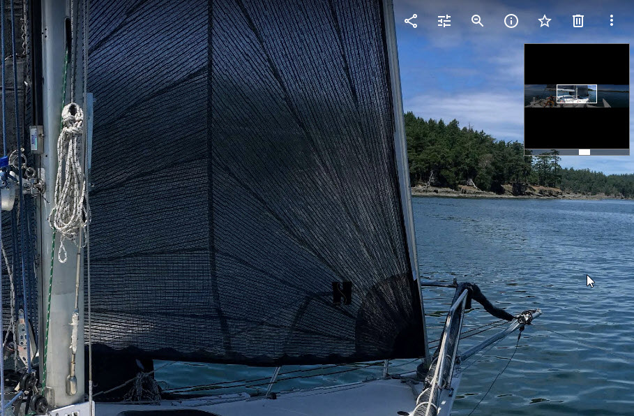

The pic below is a black aramid laminate with a single tafetta skin - with the sun shining behind it. You can not see the top of the ridge through it. It's a Contender product from 2017.

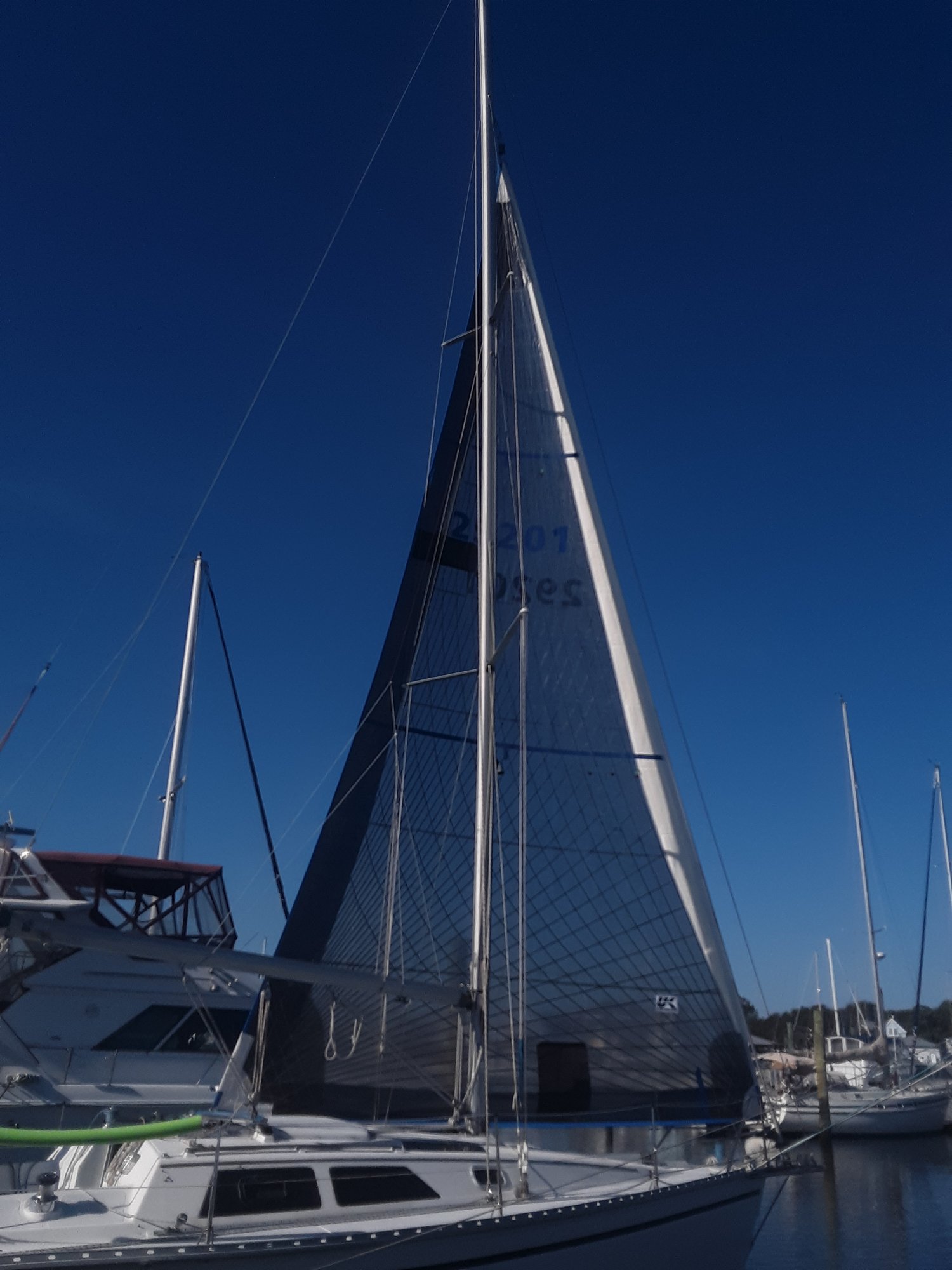

Below is a carbon/aramid laminate genoa without a skin, with the sun shining through it from behind. It looks just like the genoa that the OP posted. It's a Dimension-Polyant Carbon Sport without a skin from 2017.
