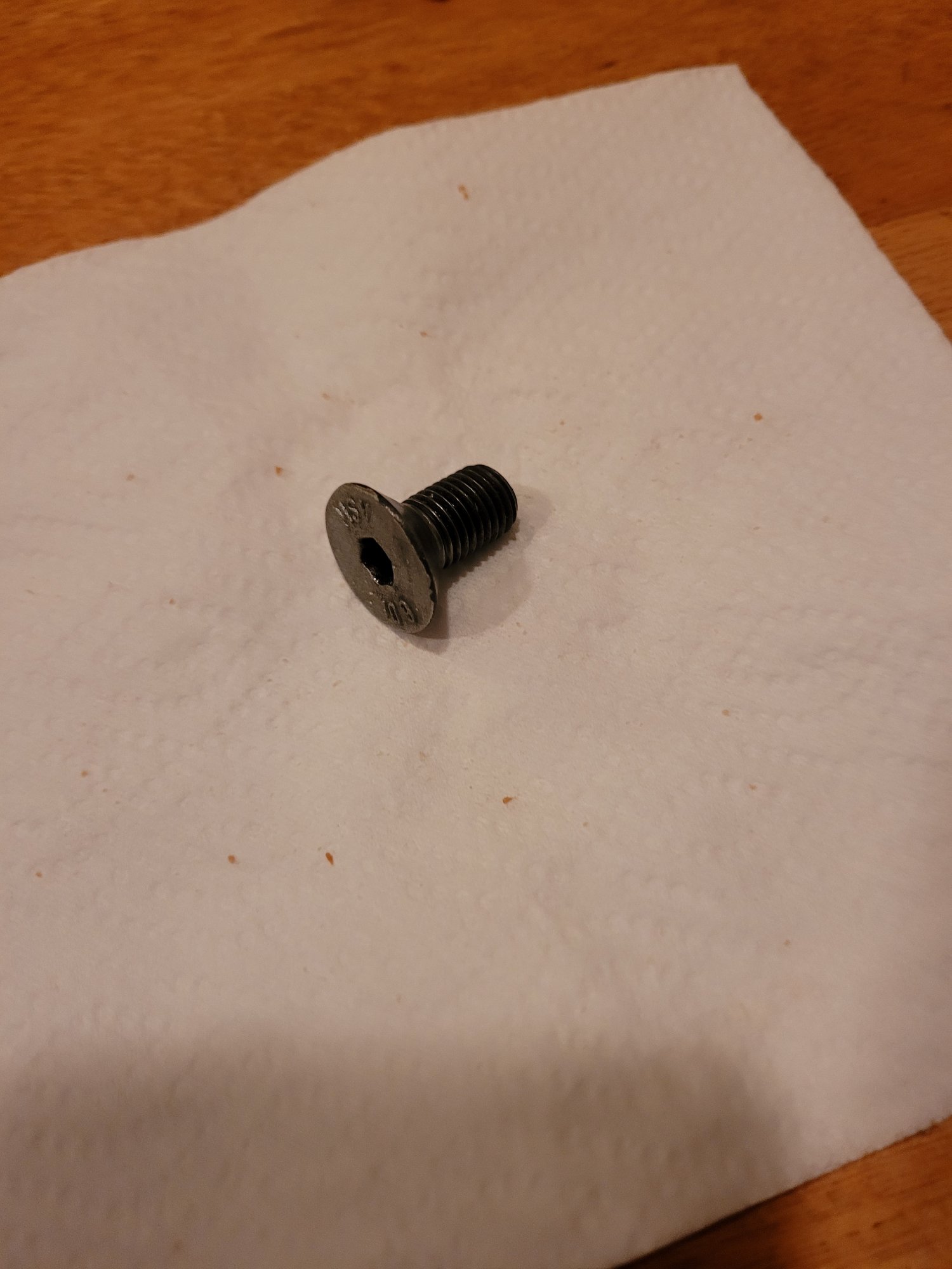

Scary. God only knows. One way to track it down would be, if you have the engine parts manual, is to search for that particular screw.
8,188
Could you post a picture of the head of the bolt where there is some lettering? If you could put a dime next to it for those of us who don't know what M10 X 1.25 means. Maybe someone will pass a clue on.

Perhaps not structural due to the counter sunk head. Looks like a bolt that would retain a part to a larger part, like the engine block. Look at things like the fuel filter, oil filter attachment, alternator, shutdown attachment, etc.

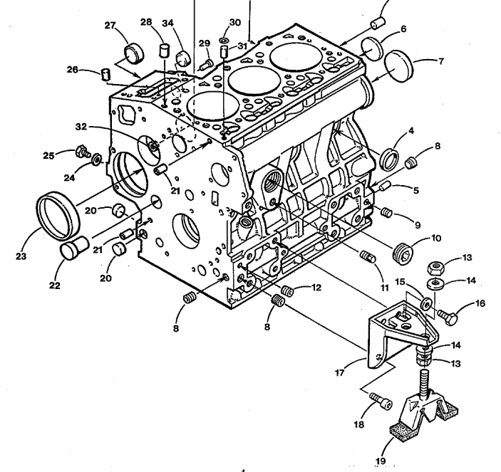

I just went through the entire M25XPG manual at https://www.westerbeke.com/parts manual/201021 parts manual m25xpb-m35b-m40b revision 2 final.pdf and I do not see that flat top socket bolt anywhere. There are plenty of M10 bolts, but they are either capscrews or regular bolts. At this point I am just going to have to get a mirror and look everywhere. A 6mm allen wrench fits it and it has the markings MSV and 10.9 on the head. FWIW I cheated and took it to Lowes and used their bolt finder to find the size.

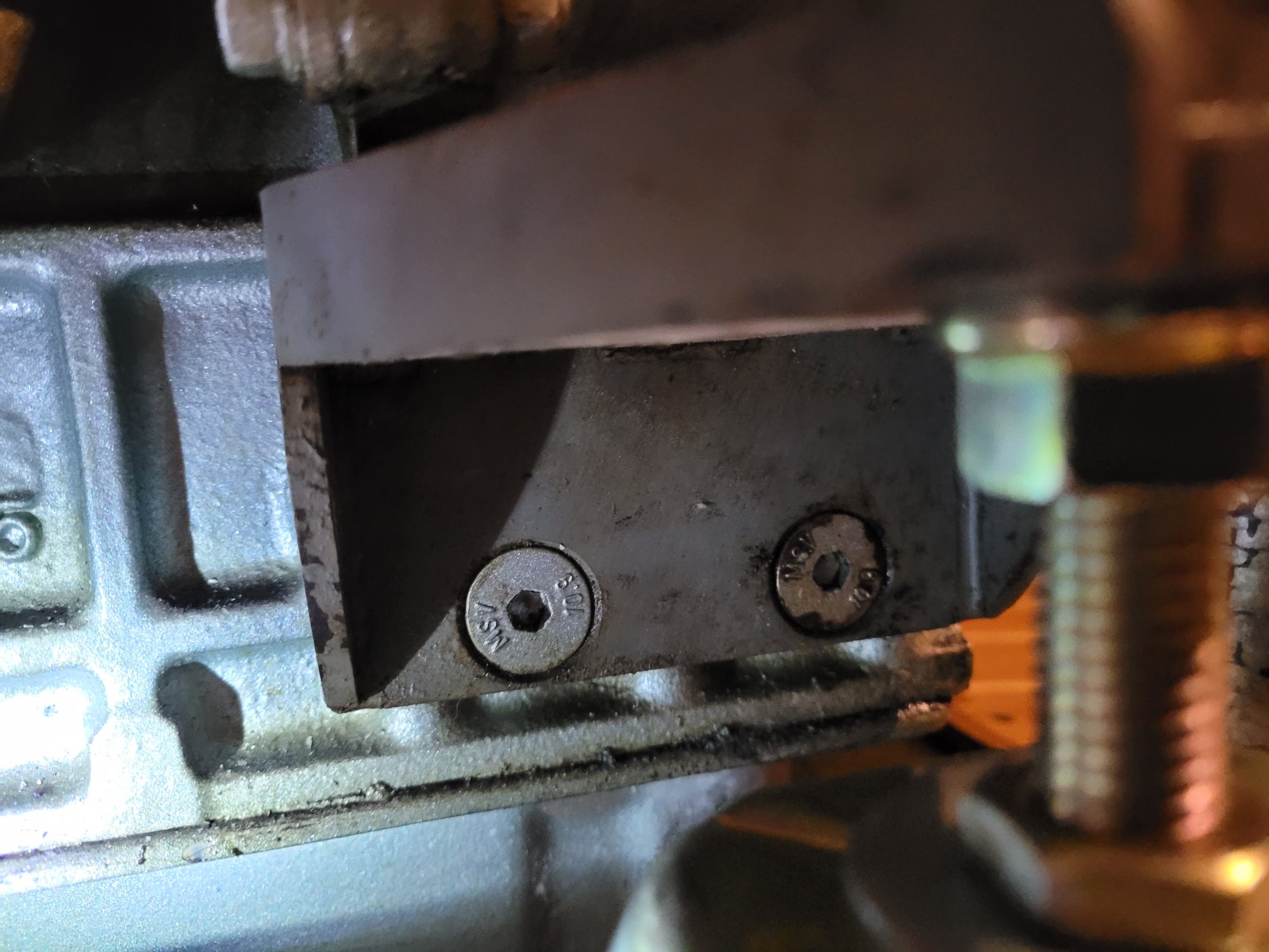

Bazinga! Joe White gets the Gold Star. Turns out it is one of two under the bracket that the port motor mount attaches to. In the part manual they show those as Cap Screws but on my engine they are flat top socket bolts. Attached is a picture on the port side as well as the page of the engine manual (tried to get a picture of the port side, but the angle was bad and the light worse); part #18 is the one.
