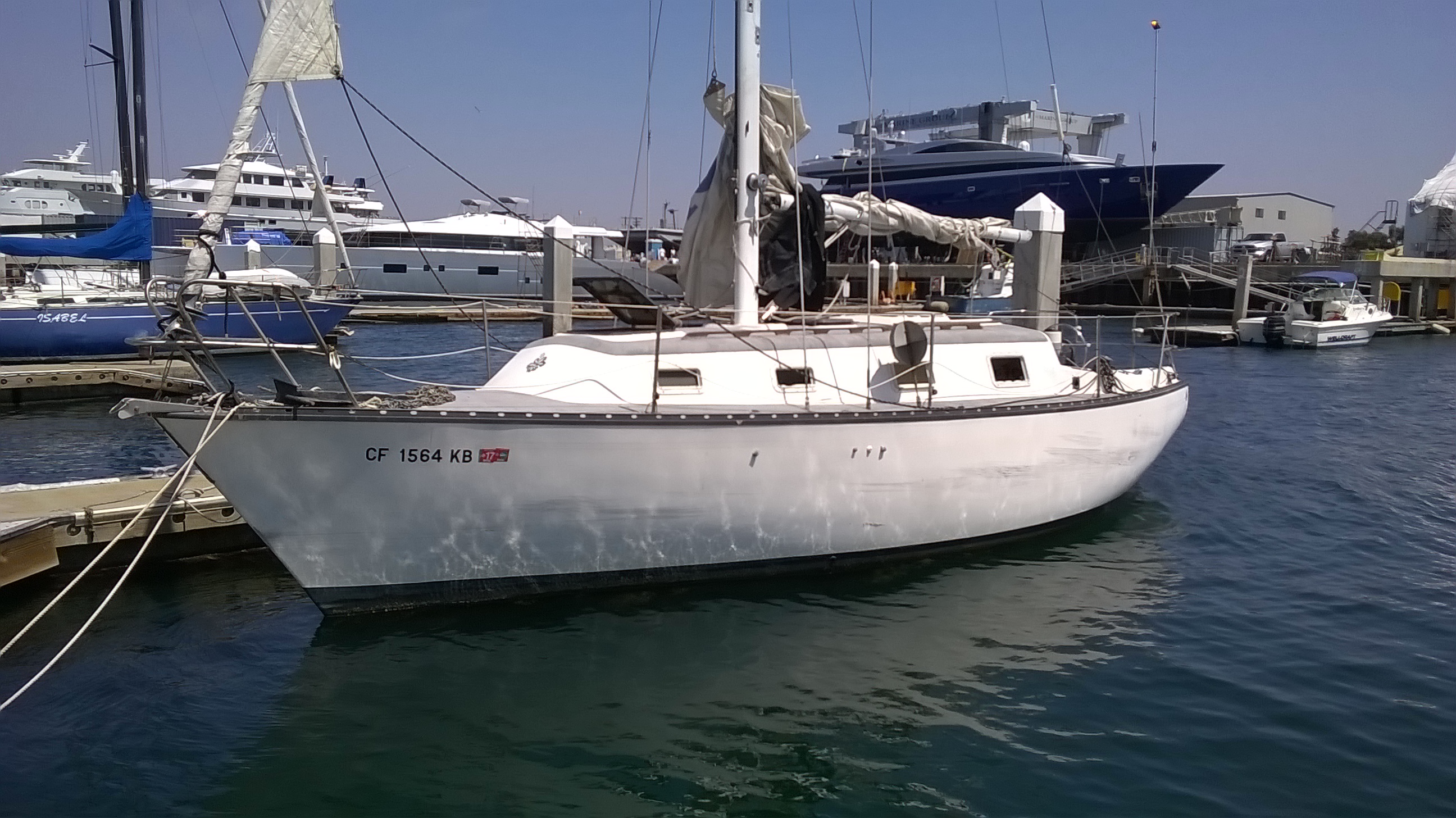

This seems like a good thread to introduce myself. I'm a new Cherubini Hunter owner (as of August), and I've been finding CRITICAL information on this site! I haven't posted anything yet, since I don't have anything to offer except questions (and so far the right searching techniques have gotten answers). Already I'm feeling overwhelmed by a big restoration project, but I'm encouraged by the camaraderie, the shared repairs and experiences (some not so positive, but that's helpful too), and pictures of others enjoying their similar boats. And I've connected with an owner of a similar boat that needed similar repairs here in my area through this forum.
By the way, I purchased a 1979 Hunter 30 that was abandoned at a marina. It needs everything from standing rigging to sewer tank (just figured out that if the sewage tank leak was 2 inches lower, or the boat had more load in the bow, it would be on the bottom of the harbor). I can't even sail due to rotten sails and buckled compression post I-beam. So I need all the repair advice I can get. I'm a mechanical engineer, but I don't have much experience with boats except for a 20' Seacraft open fisherman and Hobie 16 that I grew up with (but my dad did most of the real repairs on those). I think I was trying to return to roots or something related to a midlife crisis (last midlife crisis shown in profile pic, need to sell to finance current midlife crisis). So the input from you guys is huge!

'BlowMeAway', the pic you posted earlier in this thread is beautiful, and it's really motivating to see people out enjoying a boat that looks just like mine (but in better shape).

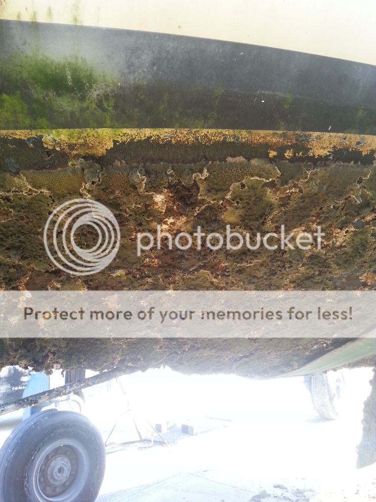

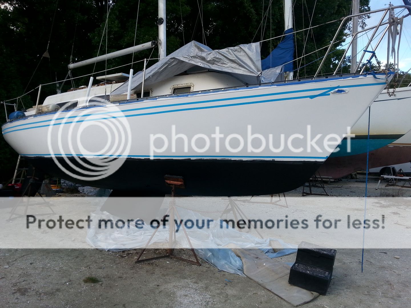

Hello all, new here. I have a Hunter 27 from 1978, and am looking forward to learning all I can here from other Hunter owners. I have a few problems, but the hull itself seems reasonable! I have a lot of work I have done on the haulout I am doing, to include a defouling, bottom paint, hull work and fairing, painting of the freeboards, and I am in the process of putting a bit of work inside too!
Before:
During (as of a few days ago, I did more today):

Ben, I don't see the forward signal lights on your bow... How odd, mine seems to have them factory installed... Of course, my boat seems to have a ton of things that are different from every other H27 I can locate too...

Sailing Fan, true, my 79 H30 doesn't have the recessed ones, it has a bow light attached to the pulpit. I googled 1978 Hunter 30, and it looks like they did have the recessed ones in 78. Must have been a cost cutting measure or something between those model years. I've read that some people remove them, maybe it's a potential leak area.

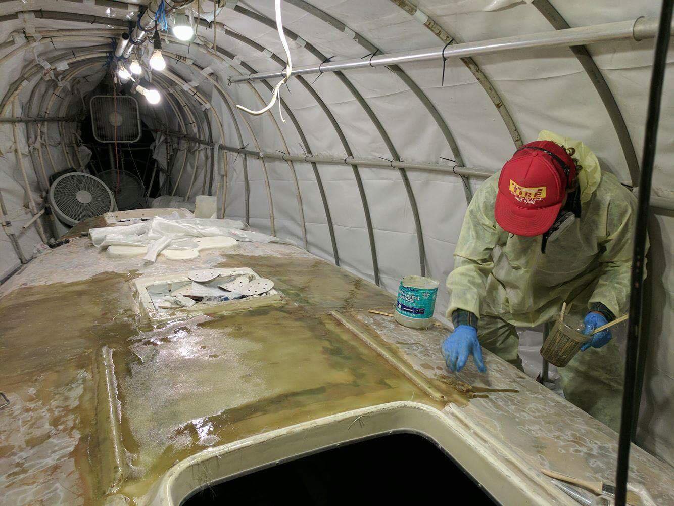

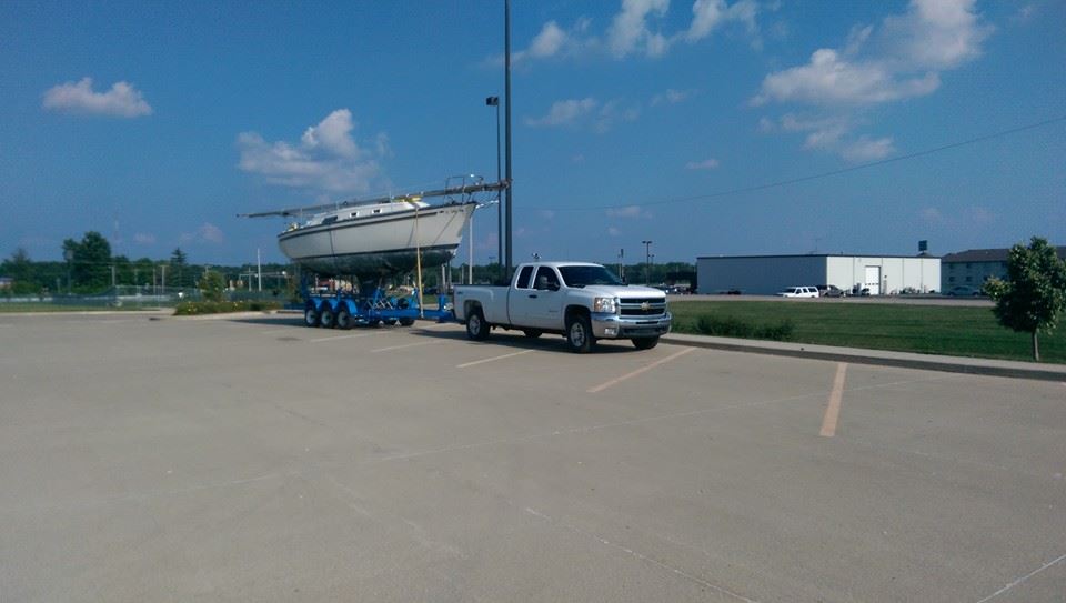

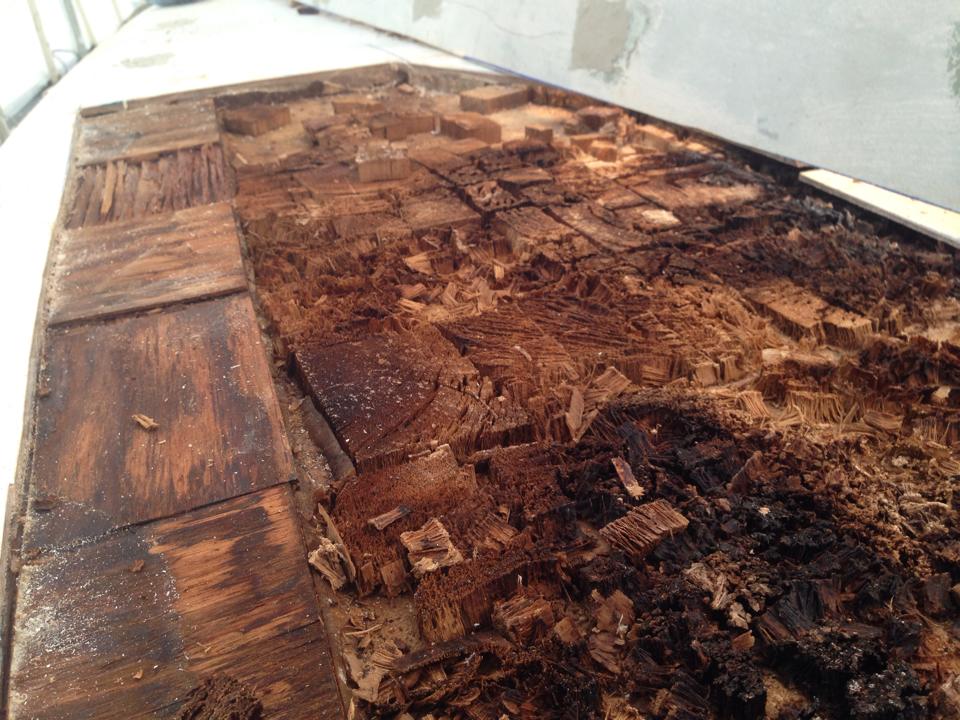

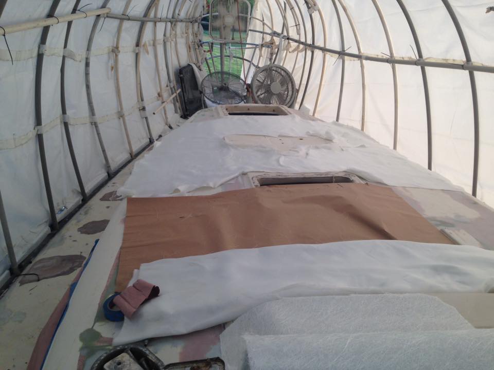

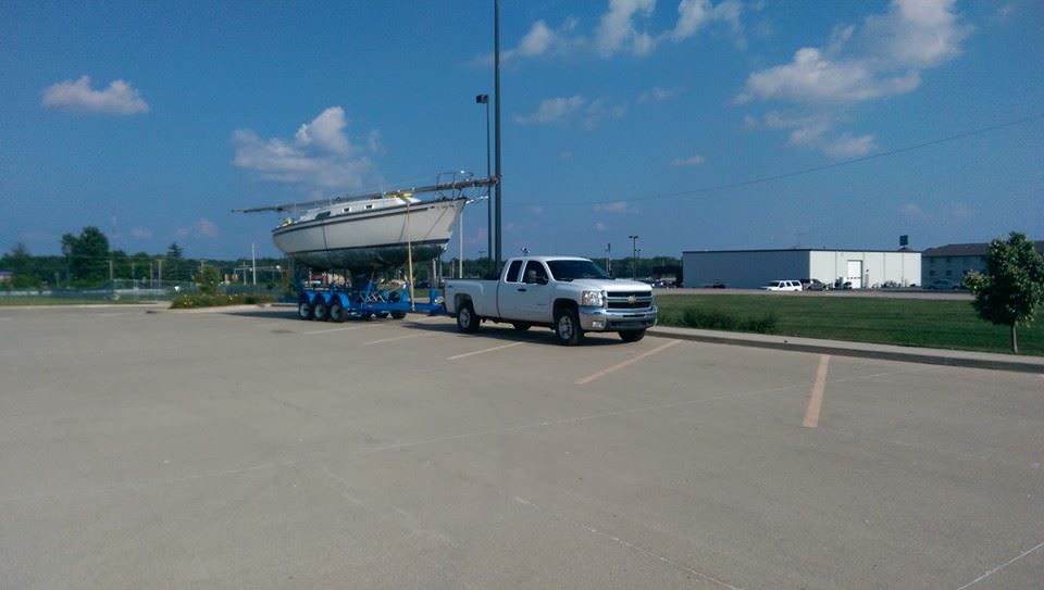

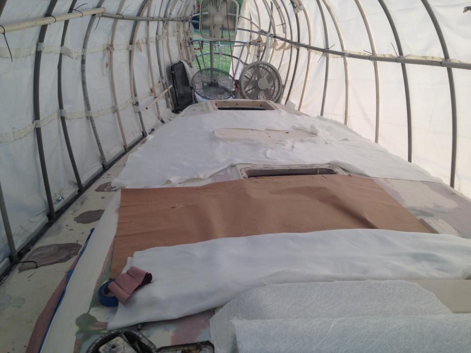

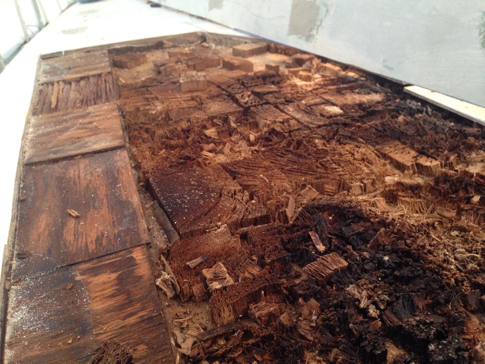

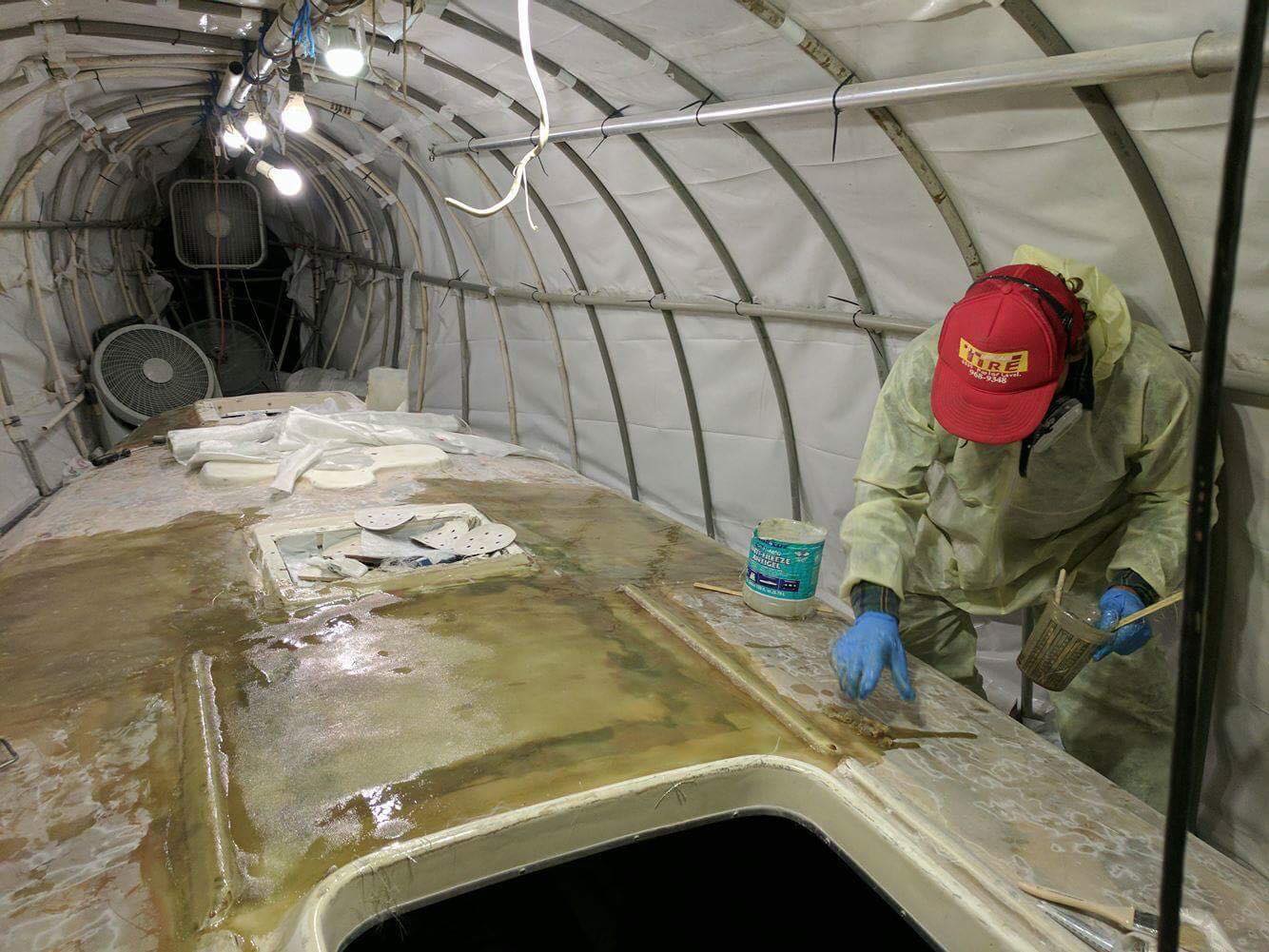

I do lurk as well. I grew up on my Fathers 80' 33, I have a 77' Hunter 30 that I'm in the process of repairing. It had a rotten core on the cabintop.The boat had been abandoned at a marina for what I guess to be 15 Years, I hope to have it in by the spring. also several of us post in the Cherubini Hunters facebook group.

Wow, Tehsailor, that looks awful with the deck rotting. How did so much water get into the wood core? Was that boat underwater at some time? I can't imagine recoring and glassing all that. You're a bigger man than most of us here. How's the rest of the boat? I think you may have drawn the biggest project boat ever...a lot of folks on this forum would be interested in your progress, and probably could help with restoration. But damn man, that's brutal what you're working with.

Every Cherubini hunter I've seen had crazing on the cabintop that's allowed some water intrusion and softspots to form over the years. Unfortunately one of the PO's had taken off the handrails so it sat with those holes exposed for I don't know how many years which completely ruined it. The only core that was fine was the plywood that was used under the handrails. I got the boat from Carlyle Illinois, Got plenty of funny looks trailering a 30 foot boat.
The boat was listed as PARTS ONLY. which I hate to see a good boat be parted out/cut up. Besides the cabintop core being mulch the boat was also on it's cradle improperly and for way to long (and aparently with water inside) Thankfully it didn't get into the engine compartment (it still turns over!)
So the stern of the boat had oil canned in, putting it on a proper trailer it's popped back into place for the most part. the wonders of fiberglass. (it did break the tabbing on the aft berth though) The Teak flooring is ruined and the compression post and Steel I beam were just gone. Those have been replaced and the majority of the hard work has been completed. My father and I are just prepping the topsides to be repainted (I'm going to be using Perfection, and TuffCoat for nonskid)
Projects boats are a labor of love, and when you're in/fresh out of college you have more time than money so in my case it worked out. It's also helped immensely that my father is in the boat repair business and done a similar repair on his own. Just not nearly as extensive.
One pro to the boat was that someone had recently installed the new style Lewmar hatches so I'm really happy about that. I was also able to find and source replacement dome lights for the interior at $9 dollars for the singles and $15 for the doubles. I really can't wait to see it finished and in the water.

Nice, you've got that winning attitude. I sense success coming your way. Best of luck and keep us posted with progress pics and questions as they arise. We are here to help...at least verbally. When you're done it'll probably look better than my ole girl above.
