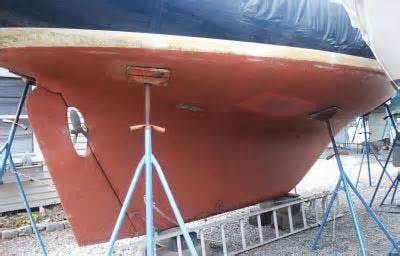

Benny: Thanks. Makes good sense. I don't know why the "tutorials" generally include something like "1 drip per minute at the dock and 5 drops per minute while the engine is running" when in fact the owner has no real way of observing ... unless he/she might have full keel older design boat that has the engine way down below the waterline and the shaft exits horizontally like below.
In the absence of any other info, I guess that your suggestion might have been my default course of action.
