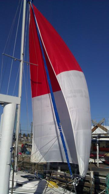

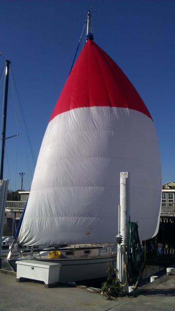

I know I am not a skilled sailor yet, but I got this goodlooking snuffer spinaker which my friend tried on his boar ( a Pearson 32, I think)
Can it be used on my boat? It looks pretty easy to operate, and of course, would only use on light winds
But I like the idea you don't need a dozen people scrambling like demons on deck gathering the folds of the sail!
It folds neatly on it's sheath
Any coments?
Anyone has used any of these?
The picture was taken of his boat, with my spinaker

Spinnakers with snuffers are awesome. However, yours does not look like an asymmetrical which means you will need to fly it from a pole. This kite should work on your boat.

It's a little hard to tell from the pictures, but if by snuffer spin you mean it rolls up on the luff (front), then it should be able to fly without a pole. Take it out on a light day and experiment. Should be fun.

I think by snuffer he means the sock. I think I can see one compressed at the top of the first photo. The reason I don't think it is asymmetrical is because the clew is usually a fair bit higher than the tack. Witness Charisma's avatar. One could readily know by measuring the two leeches. If they are the same, you need a pole.

Good luck with that Jorge. There is some confusion because you titled your post "Snuffer Spinnaker" but you do not show any pictures of the snuffer(sock). We think we see it at the top of the first picture. You can see how it works over on this site:
http://atninc.com/sleeve_en.php .
The guys are also saying that the sail or "kite" looks like a real spinnaker. This is a sail that requires a lot of expensive hardware to fly correctly. In your pictures it is attached, perhaps incorrectly, as an asymmetrical chute. Here is one good description of both: http://en.wikipedia.org/wiki/Spinnaker . Asymmetricals have many names like cruising spinnaker, drifter, and gennaker. Not sure there is any difference, they all look the same to me. Those "chutes" have the tack corner of the sail attached to the boat, not a pole like the real spinnaker. I attach my drifter to the bow roller ahead of the forestay. Then the clew on my drifter has just one sheet. That sheet goes to a block on the very aft end of the toerail. Then forward to the winch. If I have to jibe I take the sail AND the sheet around in front of the forestay and down the opposite side. Since the drifter is only used on long runs off the wind it is unusual to jibe.

Jorge asked me explain how I put up his A-kite. It is indeed an asymmetrical spinnaker made of ~1/2oz. material with a sock/snuffer. It probable looks a bit odd it the pictures as I jury rigged the tack line. The tack was tied to the bow pulpit (will need to go to a proper block and cleat) and the clew was though a block at the stern to a winch. I also didn’t raise the halyard as high as I could. I was a bit concerned that the spin halyard would get stuck in the sheave on the mast. I don’t see any reason this sail wouldn’t work on Desiree. I think the luff is a little on the short side for a H33, which may be a good thing. For reference my I is 40.4 and the J is 13.4. I don’t know the dimensions of the H33.

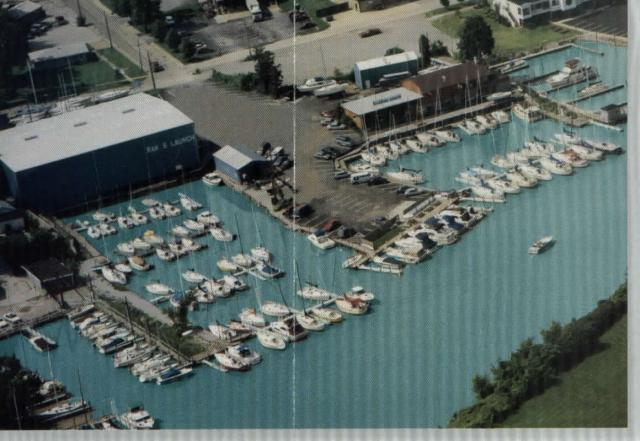

I'll admit that I am always hoping to find someone on the docks when I come in. But that is the rare case. It was especially dicey in Florida where I had just the four corner pilings, same in North Carolina. Much easier on Lake Erie with a full length dock on starboard. Port side would be better because of prop walk but never had that option. My turn is wide because the dock is on the river(picture). I have river traffic, current, wind, and the other boat on the port dock to deal with. So yes, slow is important. I use just enough reverse to not pull the stern away from the dock. I have a long spring line that I catch on the second post. That stops the boat and pulls the stern in. Jump off with the stern line in hand and grab the shrouds to keep her square. Quick temporary stern to post tie and then forward to grab the bow. I have the bow line laying over the pulpit so I can do a quick bow tie. Finally I do the docklines to their respective dock cleats and then the spring lines.
