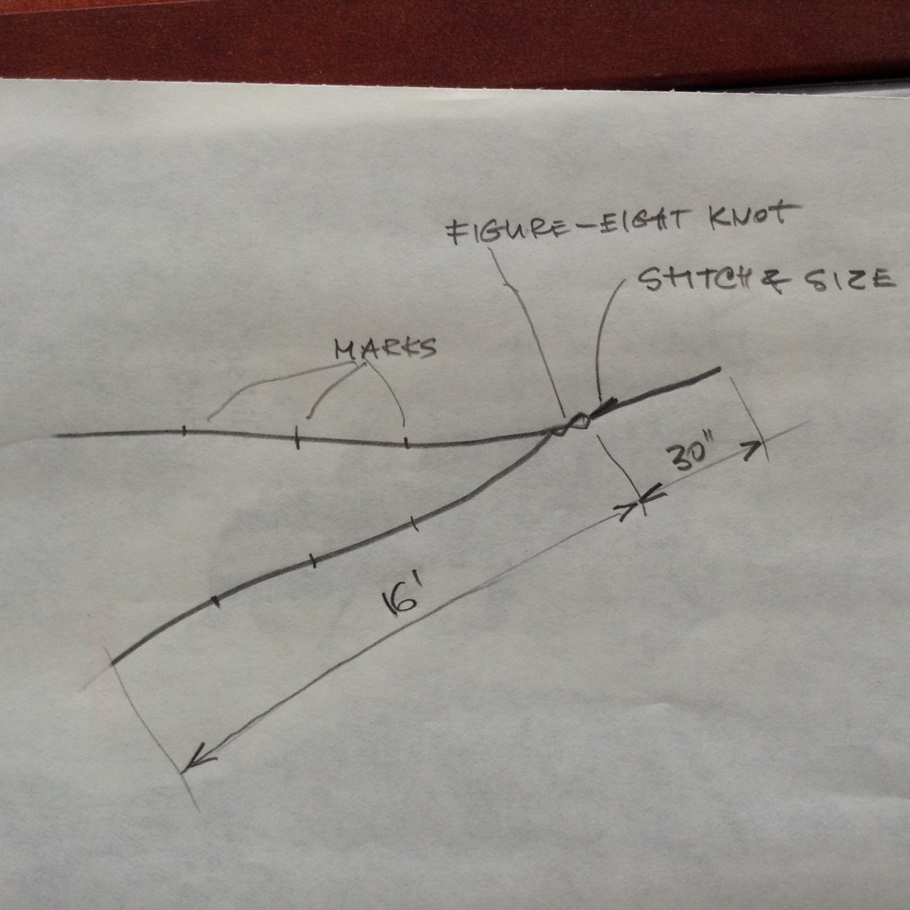

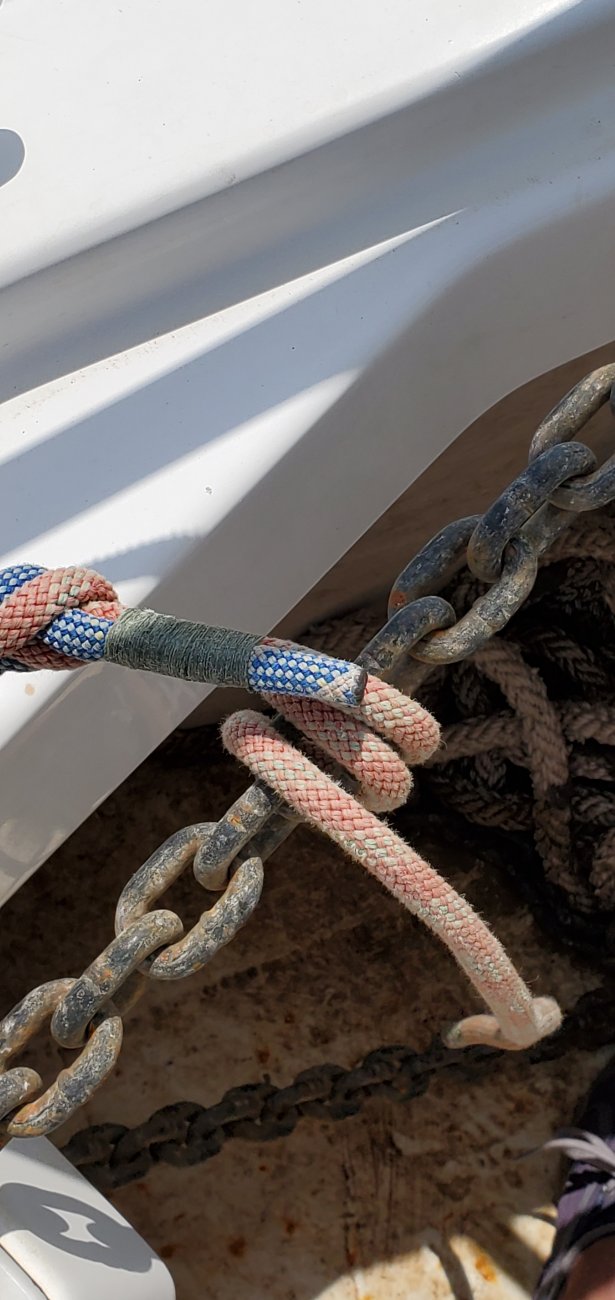

Years ago, with all chain rod in my offshore cruising boat, I used single snubber with chain hook going over bow roller. However in bad weather the snubber was few times damaged by chain in the roller and often difficult to detach hook from the chain. I switched to bridle attached to both fwd cleats and used rolling hitch on chain.
My present boat has 95 ft of chain and 8 plait nylon rode. I use bridle snubber made of old 9mm climbing rope attached to chain or nylon rope with camel hitch (very similar to rolling hitch, takes load in two directions, better grip on smooth rope). This arrangement never faild, it is easy to recover over bow roller and it takes seconds to untie after being exposed to significant, fluctuating loads.
Have approx 16' long bridle joined with figure-eight knot and 30" tail for camel hitch. Marks on the bridle allow quick symmetrical deployment. See sketch. Pics show beginning of camel hitch.
