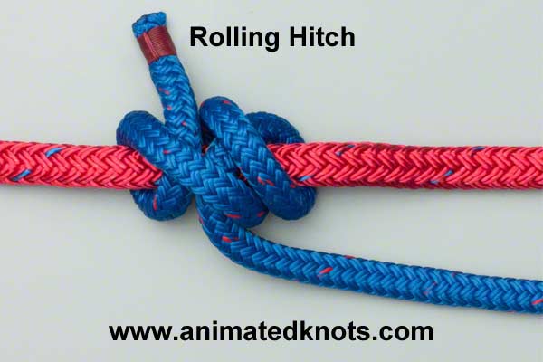

Marian and gunni, I was wondering about that handy hitch, but was concerned it loosening. Do ya'll ride storms with it? Thunderstorms type stuff.
Yes, a property of the rolling hitch is that it tightens the locking loop as it loads up. It works particularly well on chain where there are narrow "shoulders" for it it lock down into.
Thunderstorms can be scary. We rode out a storm with 55 knot winds and the snubber worked well. Of course, we had an 8 to 1 scope and the snubber was stretched to the point the chain was tight also.

...a property of the rolling hitch is that it tightens the locking loop as it loads up. It works particularly well on chain where there are narrow "shoulders" for it it lock down into....
I saw a magazine article for those who tie their snubber onto the chain. About 18 inches from the chain end of a three-strand snubber, seized/whip the line. Unlay the three strands and fan them out flat. Weave them by taking the right one, cross it over the middle one. Take the left one, lay it over the new middle one. Take the new right one over the middle, the left over the middle and so on. Whip/seize the end. This gives the line more surface contact with the chain using whatever your favorite hitch is.
