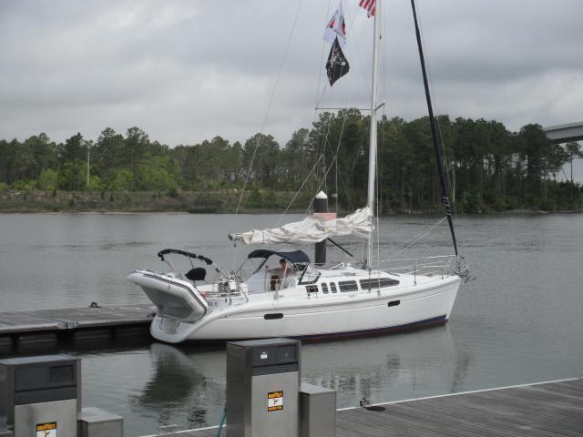

I just do this. My only problem is that the dinghy blocks the stern light, so I try to not sail like this after dark.

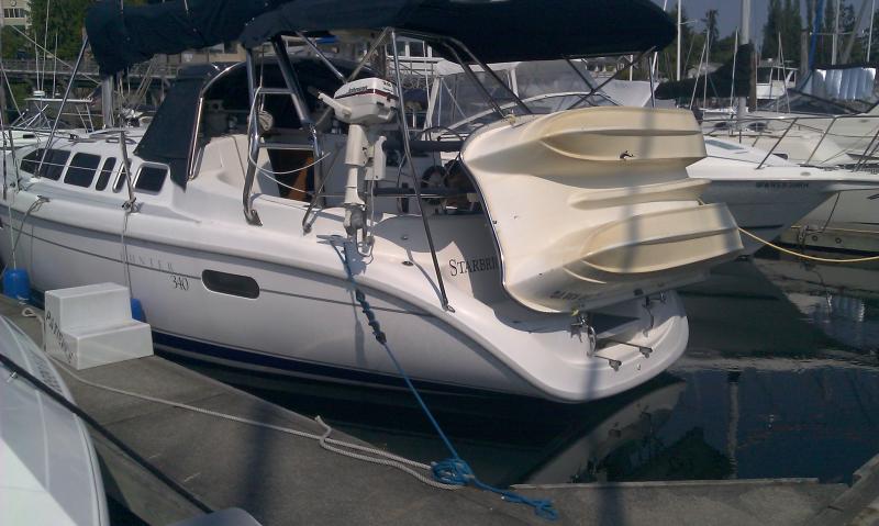

If 'snap' davits are the same as 'weaver'...
then here is a picture of my recent installation for my hard dinghy on our 340...
I mounted the right angle version of the loops high on the aft face of the rear lockers, just below the locker lids, in order to raise the dinghy as far off the water as possible so that the corners of the dink would not hit when heeled.
Almost all of the time, we tow the dinghy, but I installed these davits for those occasions where rough water necessitated it being out of the water. Water that is rougher yet would call for hoisting the dink to the foredeck.

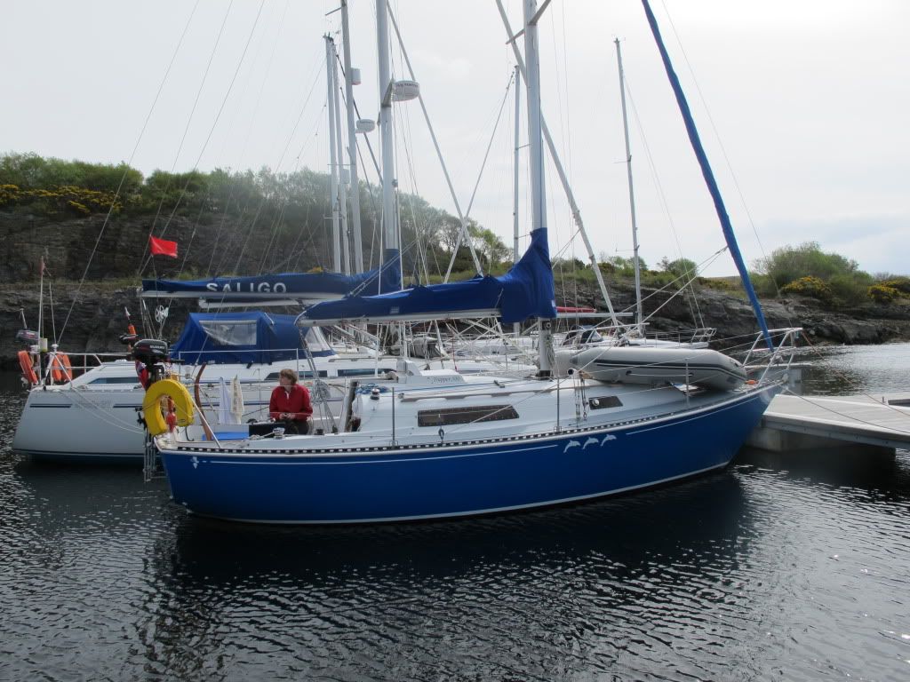

Here is a gratuitous shot of our old boat in the marina. Ten points to anyone who can name the model of boat......
