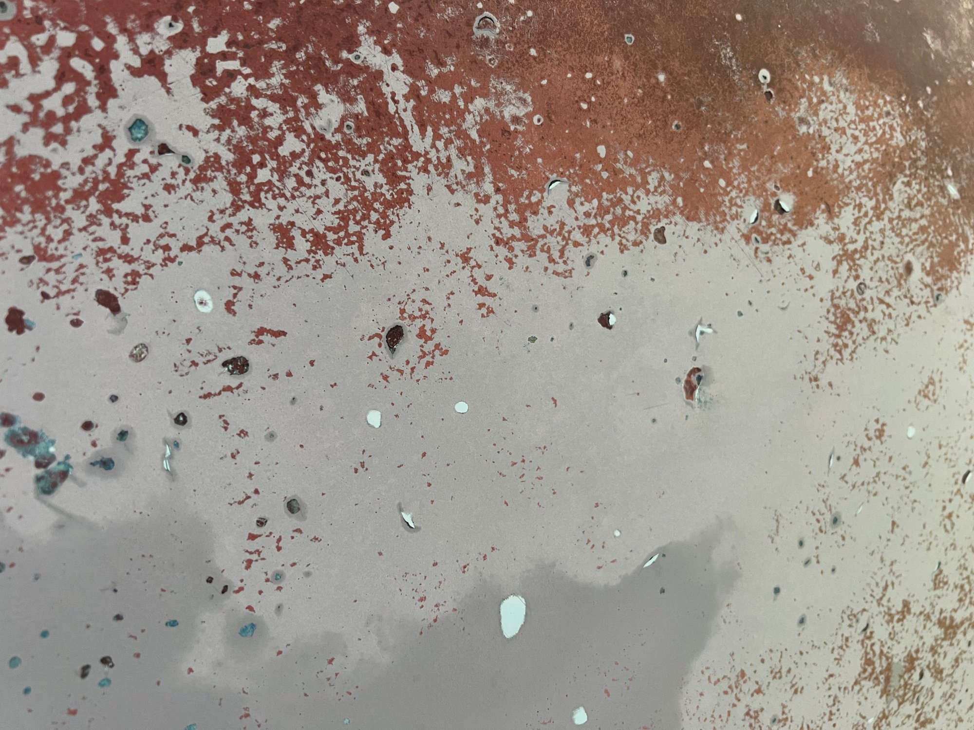

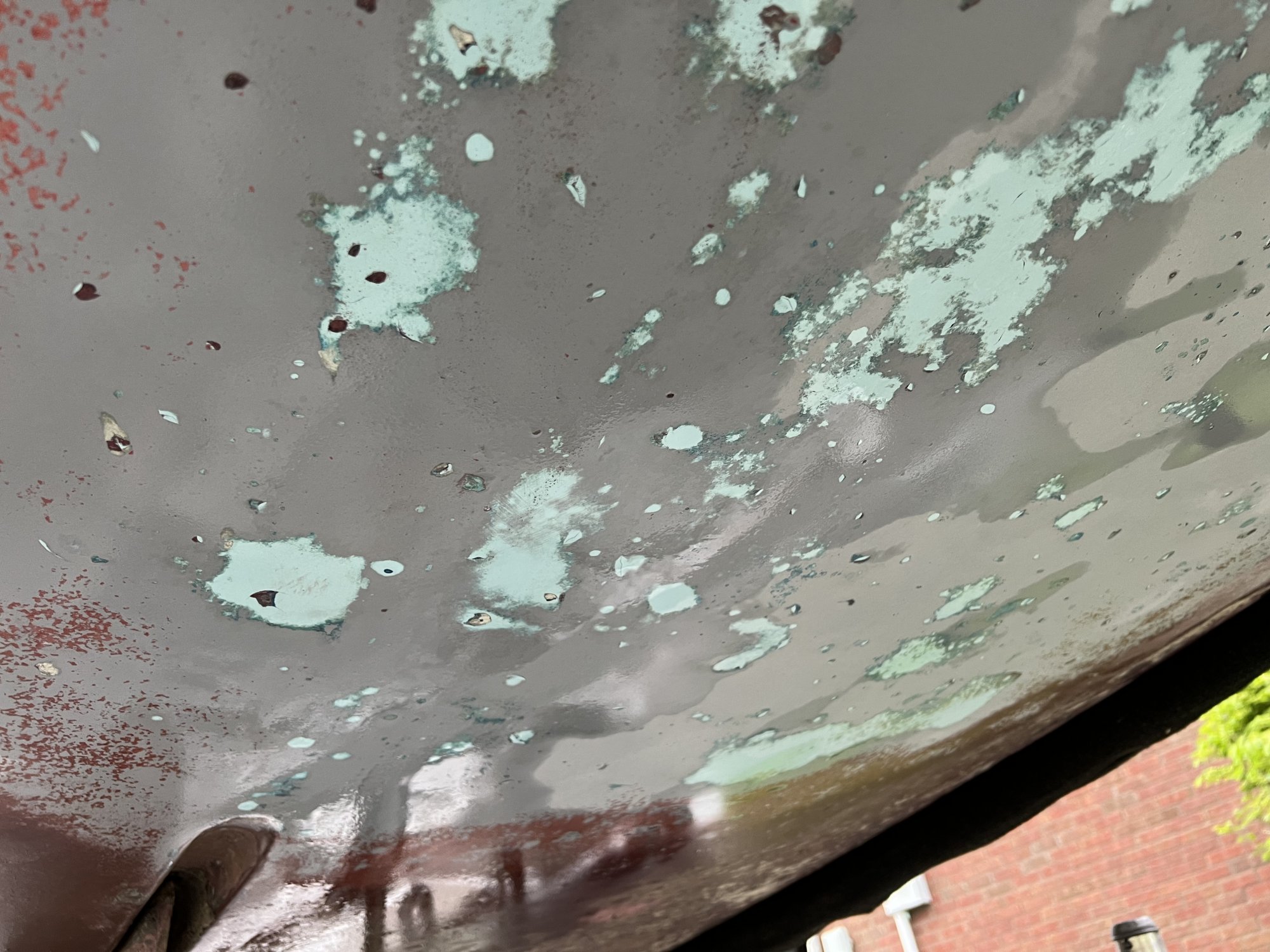

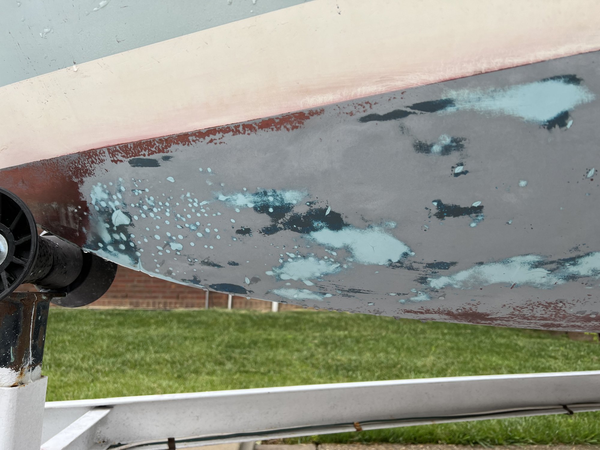

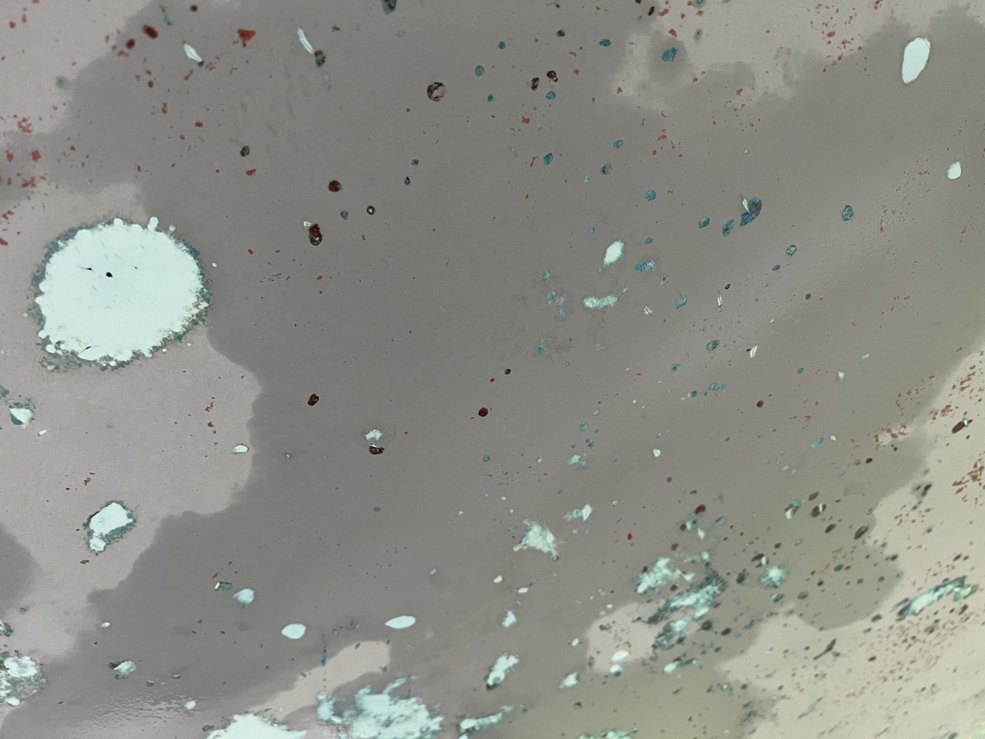

Need some advice. My cat 22 has vc17 on the bottom and seems to have many layers of paint, it is also flaking/pitting in places. I’ve been sanding for hours with wet 60 grit paper which is very slow going, acetone didn’t seem to do much other than smear it. I see gel coat in places and what I assume is a primer - I’m hoping I’m not setting myself up for failure sanding so much but the vc17 was applied over pits and cracks. Had been told I need to completely sand every spec of copper off which in some cases is taking it down into get coat because of the pits. Does that sound right? After that should I go back over with something like 220 grit?
The local shop said to use marine-Tex to fill the cracks followed by primer inter protect 2001e followed by Micron CF. I’m not sure of this advice because the guy was really confused by the word keel… shouldn’t I be able to use gel coat to just smooth the bottom pits? I’m not sure on the other products he mentioned.

I’m not sure why anyone would put VC17 on a 22‘ Catboat. It’s usually used on slick bottom high performance racing boats.
I would keep sanding till you get all the loose stuff off, then re-coat with a compatible ablative bottom paint. I wouldn’t be concerned with having a perfectly smooth bottom. The main objective of bottom paint is to protect from excessive growth during the season.
23,649
Caution as you proceed. You do not want to burn through the gel coat into the glass. Looks like a foormwe owner may have tried to use filler to smooth out the bottom (the light blue) and perhaps tried to address some blisters. Epoxy fairing compound is used to level the highs and lows of your bottom once you have removed all the flaking. Once smooth (you may find a "Long Board" helpful. If is a 3ft or so long flat holder of sand paper, and will help you even out the surface) then a coat or 2 of barrier paint. If you are leaving the boat in the water for the summer, a good ablative would be good. If you are trailering the boat and it is dry during the week, then a hard coat which does not loose it's effectiveness when exposed to air for extended periods would be a better choice.

You will have some work in front of you to get the flaking VC17 off. Unfortunately if it’s flaking that (or having it media blasted) is about all you can do. If you want to continue using VC17 you can leave the well adhered and smoother sections alone. If you want to switch to another paint you will probably have to take it all off, as not much sticks to VC17. No need to sand with 220 after all that - most bottom paints and primers want the substrate sanded with 80 grit to get a good surface to stick to. Any kind of epoxy fairing compound would be good for filling and fairing. Gelcoat is not good for building up a surface - it’s not meant to be that thick, and will be brittle if laid on too heavy. It also isn’t as waterproof as epoxy. After that you’ll want a primer of epoxy barrier coat and the bottom paint.

If that was my Catalina 22, I'd get it down to bare gelcoat, fill any holes, put on an Interlux barrier coat(s), and top it off with a layer of VC17. The really dreadful part would be dealing with the swing keel, which should receive the same treatment. Ugh. Of course, this would depend on whether I intended to keep the boat. If I planned on selling it in the next couple years, I wouldn't bother. Lotta work.
Thanks Siamese, I think given the benefits I will put vc17 back on. Removing the old layers will allow me to fix some pitting and flaking and smooth-things out. I’m wondering if it really requires going all the way down to gelcoat or if I can lay that Interlux epoxy primer over the existing. These technical data sheets for chemicals are a beast to interpret.
May 17, 2004
5,830
I doubt you’ll get good adhesion putting Interlux over the VC17. I’d clean the flaky areas to gelcoat, fair, and prime just those spots. Then VC17 over everything.

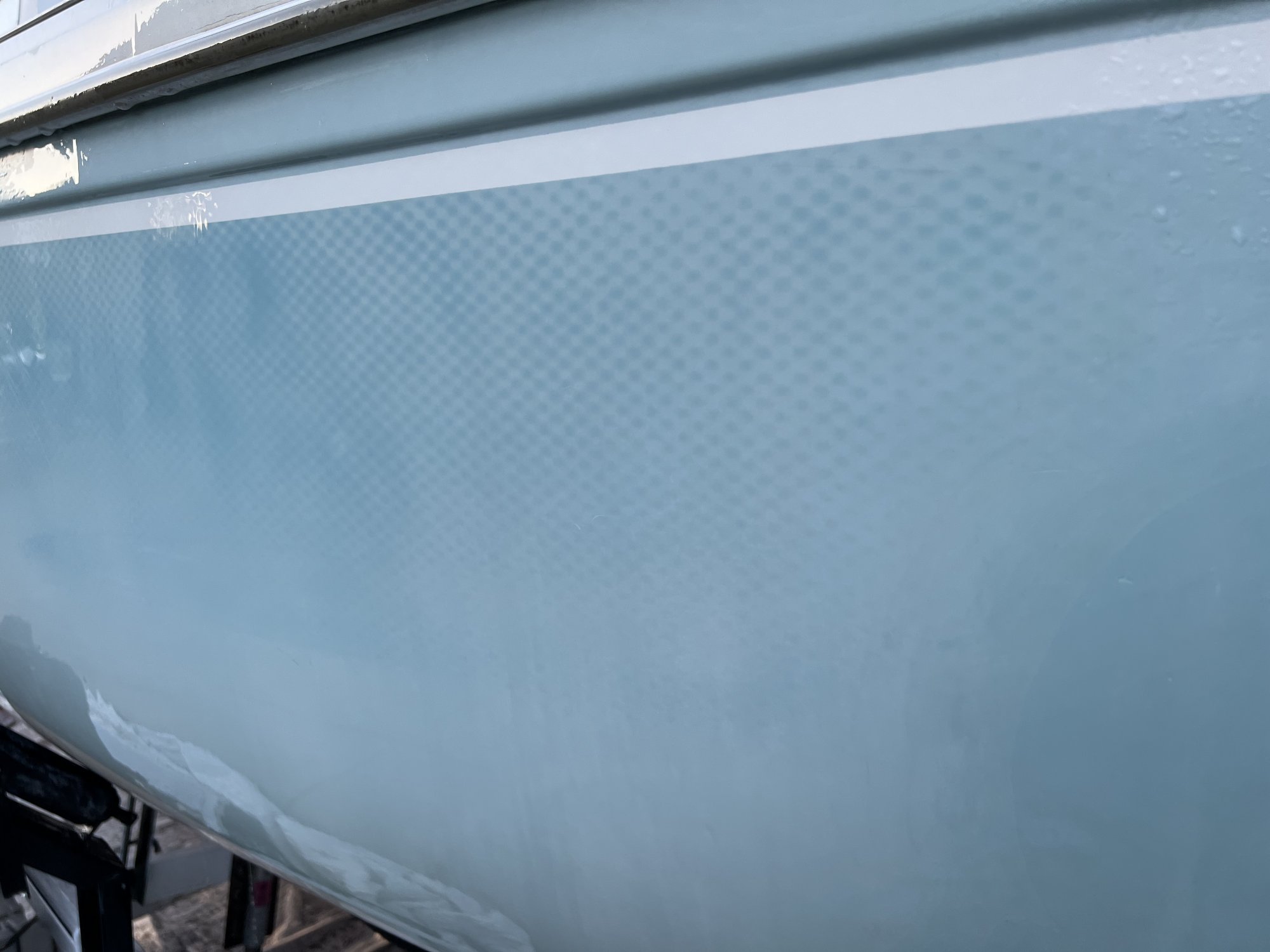

Instead of me making a new thread, I can’t seem to find any similar post related to a pattern that is showing up in my gelcoat with some sanding. The boat is heavily oxidized and when using a block of sand paper a nice blue color comes out eventually, but when I used the orbital sander or my DA I’m seeing the cross stitch pattern of fiberglass show up. My question is this serious and should I stop sanding or keep going to try and restore the color? I started with the least harsh polish/ sanding but until I got to 600 grit nothing was changing. My guess is that the cross stitch pattern absorbed the color and kept it dark in places but I can’t tell if I’m removing too much, or of that pattern is close to the surface or not.
23,649
TOO MUCH. The gelcoat is gone when you see the fiberglass underneath. :banghead:
Solution would be to try and cover with gelcoat, then sand smooth...
Or paint.

You sanded through your gel coat. I'm not an expert in applying gel coat. So can't give you advice on reapplying. I would put an epoxy based barrier coat on however you decide to move forward.
