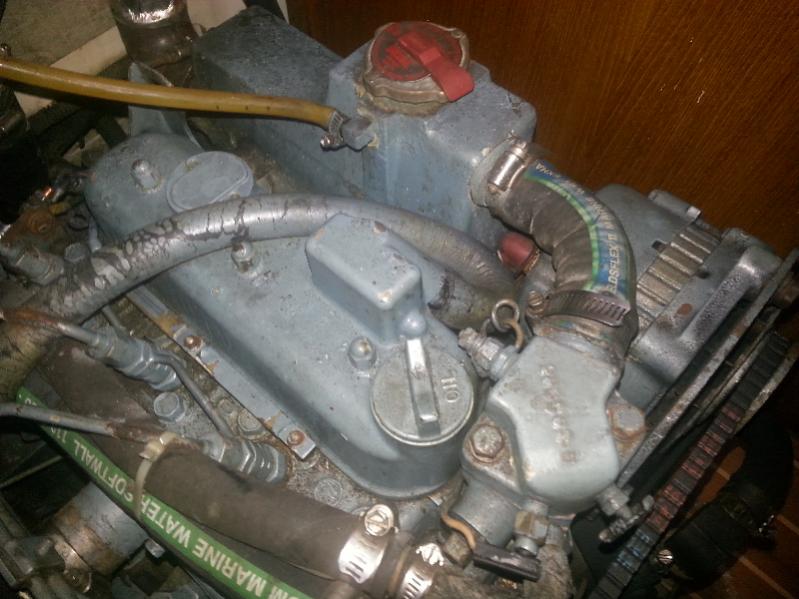

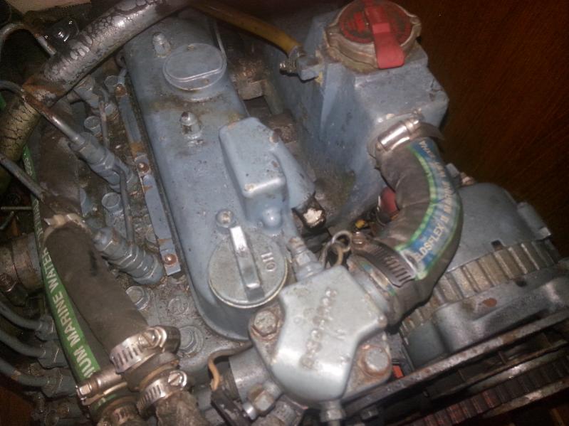

Is it like a positive crankcase ventilation valve...may be failed?
Looks like a valve in that rectangular housing on top of the crankcase cover.
How does one remove that valve?
Presume I have to remove crankcase cover. Probably has a gasket that would need replaced? Source for gasket?

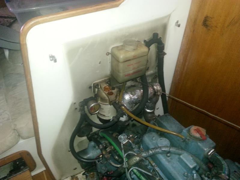

Pictures attached of hose, valve and black soot all over white wall on back of engine compartment.

I think you have two possibilities. First the clogged or restricted exhaust. Check the elbow. Do you see water coming out at the stern?
Second, something looks off on your belt. Are you sure what you are seeing is soot and not belt wear. My belt was rubbing on the water pump fitting and I got a similar soot look to the engine compartment.
